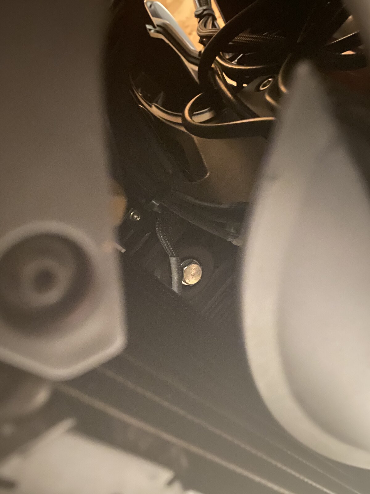

  3. I think it’s this you need to adjust. 12 or 13mm it looks like but you need to remove some of the plastics. Can’t recall how much. 5696DDDD-73B0-4A97-AEC8-8024CF556C6B.jpeg
  4. IIRC its a 13mm in the centre of the bike , a socket and long extensions will do it without removing anything but easier if you take off the black plastic bit under the headlight assembly. Lots of turns only moved it a small amount.
