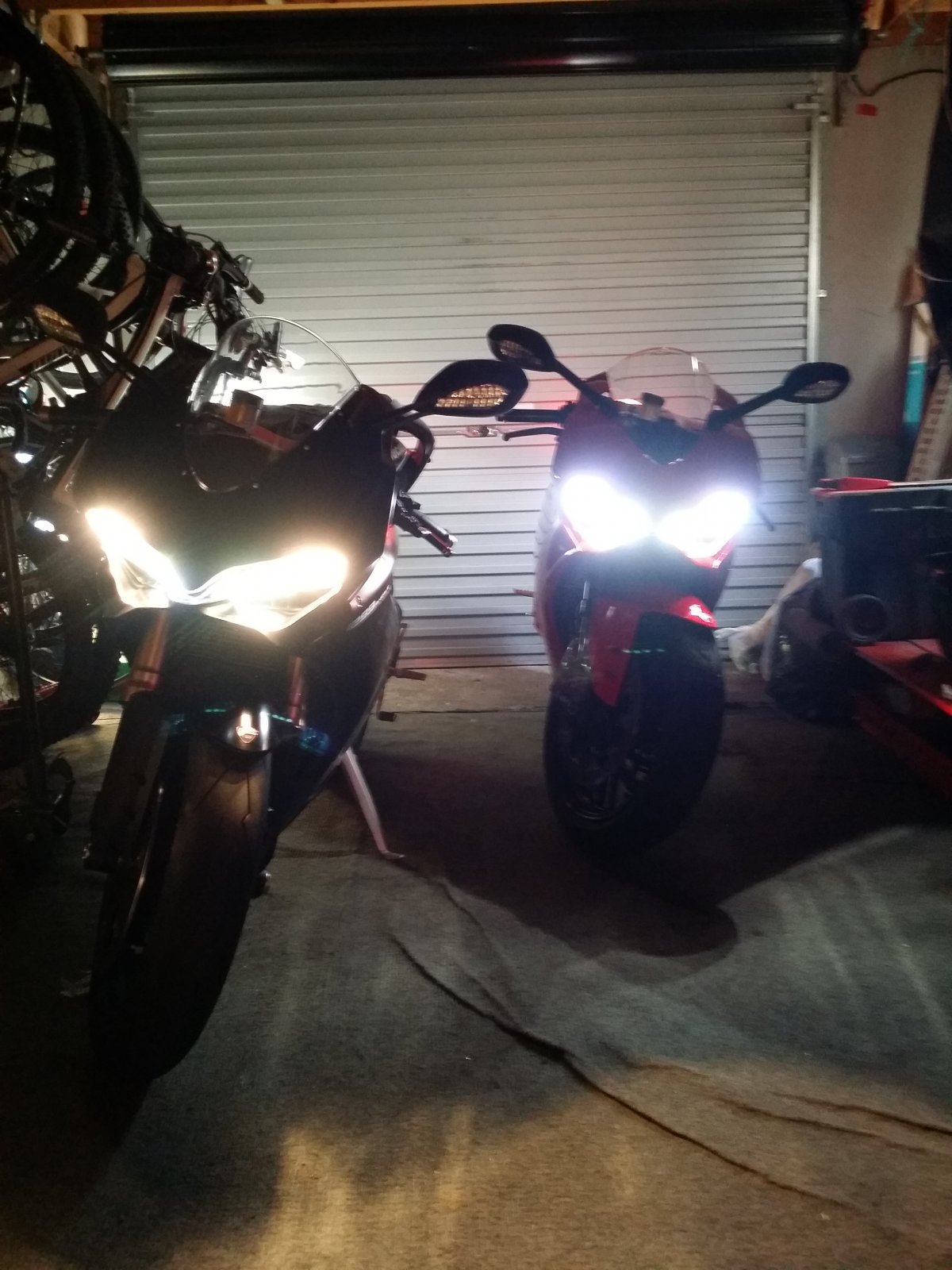

Just Put some Philips diamond vision 5000k in both 899 and 1299 and very hapy with the results. The light colour is just about exactly the same as the led running lights In the picture the bike (as you look at it) on the right has the diamond vision on dipped beam the bike on the left original bulbs on dipped beam :thumbsup:

According to the search that I just did, these bulbs are not road legal in the UK or EU. Also, although the colour is whiter and the colour temp is higher, the rated light output in lumens is no higher than ordinary bulbs. I use Philips Extreme Vision in the monster. The light is still not the best in the world by a long stretch but it is a significant improvement over the original bulb. Personally, I find a yellower light is more user friendly than superwhite/blue-tint lights as its less dazzling when it reflects off road signs etc. Also, I get dazzled by other peoples blue/white lights. Even Philips themselves advertise the Diamond bulbs as a cosmetic upgrade rather than an increase in performance.

Not sure if the legal people specify a colour temperature, but 3600k is a little yellow, between 4000k and 5000k is more like white daylight, anything above starts turning blue.
