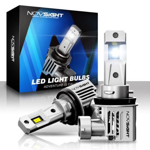

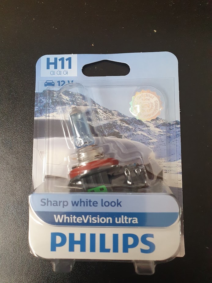

  3. I found and fitted a pair of these. Give a nice White light and a marked improvement on the OEM bulbs

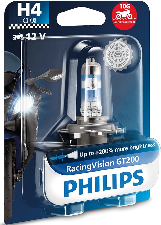

  4. I've got this:
    Much brighter, much whiter, exactly the same pattern as a standard H4. Do check your wiring and connectors though, as they do pull more current and will find any weakness! I'm wondering whether to fit a relay behind the headlamp to take the load off the switch...
  5. I have these LEDs fitted to my Supersport and , despite what Bob T says above, they do provide a very good pattern with a sharp dip cut off. I have had poor results with LEDs into past but these are good with a very bright, very white light.
    https://www.ebay.co.uk/itm/204426445380
    I also managed to squeeze this H4 LED into my Scrambler and the result is far, far better than the halogen OEM.
