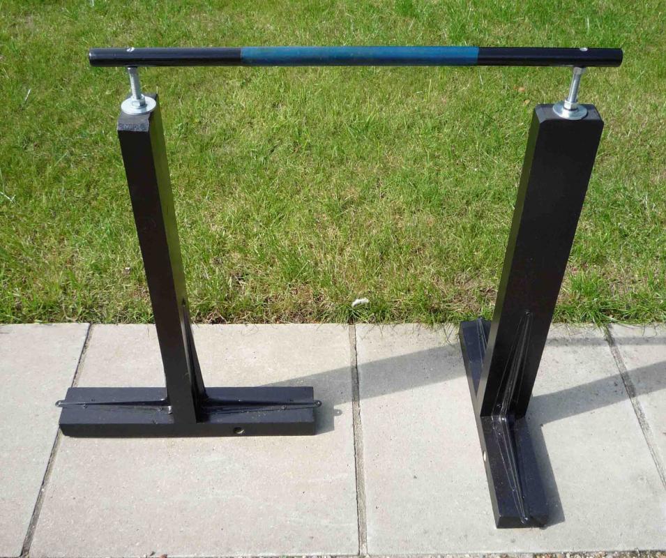

  7. If you have the gap needed between the airbox, frame and headstock, you can make your own stand for about £10 and you can do everything....
    Here's my front one.....
