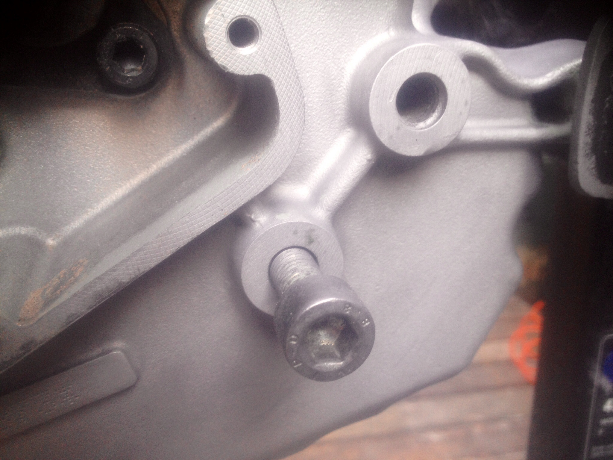

  6. I've painstakingly stripped all the paint, flakey and good down to bare metal, which as it is now looks lovely.. I've been struggling to find the correct silver.. Even RS couldn't match
    It... I've added a pic of a tracker with the bright silver sump etc.. It's not easy to see from View attachment 32802 picture.. I even wrote to this guy and asked what the colour was, no reply ! image.jpg
    Basically need to do sump, heads and barrels..
  7. So it is not very high temperature apart from around the exhaust area. If it totally has to match in situ then it will be difficult. What bike is it on? most (all!) genuine Ducati engine paint is now water based and this is why it flakes, but having said that, a lot of solvent based paints actually are not as good for heat but do stand more up to poor\abrasive conditions. I feel you can only go, given what is available at a realistic price, with what is on the market. If you are very serious get it stripped and matched in a high temperature powder coat, or go with a ceramic coat.
