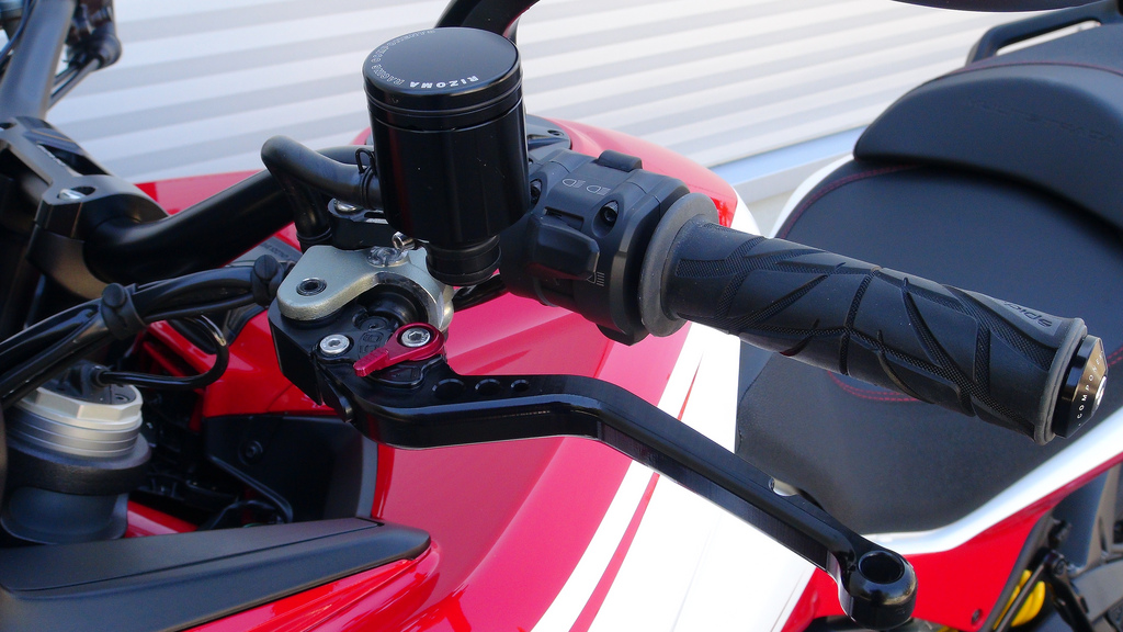

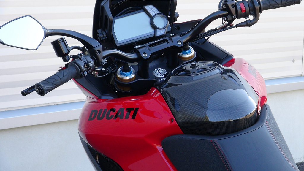

  14. I have 3 seasons Spider Grips.
    For me, the best!
    My friend has the Ducati heated grips replaced with Spider Grips, no problem.
