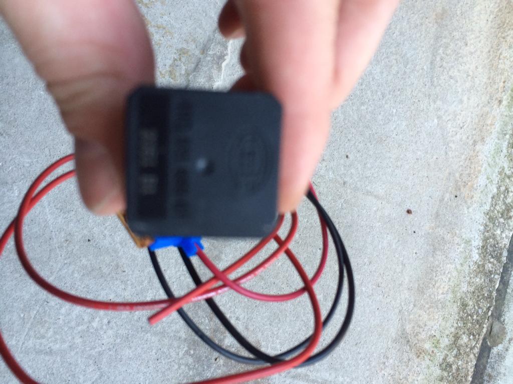

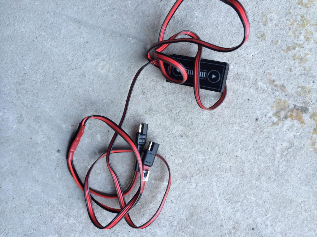

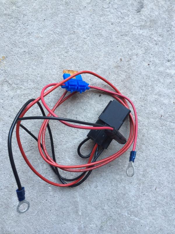

  11. Thanks mate. I'll do it later if I get chance. So you want. Pics of the seat and wiring and the bike around the battery. Really appreciate it. Would like to do it myself but just cautious.
  12. John won't need the bike pics, he's got one in bits at home! Maybe add some measurements of the wire lengths though and close ups of the connectors ;-)
  13. Yep, exactly as Andy has said.
    from that we can discuss how best to get you something you can fit yourself :wink:

  17. image.jpg image.jpg image.jpg image.jpg John sorry in delay had a busy few days with work commitments
