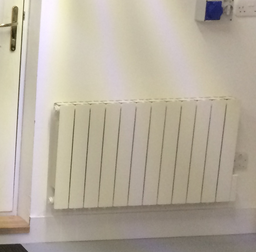

  7. Integral garage and I had a proper central heating rad put in. It’s as warm as the house and I’ve done the rubber seal thing on the doors.
    Definitely the way to go.
