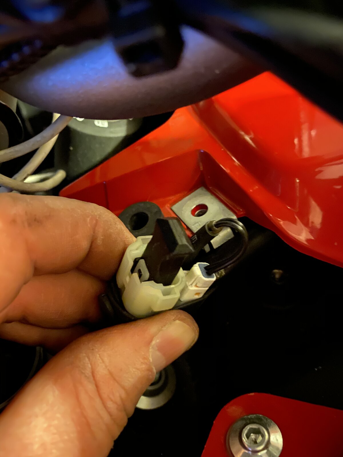

  9. Removed the front bodywork earlier - really bloody fiddly to undo the two screws, but got there eventually. While I was there I found a couple of accessory cables I might be able to use for spotlights or even another charger feed.

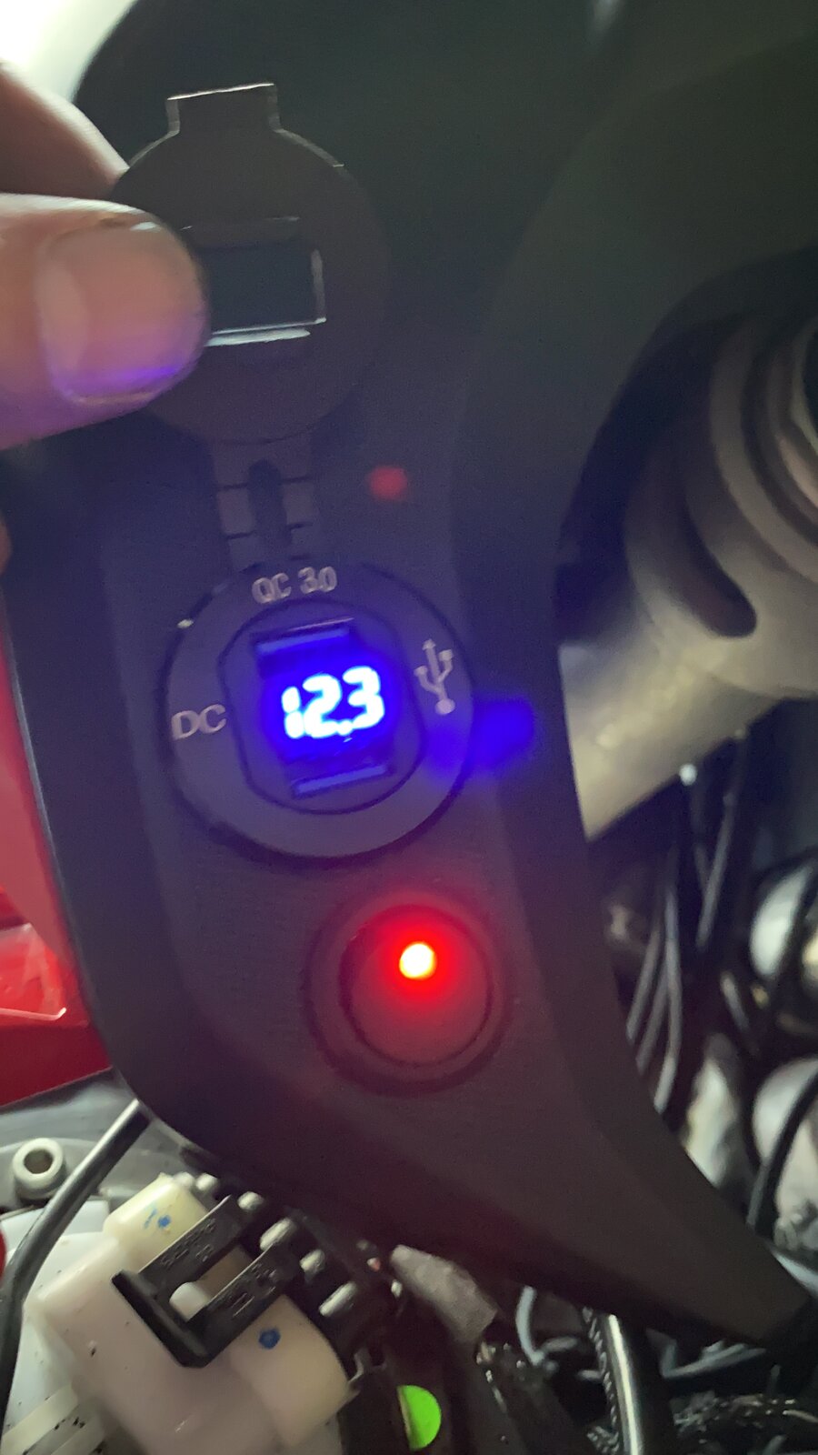

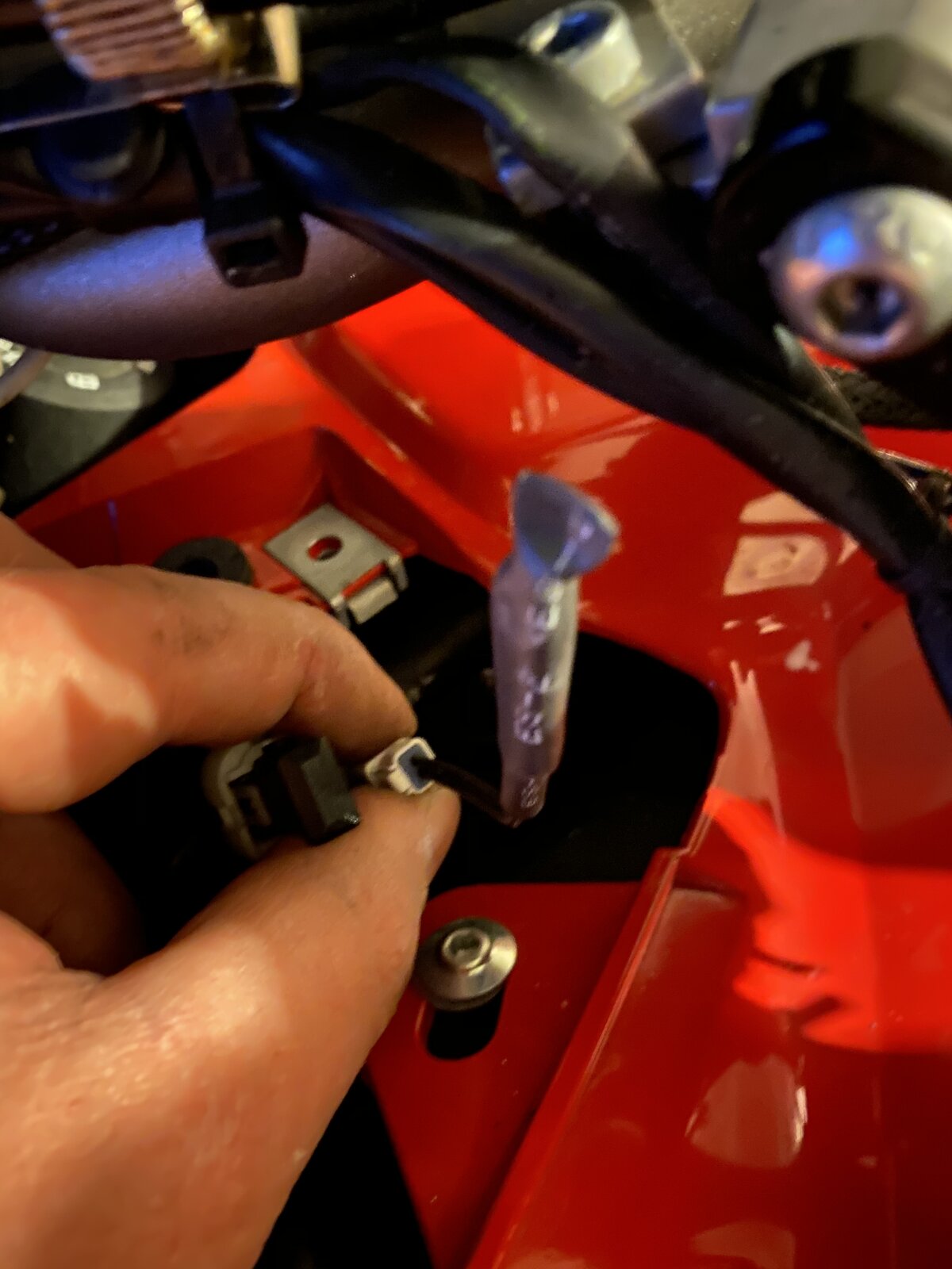

  14. I've more or less finished a mammoth couple of evenings in the garage, with a USB socket installed, plus a light switch for some auxiliary lights that I've added.
    I took a feed off the line for the Hella socket, and ran it back round beneath the windscreen. Removing the trim panel was the hardest part - it has two screws which are incredibly awkward to get at and undo! Once that was off I went at it with the Dremel, which always feels scary on an expensive vehicle!
    Pretty happy with the result. I guess now I need to see how well it charges when I'm using GPS.
  15. Did a 2.5hr ride on Friday and the charging socket works perfectly, charging my iPhone up even while using Google Maps. Very please with the result!
