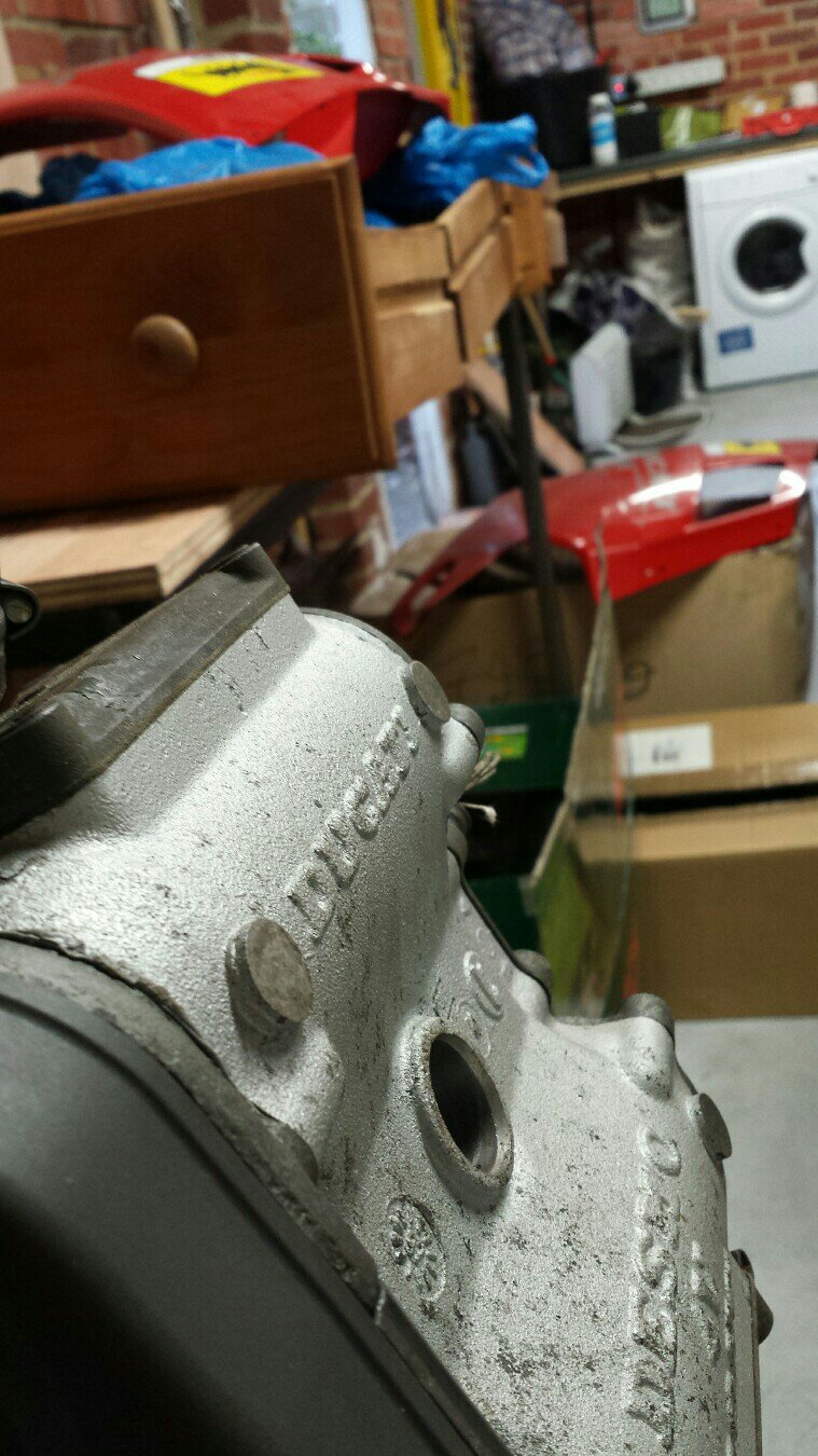

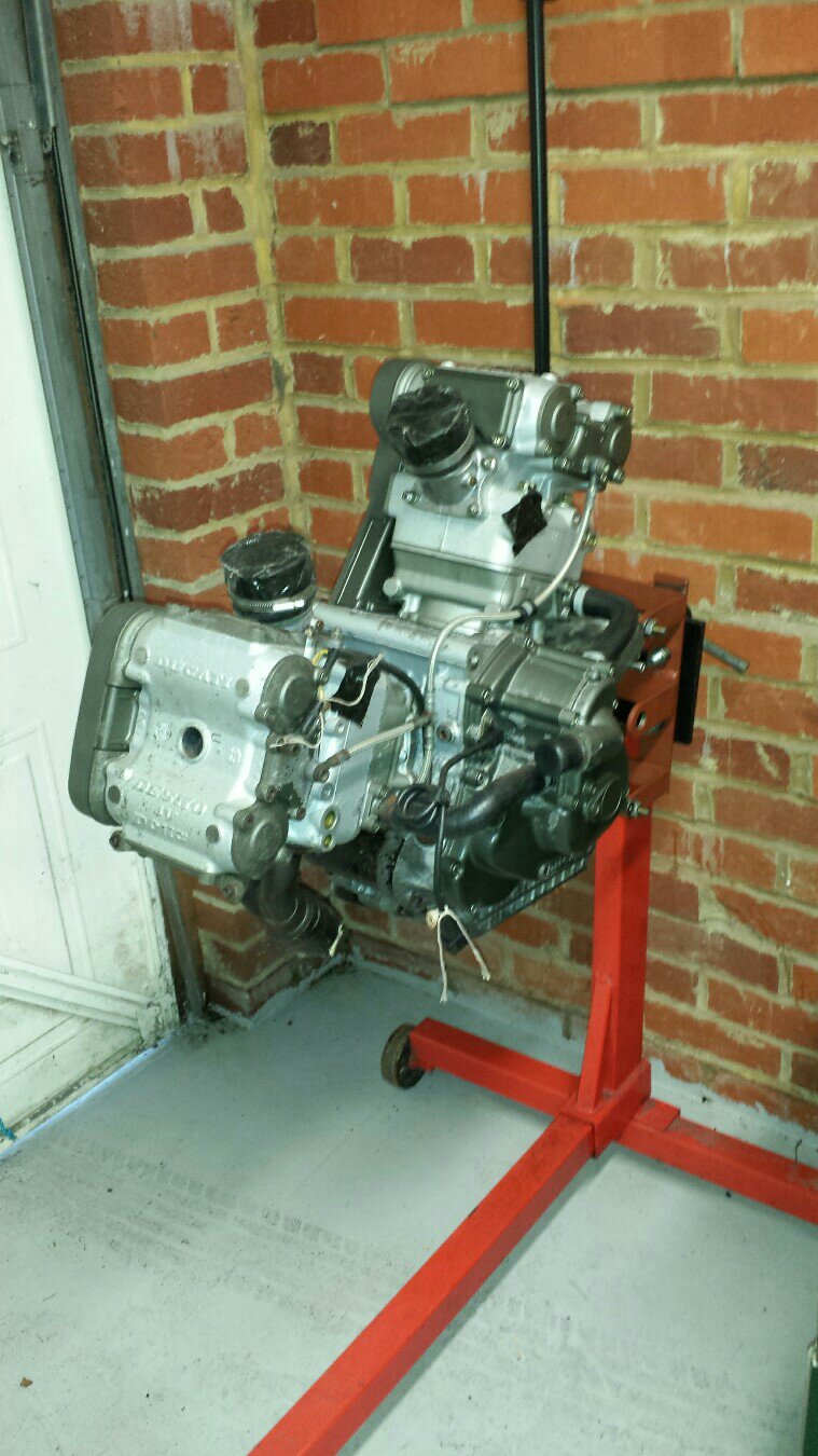

    The bike has arrived and the project starts!
    Firsy thing is to tackle the engine, which needs a clean and a paint. I would love to spray but don't want up upset any of the gaskets in place on the recently rebuilt lump.
    Progress report to follow.

  7. I have done this with a flaking 748R engine and as long as you mask up everything fully it should not be a problem.
    I have built several 748's from scratch and they are a fairly easy bike to build. Get yourself a copy of the service manual and use that to help with the build.

    I intend to clean, wire brush and gunk it so that it's as clean and degreased and then treat it to a lick of paint. Red998 did you spray or brush on your paint, one assumes spray will give a more even finish but will require much more dilligent masking.

  10. I sprayed my engine using a stock silver wheel colour which was a very close match for the original. I removed both side casings in order to mask up properly and to avoid spraying over the original case sealer. Doing this made it look more original as no sealer was painted over and it was easier to mask.
