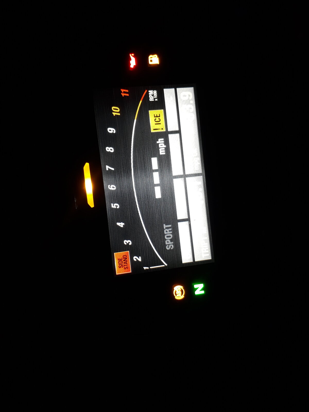

    I went to start my Monster today and and it wouldn't start. The fuel pump primed and the fans for the radiator started running, (at 2 degrees)! but all the dash lights were flashing and the side stand warning light was still lit despite it being retracted.
    The battery seems ok but the starter motor didn't engage and the dash seems to have gone haywire; please see pics below, the video file was too large to upload. It was running perfectly on Saturday, I washed and cleaned it then ran it to temperature to make sure that any water evaporated.
    Any helpful answers appreciated!

  3. Side stand light out even though it’s up and washed it the weekend could be a clue, wd40 the switch or remove it and try.
  4. You won't be the last one to have problems after washing ,sounds like it has water where you don't want it .

  11. The bike is a 2014 1200 S with 4,444 miles on the clock. It was meticulously maintained by a mechanical engineer and kept in a heated garage. The battery has enough juice to power all the other functions on the bike but the starting circuit has been bypassed by the malfunction.
    I had only had enough time after work the other day to have a quick look around the bike, I removed and checked all the fuses which were okay and checked and sprayed the connections to the coils, plus any other connectors I had access to before it got completely dark as It is currently kept outside. I got it to fire up which was encouraging but after I turned it off it was exactly the same as before.
    Today I removed the small cowling in front of the dash and sprayed the connectors there, then the connectors to what looks like the ECU under the seat and the other wiring connectors in the rear room that were visible. I managed to get it to fire up and run until it was hot, however now the dash is lighting up with random errors from Can Bus to engine management light, oil et cetera, while other functions blank out and the front and rear indicators are flashing randomly.
    From extensive googling it looks like this is a familiar problem with various Ducati models following washing or getting wet in the rain, and it’s often associated with water getting into the electronics under the seat. At the weekend I plan to check the connectors here to the ECU and the others to the rear of the bike and I’m hoping that this will be a simple way to resolve the problem and that the ECU has not been fried!

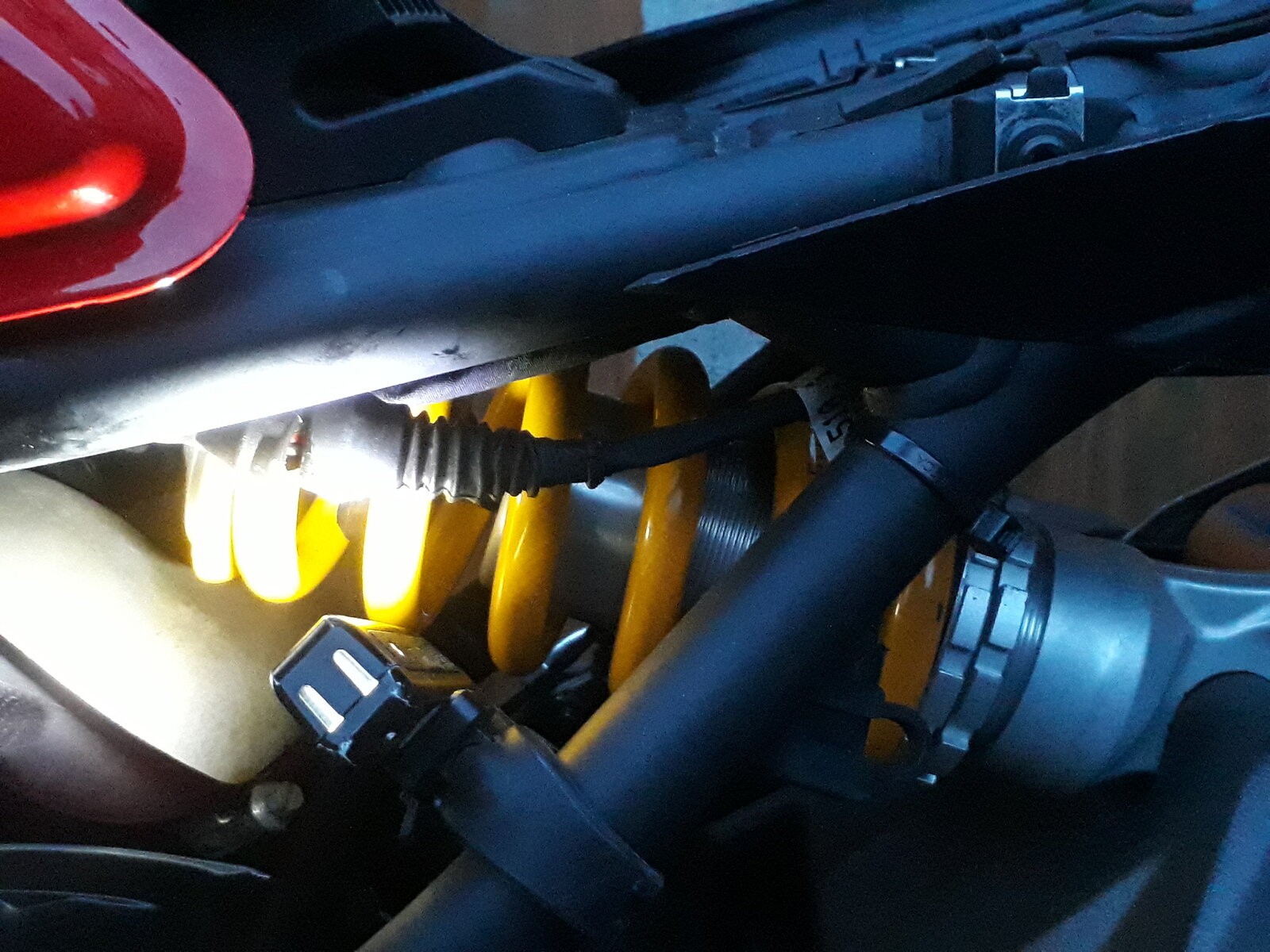

  12. Check the connector to the BBS unit under the seat. It connects various units; indicators, fuel gauge, stop light and fans to the rest of the bike via CANbus. Water has been known to get in there on other models with similar effects.
  13. Thanks Derek,
    that’s the first place I plan to check tomorrow
  14. It worked! Thanks for the heads up.
    I had quarter of an hour before it got dark and decided to try that one connector and sure enough the rubber shrouds were not meeting in the middle. Spraying it and making sure the shrouds were B2F65E90-7BB0-4E9D-A0AC-76EC691C8F00.jpeg connected seems to have done it. Happy days.
