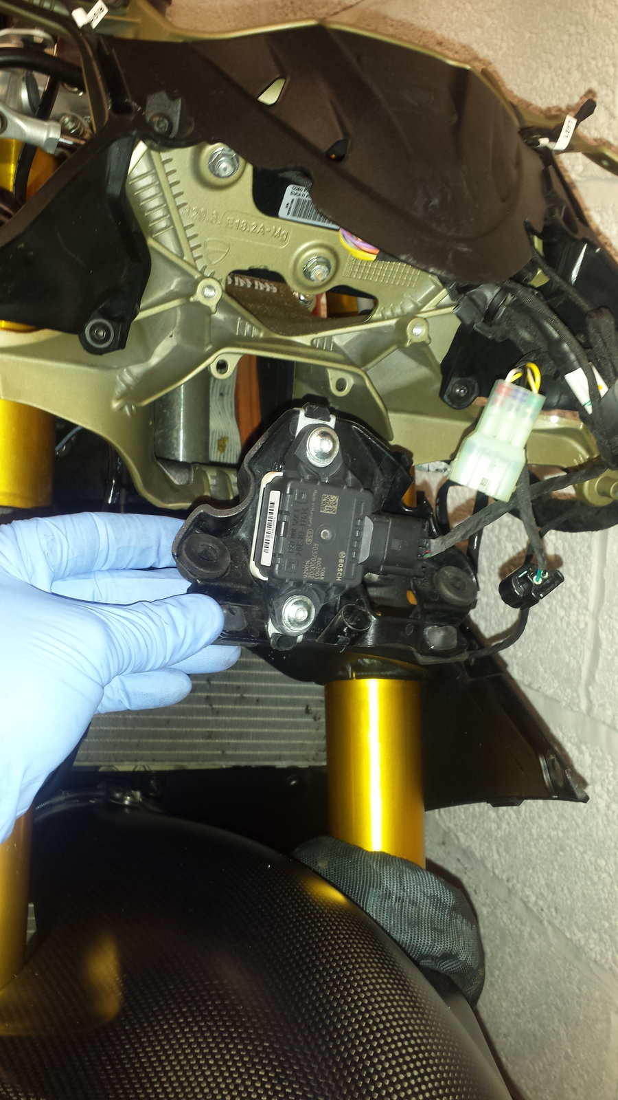

  1. Got my race fairings 2day and the head light blank dosnt have any lugs for this to bolt to what is it can i just tie it up or is it a a tilt sensor ?
  2. See the black box is made by Bosch? It's part of the very clever electronics on the bike. You have to mount it at exactly the original angle or clever stuff like ABS will not work properly. Somebody else will be along shortly who will tell you more. @royalwithcream ?
  3. Yeah I believe that box is the measurement unit
    Ridiculously the panigales don’t have a ‘tilt cut off’ they really should in my opinion.

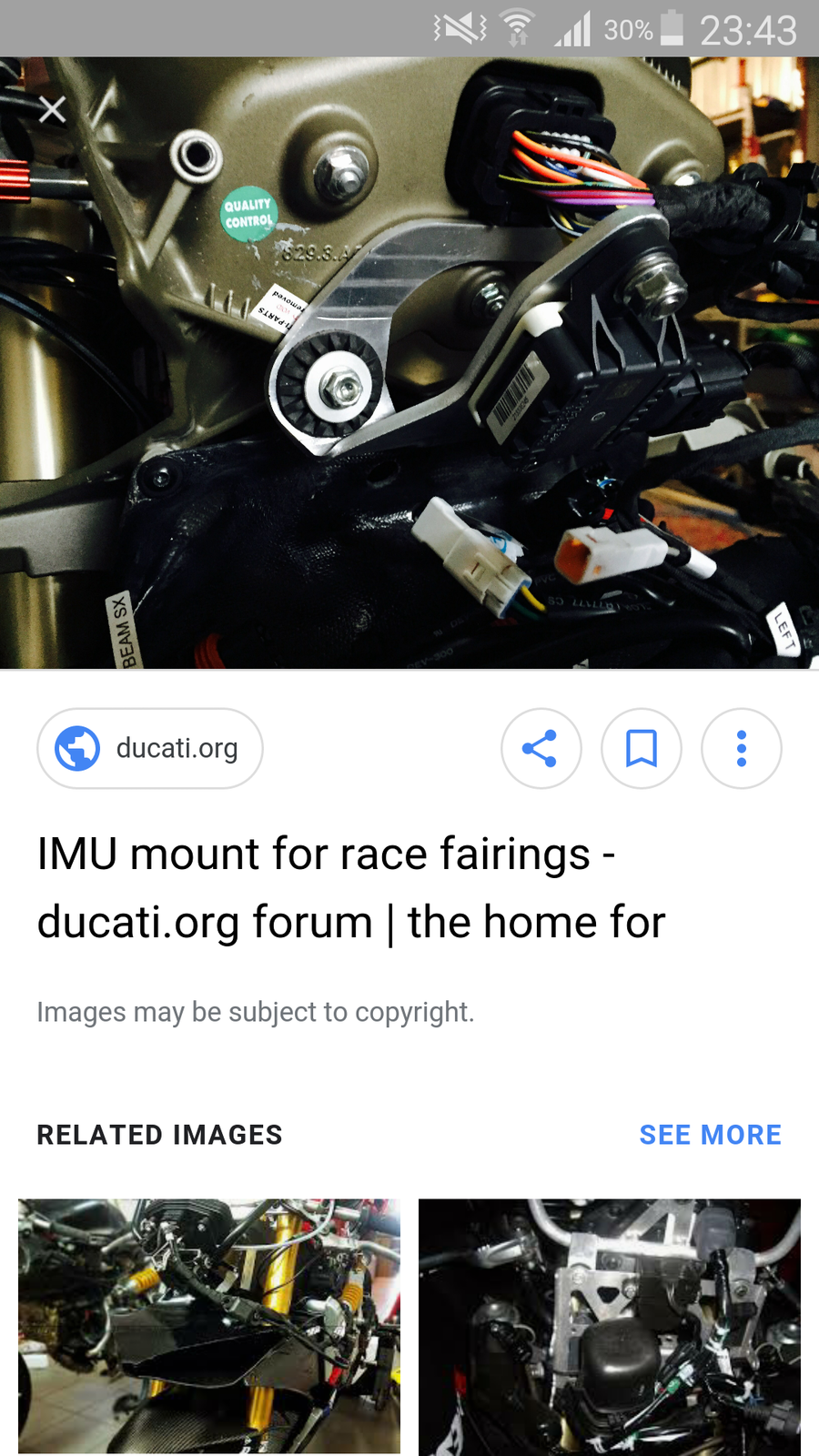

  4. The IMU does all sorts of trickery and it has to be mounted correctly or as has been said you’ll get ABS/TC issues.
    I’ve got a bracket for mine just google, I also think JHP make one if that helps.

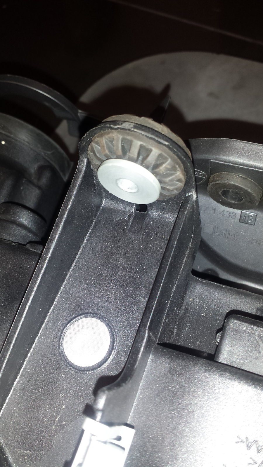

  5. Nothing to bolt it to on the new head light blank

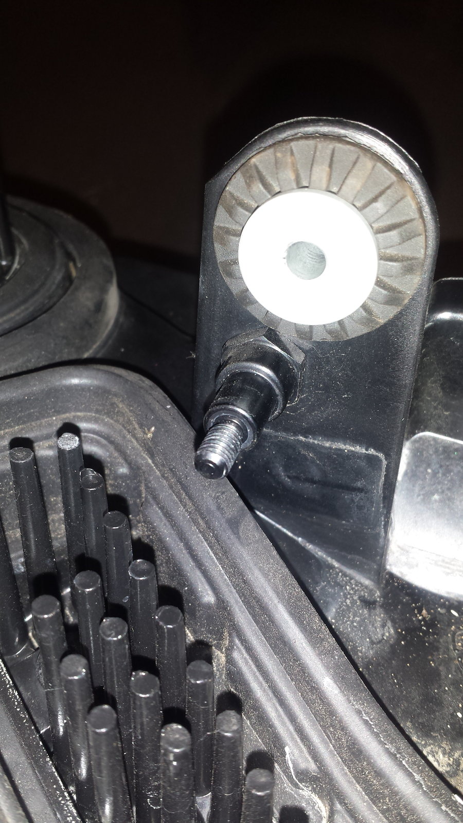

  6. This looks like the right thing but then i cant mount my head light blank with this in the way ?
