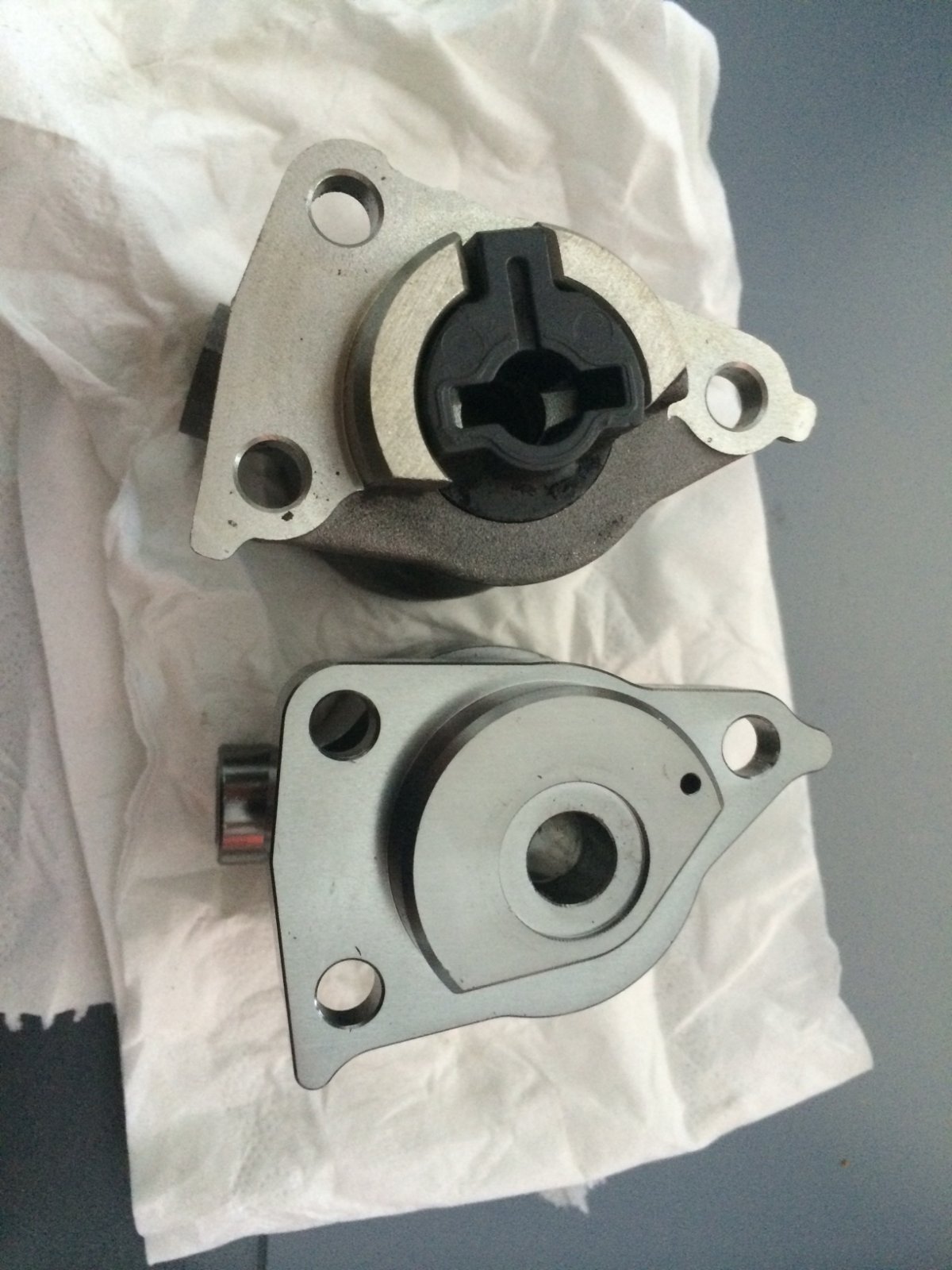

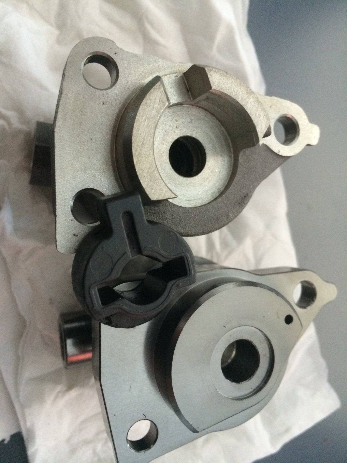

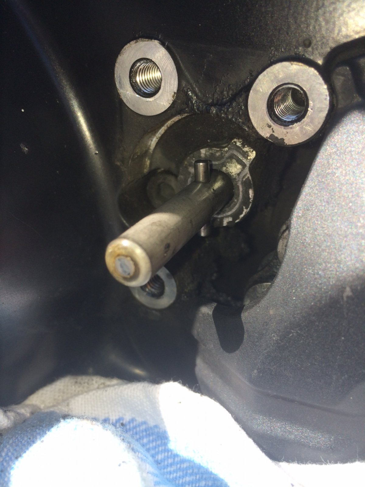

  1. Bought a Factory Racing clutch slave of ebay. Watched some vids of the work and went to do mine today, only my salve is not like the ones I've seen videos of.
    There's no washer, instead a plastic part and the push rod has another smaller rod passing through it at right angles.
    Needless to say the new slave cyl won't fit. Do replacements exist?
  2. Yours is the new slave which has an anti rotation peg in the push rod. It is to prevent the push rod from spinning and damaging the seals. Oberon do a replacement. Ducati Clutch Slave Cylinders
