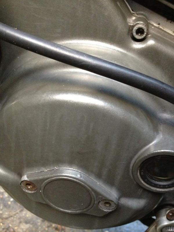

  1. Thought I'd wash the bike today .

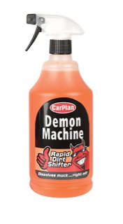

    It was quite grubby so I had this Demon diet shifter , says good for bikes and metal chrome and paint sprayed a bit on my swing arm and it was ok and lifted the grime .
    So I sprayed the engine and casings as they were dirty.
    As soon as the spray hit the casing the paint went dull.
    It said leave for 5 mins but I knew this was bad and quickly washed it off as fast as poss .
    But damage done .
    Not happy at all !
    Someone said buy some Jizer from Halfords and get it on the casings.
    I've washed and rubbed to no avail.

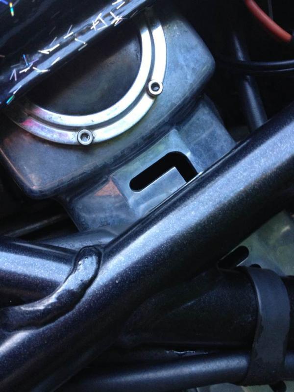

    It's also left my nice polished metal now white.
    Considering a product specifically saying for bikes I'm livid .
    Any ideas of how to try and sort this would be fab .. My bikes paint has held up for years and now ruined.
    I used Muc off years ago on black plastic and it did the same :(
    Il upload photos
  2. ImageUploadedByTapatalk1378676157.645836.jpg ImageUploadedByTapatalk1378676175.896503.jpg ImageUploadedByTapatalk1378676190.663953.jpg
    Messed up metal and the casing paint is ruined.
    The metal I polished last week was nice and shiny .. Now dull and white.
    But it may polish up.
    The paint I've washed rubbed all sorts and nothing .

    Have you tried using another cleaner to see if it is indeed stained or a wax from the cleaner?

  4. I see lots of damage/staining to casings, anodising and alloy from these. Usual answer to the question about what the customer uses is muc-off but many of the these cleaners are the same product but rebadged. I did some delving into them and most are very alkaline in make up. Some even make a point of being acid free, which they are, but from their data sheets, undiluted they have a ph of around 11........ That's caustic territory. Another telltale is heavy corrosion on screw threads where the solution has crept in during washing and doesn't get rinsed.

  7. Part of the problem is that Ducati use water based paint now and it cannot stand up to any form of solvent unlike two pack paints etc. of the past.

    As for sorting yours, I'd get some professional opinion....might be a case of some T-cut and taking back the paint. Hope you get it sorted ok.

    I found one thing on line a guy used it then washed his car and clay barred it and it wrecked the paintwork white all over this shiny red car .
    Again Demon product .

  14. Powder coating doesn't always guarantee that it will be impervious to detergents. I know some who had their gold coloured powdercoated cases melt when using only a mild cleaner on the paint.
    The answer is to avoid anything too harsh, Fairy liquid etc contains salt and that can be bad on the waterbased painted cases too.
    I have used SDoc 100 gel and that seemed to work well on a Yamaha RD250 LC casing.

  17. There in lies the trick. It can't be left for very long at all and must be thoroughly washed off. The dwell time is really short and "leaving it to soak" to better the cleaning leads to the damage. If there's heavy soiling and your busy agitating the grimy bits, it's already doing it damage on the other areas.
  18. SDoc is very good, as has been said.
    Brake cleaner is also good for where the bike is really grimey
