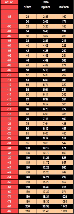

  1. Hello,
    Recently i bought a rear ohlins suspension for my 749s and it comes with this spring code 01091-16/64.
    I'm a bit confused, ive benn searching many forum for some answer before posting here but with no conclusion.
    My weight with all gear is +/-76Kg.
    From the many charts i've seen, one it says this spring (01091-16/64) is for my weight, other chart it says 90 or 9.0 is correct for me and my 749s.
    Can any one please let me know wich spring is correct for me?
  2. Your first chart in black with white writing is a front fork spring chart, the second a rear spring chart and the third a front and rear spring chart and all self explanatory. Don't confuse front and rear spring measures. Obviously getting your sag correct for your weight with the correct springs is key.
