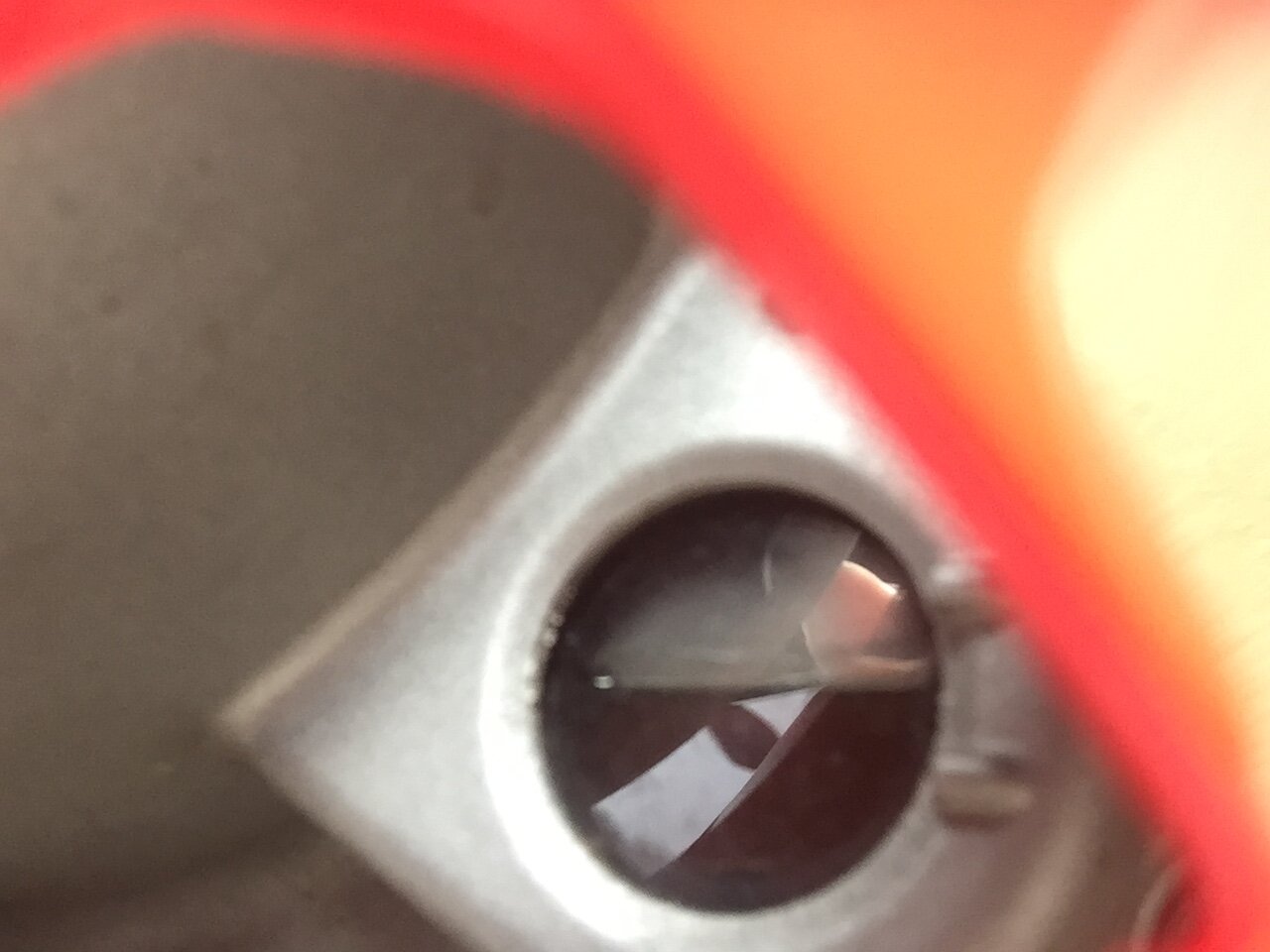

  11. Checking the oil on your own??…absolute doddle…
    Use your camera phone ;) :D
    Sit on the bike keeping it perfectly upright, switch camera phone on, dangle arm down the side of bike, aim at the oil sight keeping camera square and click away, you’ll get something like this,…or even better :bucktooth:
    You might have to have a couple of goes adjusting the angle of dangle, but you get the idea ;) :upyeah:
