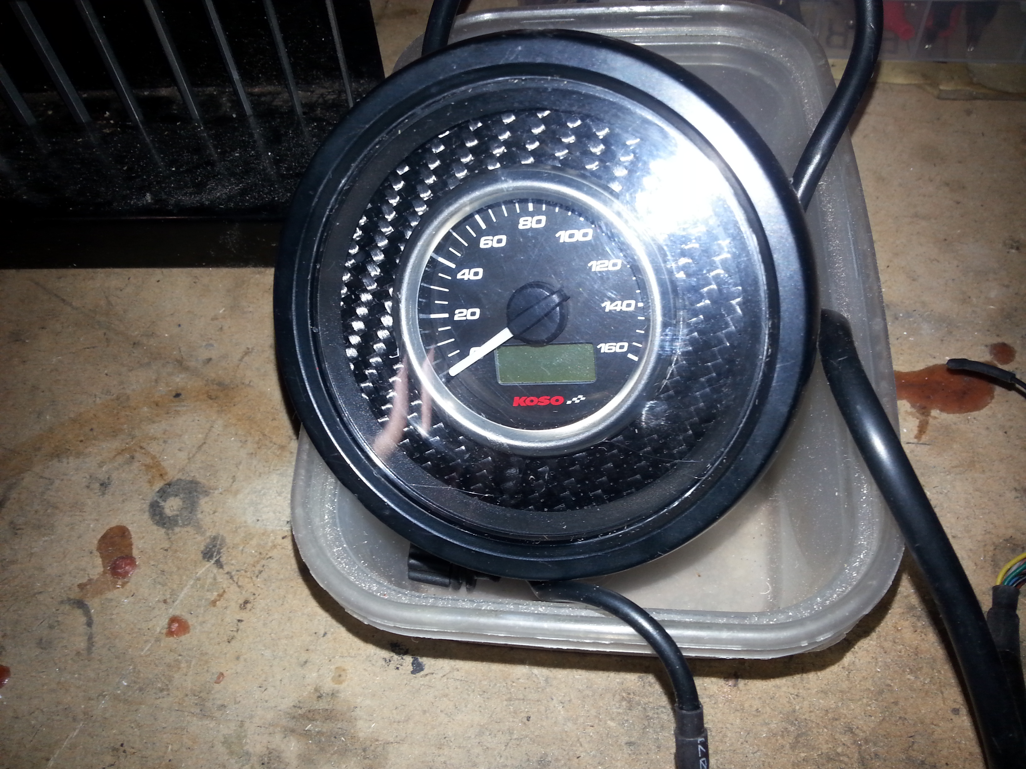

  2. hi calle , ive done this first with standard brakes then with radial fork/ brakes, if you,re ok with your forks / brakes all you need is a spacer for the wheel, and some 10mm offset 5 bolt rotors , this took me ages to find and 3 sets of discs sent by people who got the offset wrong. i still have these if you re interested. second speedo is fairly straight foward this was my effort. set in original speedo. spindle and nuts can be kept. newphone 025.jpg . hope this helps, arle
