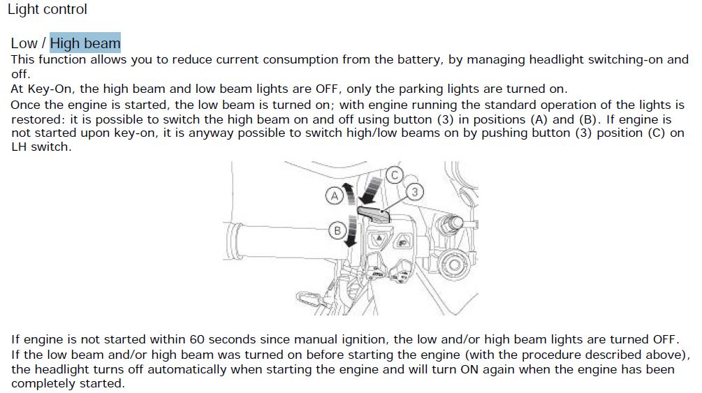

Just bought a 2014 Multi 1200 PP but can't work out how to operate the headlight! The switch that I would think would change from dipped to high beam operates the computer and I can't find out anything in the manual. Please help!
I haven't got one but every modern Ducati does not give you the option of turning it off! It should come on when the ignition is turned on. It may go out after a few seconds if the engine is not started but there is no switch to switch off the lights!
The headlight comes on with the ignition but I can't find out how to turn the high beam on/off. I have looked through the manual and only found how to adjust the beam height. I can't find out which switch operates high beam - should be obvious really!
That switch also goes up and down as well as in and out. Push it vertically down and you should go from high to low. Andy
The flash light switch just works when pressed only - like on previous bikes. Are you saying this switch should turn high on/off?
I meant if you pull the pass switch with your left index finger does high beam come on. If not, bulb gone so no switch will work. If it does, either switch faulty or you haven’t found the right switch ! Should all be in owners manual though?
