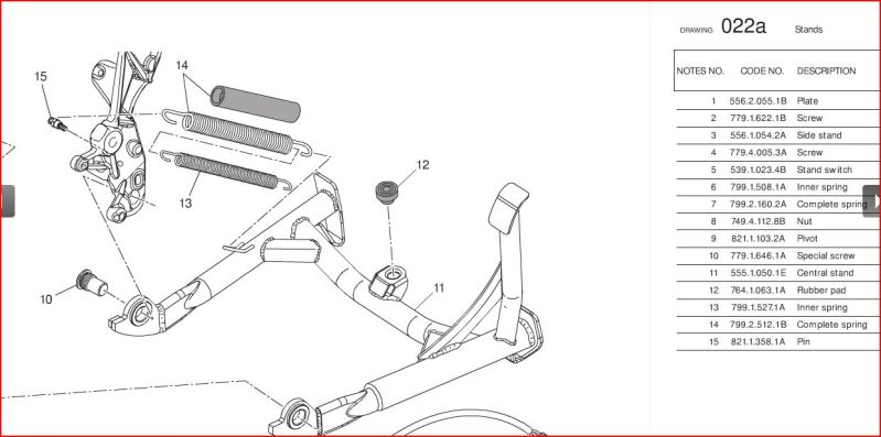

  2. Hi Clattered,
    Just been out and measured the spring:
    • Full length ie top of hook bend to hook bend = 14.5 cm
    • Spring length = 10.3 cm
    These are approximates and hopefully someone else will be able to come on and provide the exact dimensions. There are actually two springs believe it or not with No 13 going inside No 14 (don't have a scooby what the idea behind having one spring inside the other is? :redface:) Here's a picture from the micro fiche of the Centre Stand assembly which will hopefully give you a clearer idea of what's needed:
    Can't help with where to find one in your neck of the woods I'm afraid :frown:

  3. Mark,
    Thanks so much for that. Universal springs aren't going to cut it reckon and I'm getting the distinct impression that these spring in a spring jobs are hard to find. Guess another phone call to Ducati Coventry is in order in the morning!!! Hopefully they might fit it for me if I smile nicely. Oh well, another good excuse to get the old girl out ;))))

  5. No problem and I hope Coventry sort it out for you. If not, Pete has come up with a decent temporary fix by the looks of it :upyeah:.
