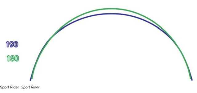

  6. Certain tyre sizes and profiles are designed for 5.5” rims and some are designed to fit 6” rims. Just because something physically fits doesn’t mean it’s going to work as it should. Some people say they can’t feel the difference between tyres but a racer or road tester will tell you immediately what has changed.
    Since the 916/748 were designed tyre development has continued and sizes/profiles are available now that weren’t back in the 90’s.
    There’s a reason that Ducati started using 180/60 and 120/70 on the 899/959/V2 - they worked with the tyre manufacturer and found what gave the best results.
    As you already know 190/50 tyre is quite a wide and flat - and is designed for a 6” rim.
    When you put it on a 5.5 rim you actually squeeze it a little so it makes the profile a little less flat - this can be beneficial as it makes turn in a little quicker and brings the profile closer to the 180/60 shape.
    But it’s still not going to be the same shape and not as tall - which affects the geometry of the bike as well as the speed of turn in.
    Ducati have been making small incremental changes in each generation of bike to try and find that perfect geometry 5mm difference in rear ride height might seem like nothing but that’s the kind of figures we are talking about when looking at the tweaks they make from generation to generation.
    https://www.cycleworld.com/sport-rider/does-size-matter/
    It’s worth noting that tyre profiles differ between manufacturers and also between tyre series from the same manufacturer.
    Swapping and changing tyres between all of these options and truly being able to understand the differences is pretty much impossible for mere mortals.
    Manufacturers hire out circuits for 3 days at a time to for tyre testing and run incredibly detailed back to back tests under controlled conditions. If the circuit temperature changes significantly then that it going to alter the characteristics of the tyres - even with professional test and development riders it’s a tall order to get perfect consistency.
    In truth we can talk all we want - most of us would be fine with any tyre that’s ballpark the right size and reasonably sticky - all of the rest is just some bollocks to talk on the internet! ;)

    “Ducati 748/9XX's come with 5.5 inch rims standard, although some 916's did come with 6.0 inch rims from the factory. In order to get the correct tire profile, the recommended street tire size for 5.5 inch rims specified by the Pirelli and Michelin is 180/55 and for 6.0 inch rims it's 190/50.
    The outside diameter of both size tires is the same so a switch won't require a rear ride height adjustment. The important difference is that the 180 is a 55 section meaning that it's height is 55% of the width cross-section. The 190 is 50% of it's width. This means that the 55-section tire has a steeper profile, it's taller.
    When you mount a 190 tire onto a 5.5 inch rim it's profile becomes slightly incorrect. The too-narrow rim forces the tire's outer edges inward into a tighter curve so that you can't use this part of the tire effectively. A correct tire profile creates a correctly-shaped road contact patch essential to optimum handling, better sidewall stability with less tire flex and, and better overall tire wear.
    When developing the suspension for the 916, Ducati had World Superbike racing in mind so when they sold models for the street they decided to mount 190/50 tires to 5.5 inch rims, a good combination for stable handling. It's been pointed out that WSB Ducati's then used 19/67 race tires, roughly equivalent to a 190/60 road tire. So, we got the wide tire look without the quicker turn-in handling characteristics of the 60 section race tire.
    In the 1995 916 owner's manual, Ducati specified the 180/55 as an "alternative" to the 190/50 and the bike's under-seat specification sticker also listed both sizes as recommended.
    It wasn't too long before buyers figured out that switching from the 190/50 to the 180/55 gave a very noticeable change in cornering feel. The 180's, mainly because of their taller, steeper profile, turn-in much quicker and easier. So eventually the word spread, and everyone who has changed to the 180's has praised its positive effects on handling.”
