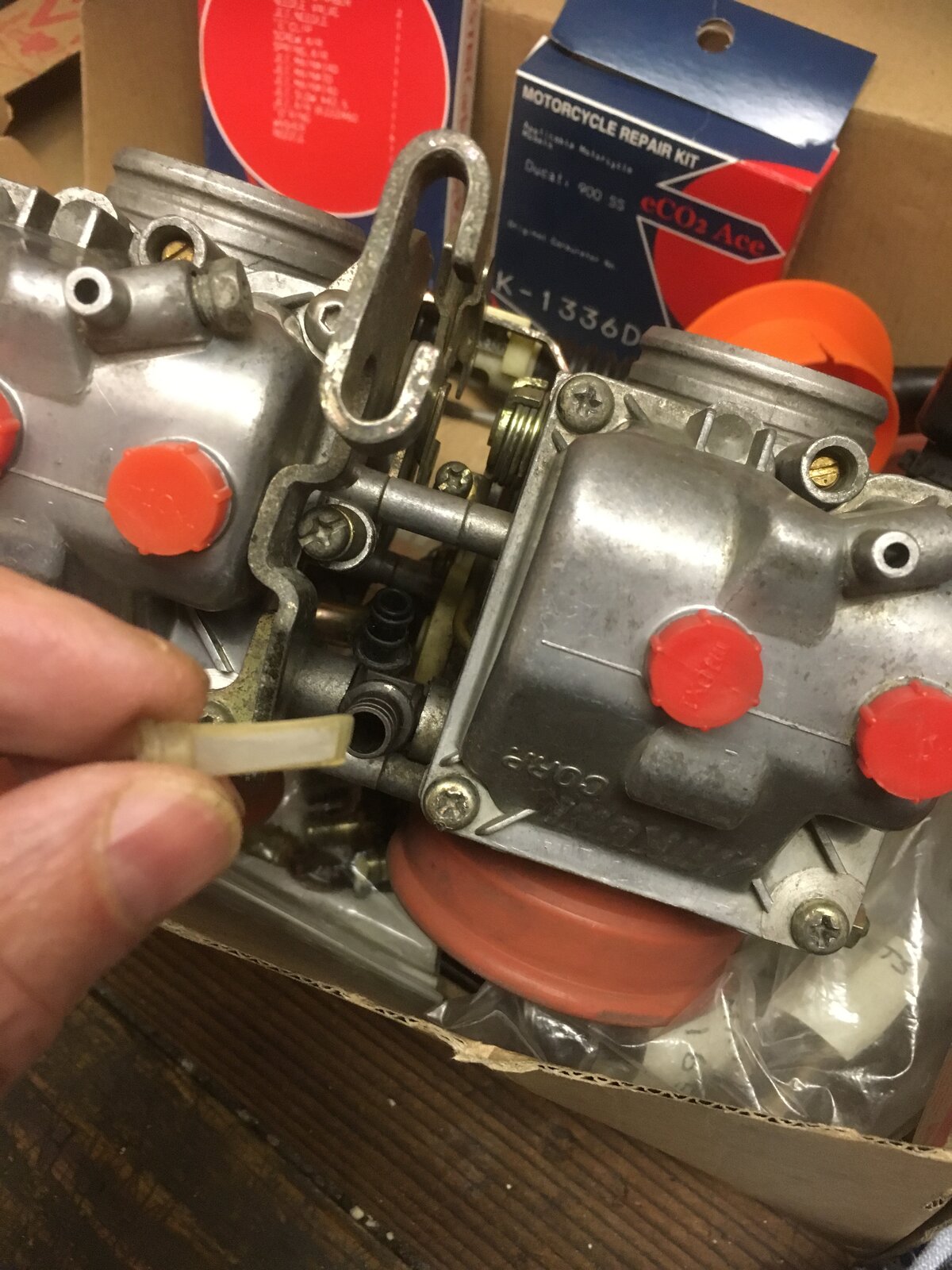

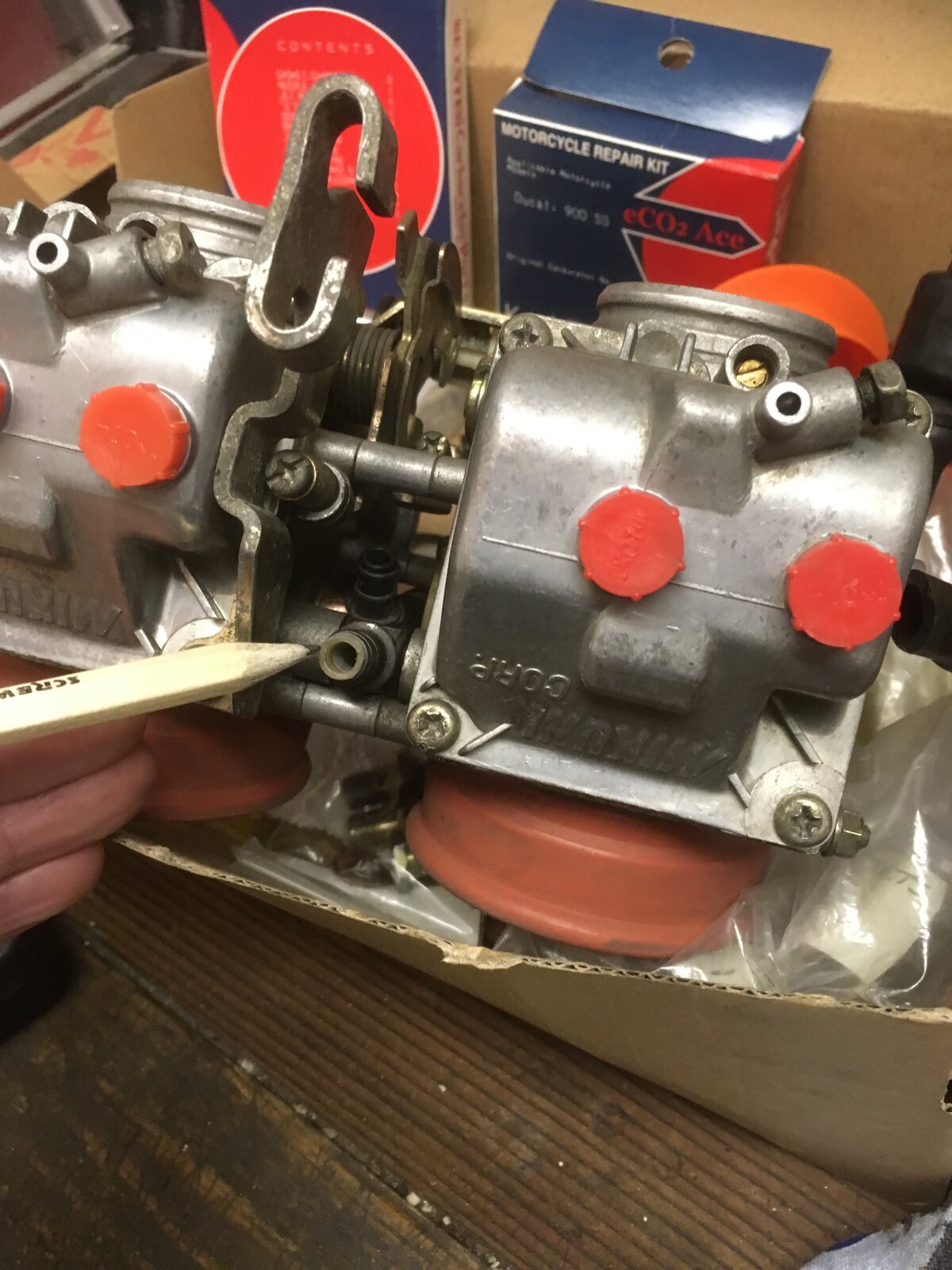

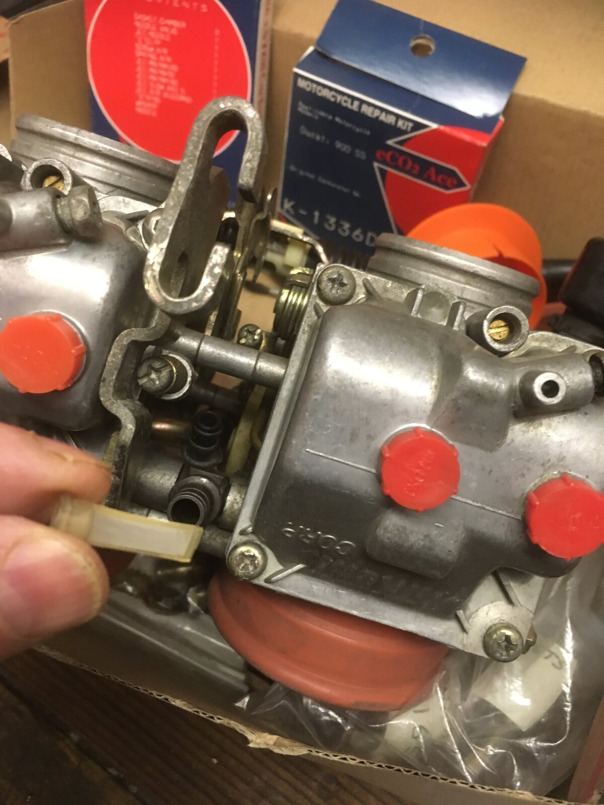

    Check your flexible fuel pipes inside the tank as these have been known to rupture and loose a lot of fuel flow also there’s a fuel filter at the carb inlet, check it or better still remove it, it looks like a sock if it’s still there.
  8. Thanks bumpstart, I don't recall seeing that particular filter when I put it back together, but then, they're easy to miss. I'll take a look and see if it's there.
