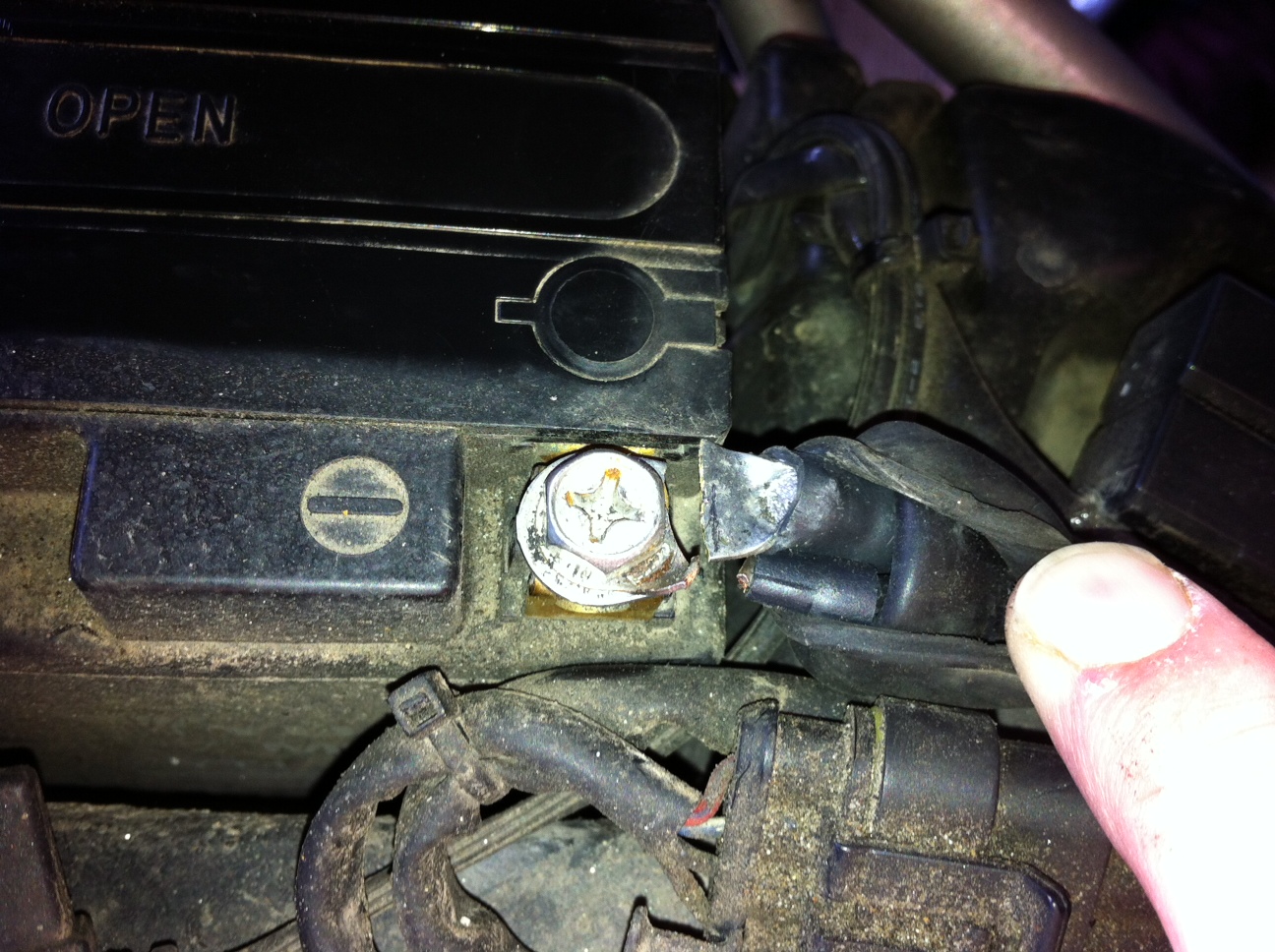

  6. I had similar issues with the battery - the negative lead cracked and was being held in my the rubber boot. Impossible to see until you pulled back the rubber! I only found it because riding home in the dark the whole bike kept cutting out - clocks going off, lights going out, speed reading going haywire, etc, and knew it was something battery related.
    Other than that I would suspect the side-stand switch as this will cut the engine if the bike is in gear and running without the clutch pulled in. Not that expensive to replace but maybe a good clean will help.
