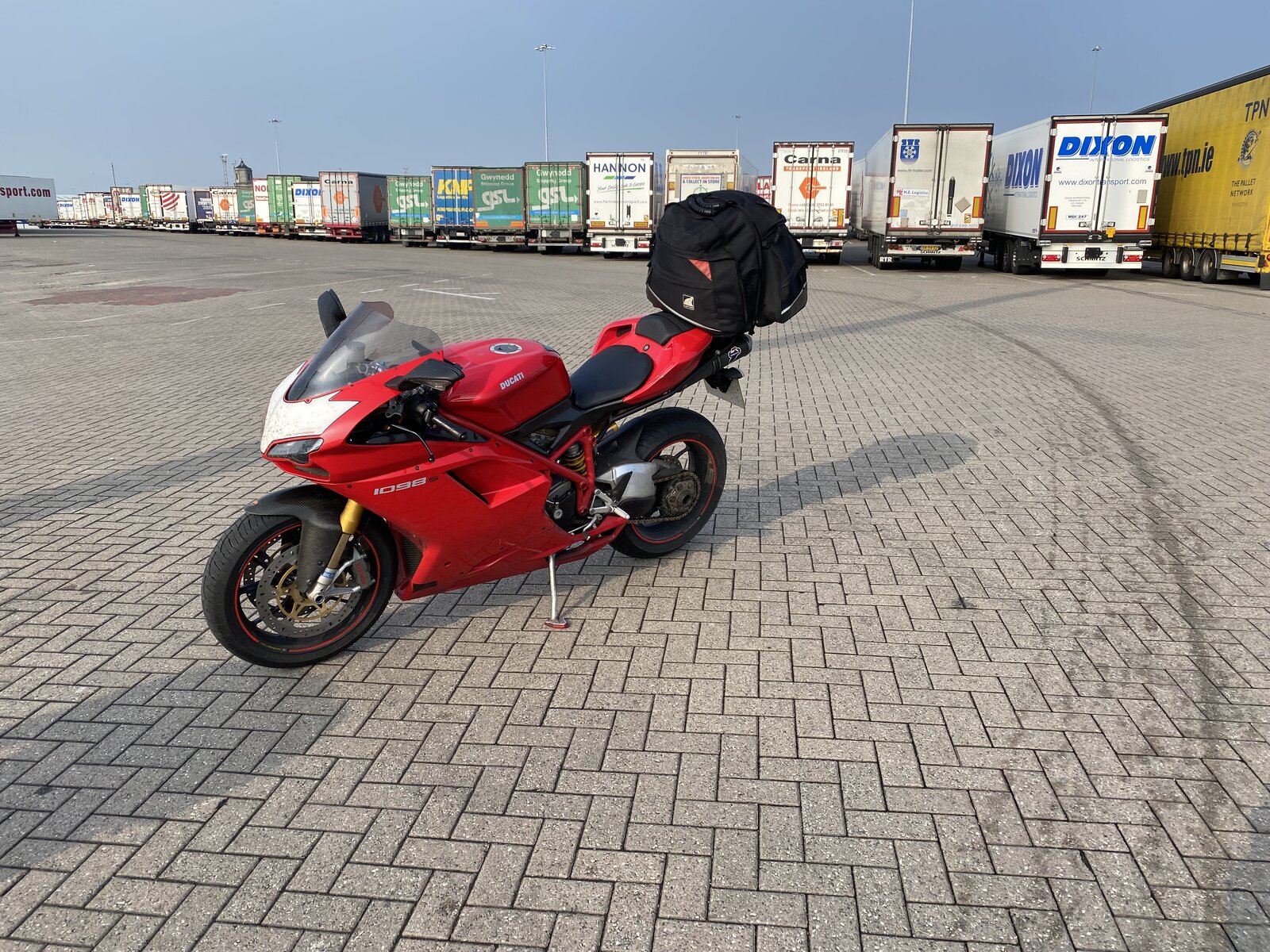

  1. So, I am on day two of an 8 day tour on my 1098. Heading for Ireland.
    I have an intermittent electrical fault. The instrument cluster back light, and the main lights die. It goes to parking lights only. Indicators, neutral light and main beam, std beam do not work. Engine runs fine. If I pull over and stop the engine, on the kill button, instantly the dash and lights comes back on. I set off again and between 5mins and 20mins the same issue occurs.
    So, any thoughts? Anyone had these issues? Thanks in advance for your help. IMG_2857.jpeg
    I think I will be okay riding it as it will be daytime riding on tour, but it needs to be fixed.
