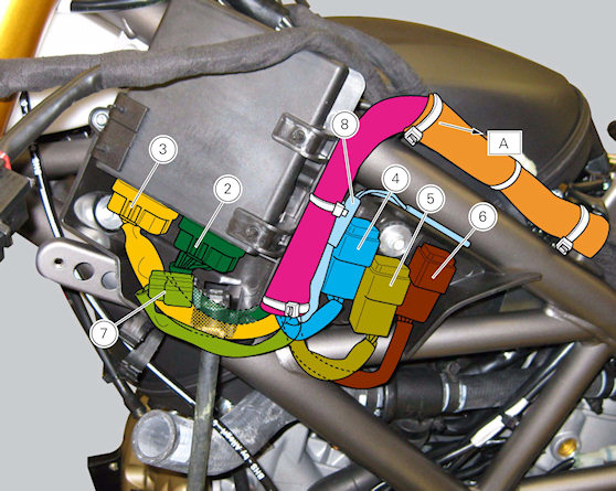

  3. It SEEMS to have been the Fuel Injection relay on the near side under the cover (number 4 below)
    I pulled all three, some were very mildly corroded (surface only) but refitting them has cleared the error and bike starts now!
    Whoopee! But leaves that nagging feeling - is that it, or will it recur? Have put on dialectic grease (thanks Exige) to help.

  4. Swap with a less important relay such as No6. That's the fan relay and will only be needed when you reach higher temps and just gives a fan relay error.
