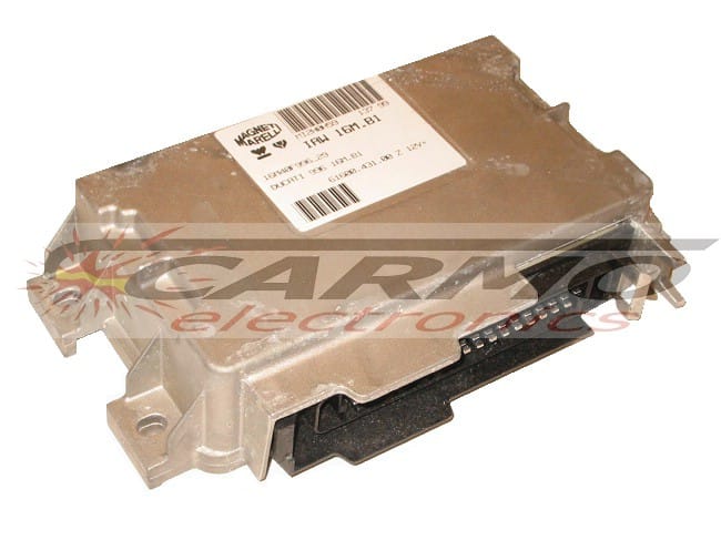

  3. as Jock says from the tests you have performed it would seem it has to be down to :- one connector check via brown wire from injectors (connector for that cylinder only), a continuity check of coil trigger wire (also brown?) running to long ECU connector plug - pin Number 1 assuming it's the same as 748/9** etc and a check for corrosion at the ECU plug at that pin number at the same time. Interesting that it's on the end so possibly more prone to moisture/corrosion. If none of this works you could even try carefully reseating chip as I know that this has been known to work occasionally - finally, it's 'borrow someone elses ECU time'. If yours does use a 16M type and you were closer you would be welcome.

  7. have a look on the label underneath :- [​IMG]
  8. Yes sometimes the answers are obvious :redface: Mine doesn't look like that one though.

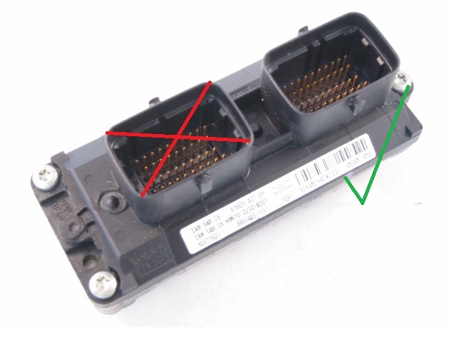

  10. You're ECU looks like this and is mounted near the battery (ignore the cross and tick)

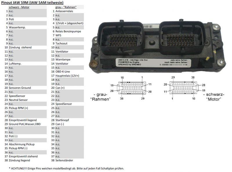

  11. there you go - nothing like a bit of teamwork when someone's flailing about in the dark :smile: could you go a step further and tell Peter the corresponding pin number on the ECU for the trigger wire on horizontal cylinder John?
  12. Hi Chris
    The diagram states that the Pin is Engine 38, the codes are split into Body and Engine, I'm unsure if the 2 types relate to the 2 plugs. The wire is Grey/Blue.
    Here is the link to the diagram I am looking at
    http://www.ducatiwiki.net/images/f/f5/ST4S_05(Colour).pdf
    Hope that helps
    John
  13. Chris W, that is superb.
    I just did some quick Googling
    Motor - Engine
    Rahmen - Body
    Pin 38 Motor Horizontal Coil Trigger (Edit: Chris we posted at the same time)
    Pin 10 is the Vertical Coil trigger
    Peter - Just check it all ties up and the wiring colors correspond to the pins and you should be good
    Great when a few us pulling together can really help
    John
    #14 Old Jock, Jul 9, 2012
  14. The side you are interested is the Schwarz (black) this relates to the colour of the ECU connector bases. I do all my ECU work on the Grey side so I am learning things from this post.

    Chris, ChrisW & John, Many thanks for this lot particularly the link to the colour wiring diagram and picture of the ECU, yes that looks like mine. However knowing what pin does what doesn't help me to much (probably 'cos I'm thick)! the connectors to the ECU are mould plugs with a clamp arrangement, so if its plugged in I cant get a multimeter on to the connectors to carry out any kind of checks. If I take the connector plugs off the pins are so small and close together I don't think I would be able to connect a meter to them without shorting against something and frying the ECU!
