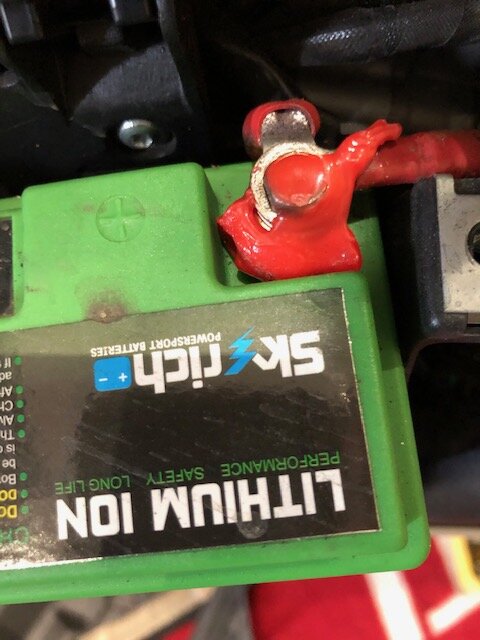

  4. OK, doing some investigation into this. The connections on the battery (both pos and neg) where loose, I presume they’ve just vibrated loose. Obviously that could cause the latter issue of dead at the petrol station, but could it cause the earlier DES and SCU faults?
    also, see pic, melted plastic cover over the positive connection! Has charging caused this? Or is the li/Ion battery produced so much heat when ur I got the bike over?........
  5. i would say yo may have found the source of the issue as i was about to write to check connections and also maybe worth pulling the battery and checking the Negative and also the live cables for damage or loose connection ( my earth was loose on the engine and they gave me some issues as well..
    a poor connections can play havoc with our modern day electronics and can bus systems
  6. Thanks Nathanhu, I’ll take it for a spin and see if the problems cleared up.
  7. Loose terminal, high resistance = heat
  8. Thanks Chrisw.....I’m not an electrician.....I guess you worked that out!
  9. As this is the first hit that came up on Google when searching about 1299 DES and SCU errors thought I'd back up the above - I had the same symptoms as described by OP and it was also simply a loose battery connection. Tightened it up at the roadside and all sorted :upyeah:

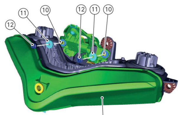

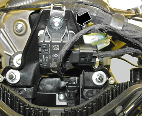

    Theres an inertia sensor underneath front fairing that needs to be rubber mounted. Apparently, someone may or may not contradict here, this vibes and causes the fault. Ive since slipped some rubber washers (tap washers) above and below the fixing screws as I had fairing off. Its directly behind the place you put the oem gps. The intertai sensor is between the numbers 10-10
