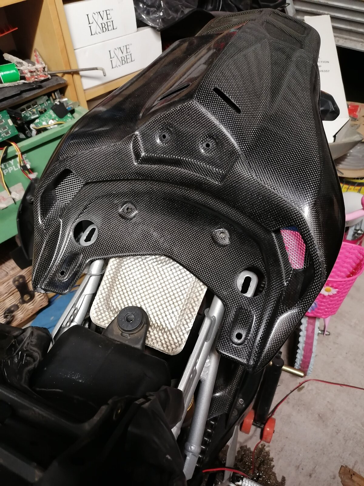

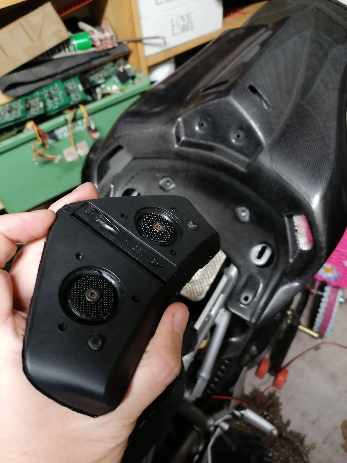

  1. Hi all. I have a 749 which I'm converting to a mono (subframe already on etc). I bought a tasty carbon rear but when I've ordered the seat back I can't figure out how to fit it or if I'm missing some bits? I've looked at all the manuals and online parts catalogues but can't make it out so thought I ask on here. The only conclusion I can make is I'm missing the opposite of those little velcro things that have been supplied...
    P.S. ignore the mess on the floor - I kicked the drain pan after I'd dropped the oil... IMG_20191230_195914.jpg IMG_20191230_195938.jpg
  2. Yep velcro parts missing
  3. Thanks - that's been driving me nuts! You wouldn't happen to know the part number(s) for when I call them tomorrow?
  4. Craig at Moto Rapido will know. Plus rivets and washers I believe.
  5. I just screwed self tappers into the pad with washers under the heads. No risk of loosing the pad if the Velcro comes unstuck.
    Don’t ask me how I know this...
  6. Don't try using normal Velcro. You need 3M Dual Lock. You can get it on eBay. 3M actual produce the discs pre -cut possible part number SJ3762.
