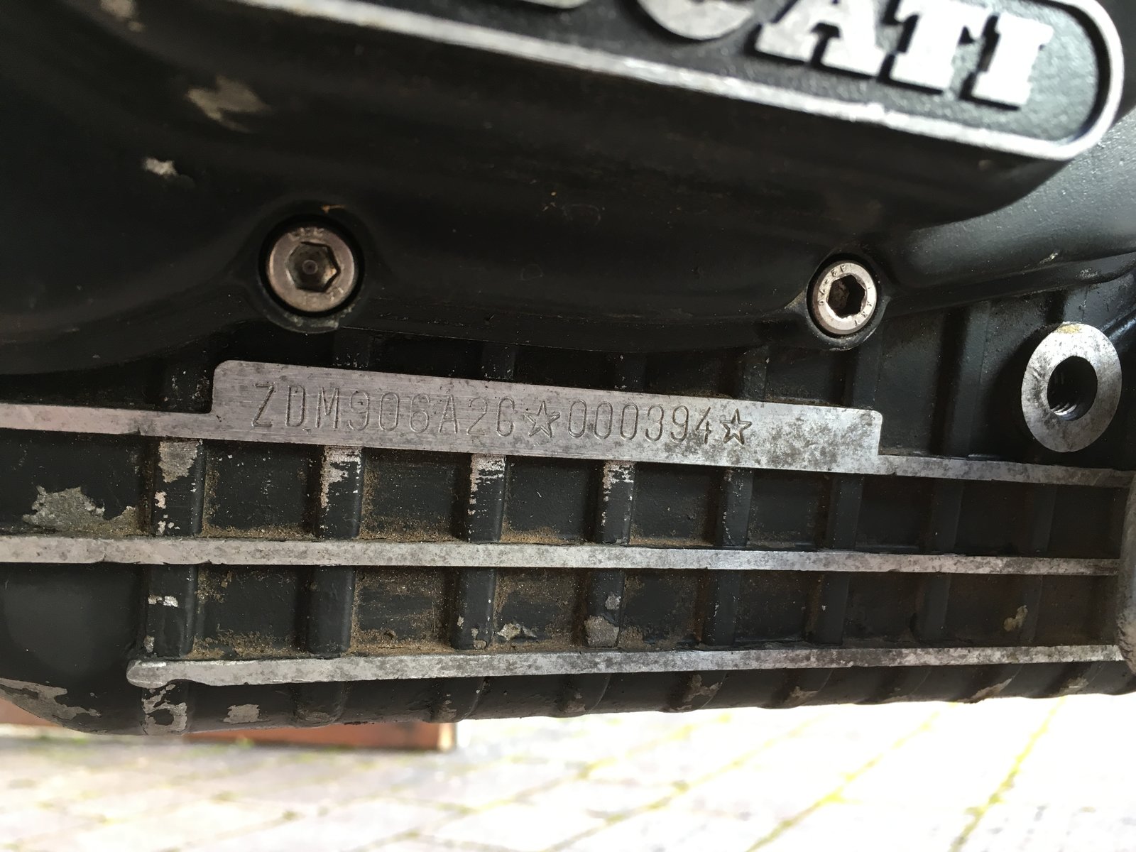

  1. Wondered if you beautiful people could help me identify the engine from attached engine number :) IMG_5161.JPG
  2. It a water cooled 904cc engine from a 907ie.
  3. Thanks Derek for a speedy response, i recently imported this bike and just got her running :)

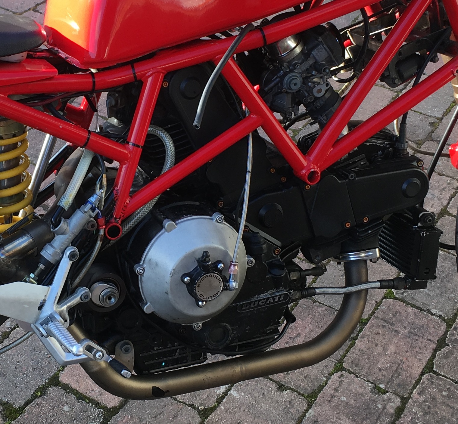

    But she is not water cooled, is it just an air cooled version of a 907ie ? ducati pip.jpg
  4. Ah! The ZDM906 prefix threw me. Looks like it is in fact a 900 Supersport from around 1989/90 but I'd expect the engine number to begin with ZDM 904 A. But the 'A' after the ZDM906 would indicate that it is air cooled.

  6. Sorry if its off topic, but can I ask how the hydraulic clutch conversion works? Apologies for my ignorance, but all the hydraulic clutches I've seen on Ducatis operate from the opposite side with a pushrod through the input shaft. How does this one disengage the clutch?
