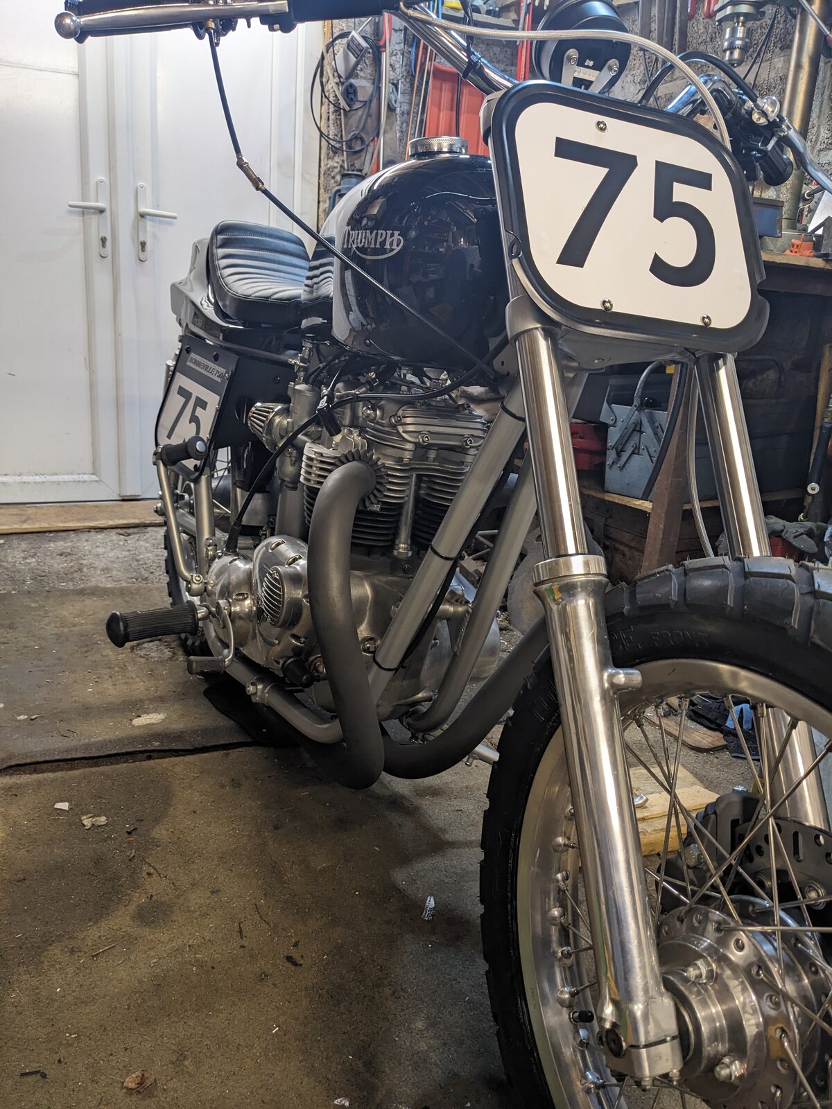

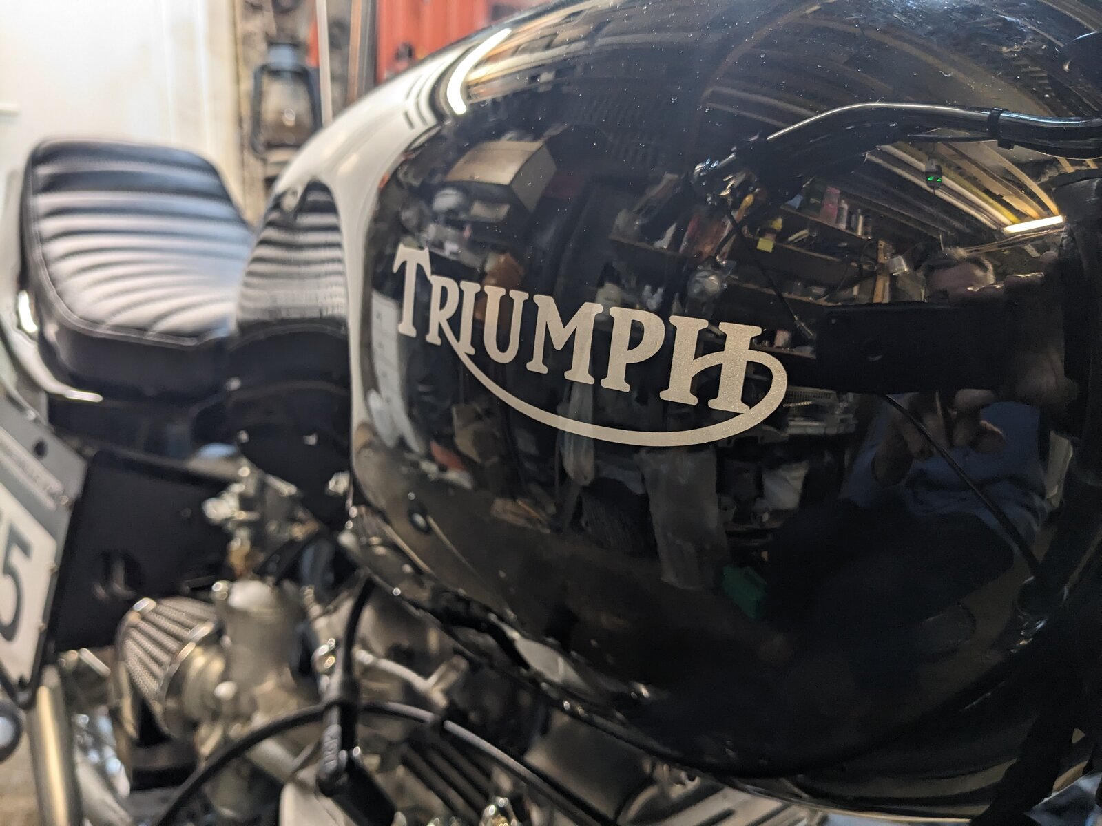

    Here's a teaser pic anyway :)
  2. That looks gorgeous. I’m well jell already.

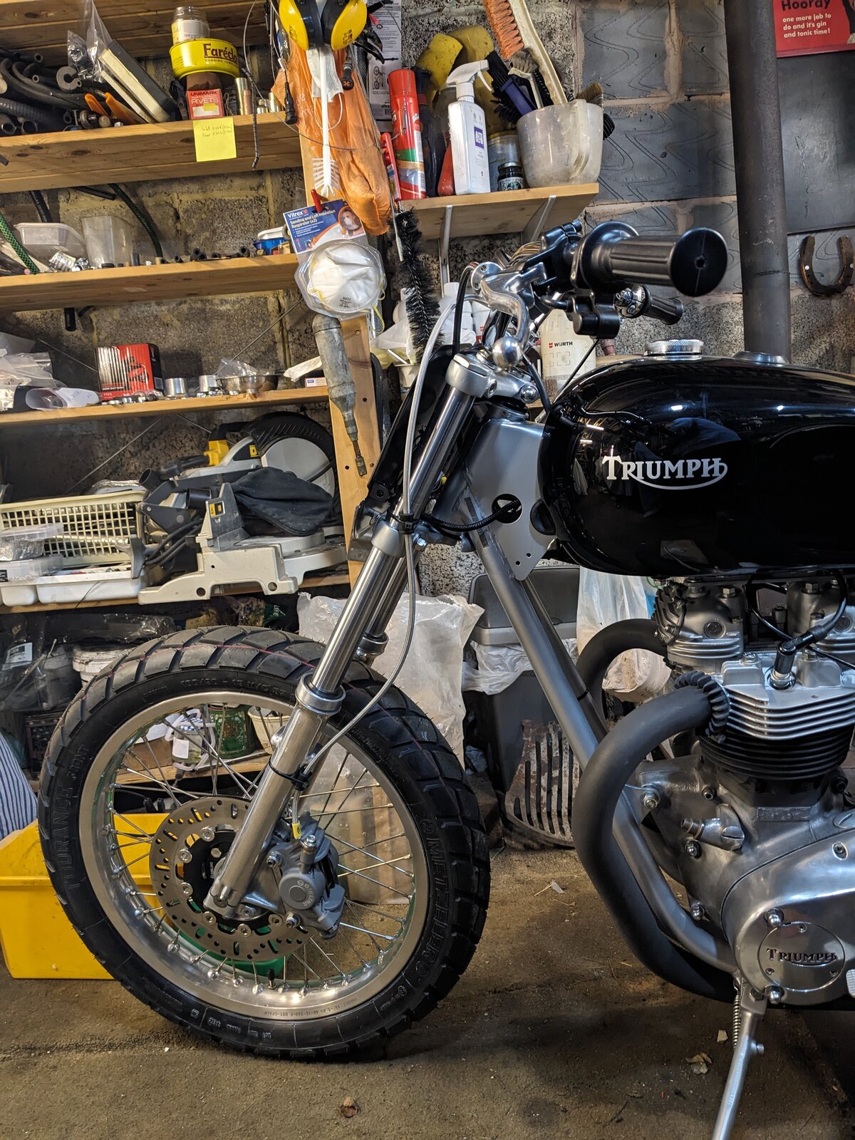

    Meanwhile, here's another teaser...
  4. Any more piccies?

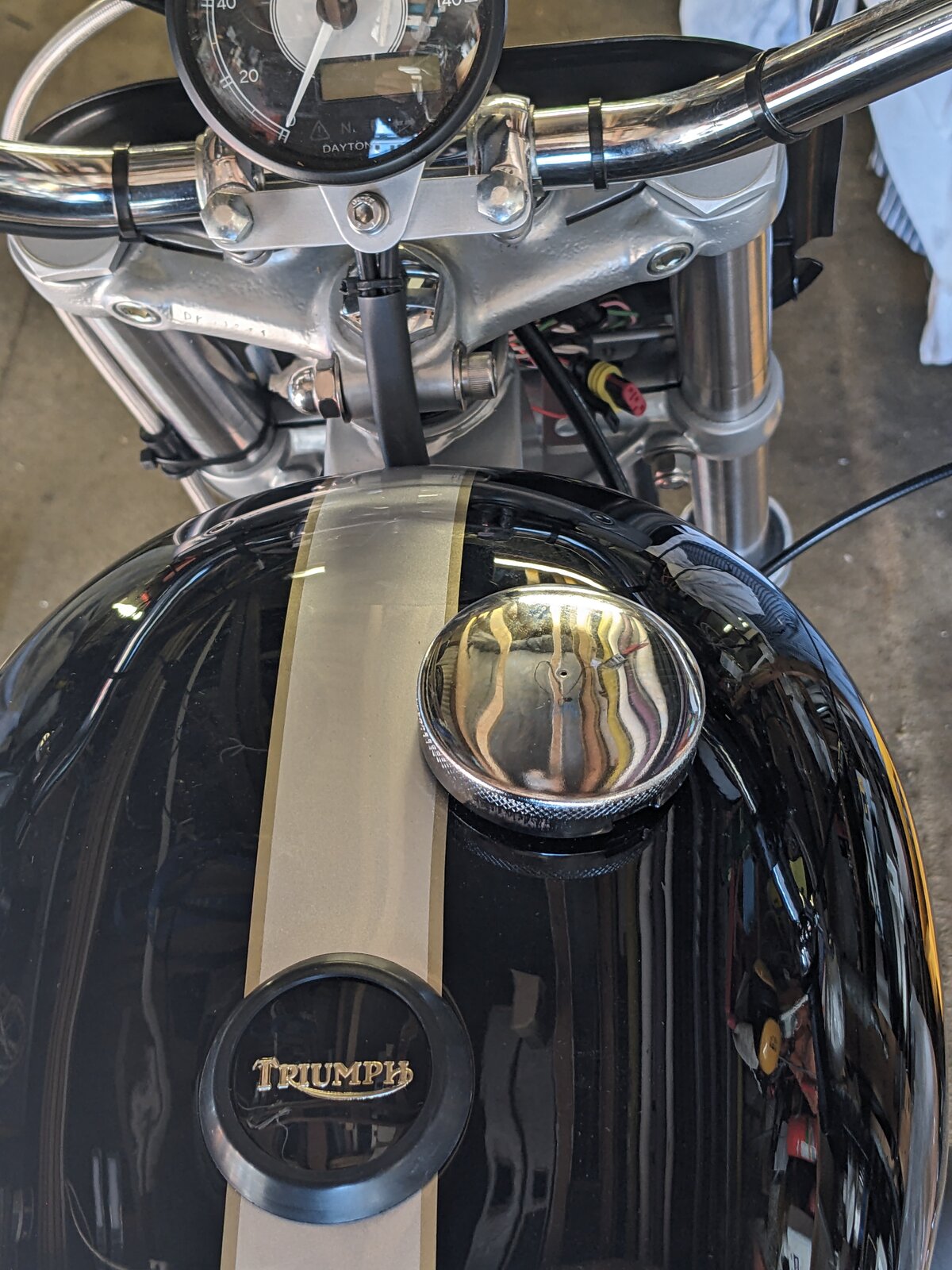

  5. Just a couple - I need to get it out into the sun and I can't get far enough away from it in my messy garage... The white vinyl my mate used for the numbers is a bit 'strong' - dunno...:thinkingface:
  6. Unfortunately vinyl tend to be Whiter than paint White.
    There is a supplier in Lichfield that does a more Ivory looking White or at least did do when I had a signage company. I’ll take a look see later to see if they still stock it.

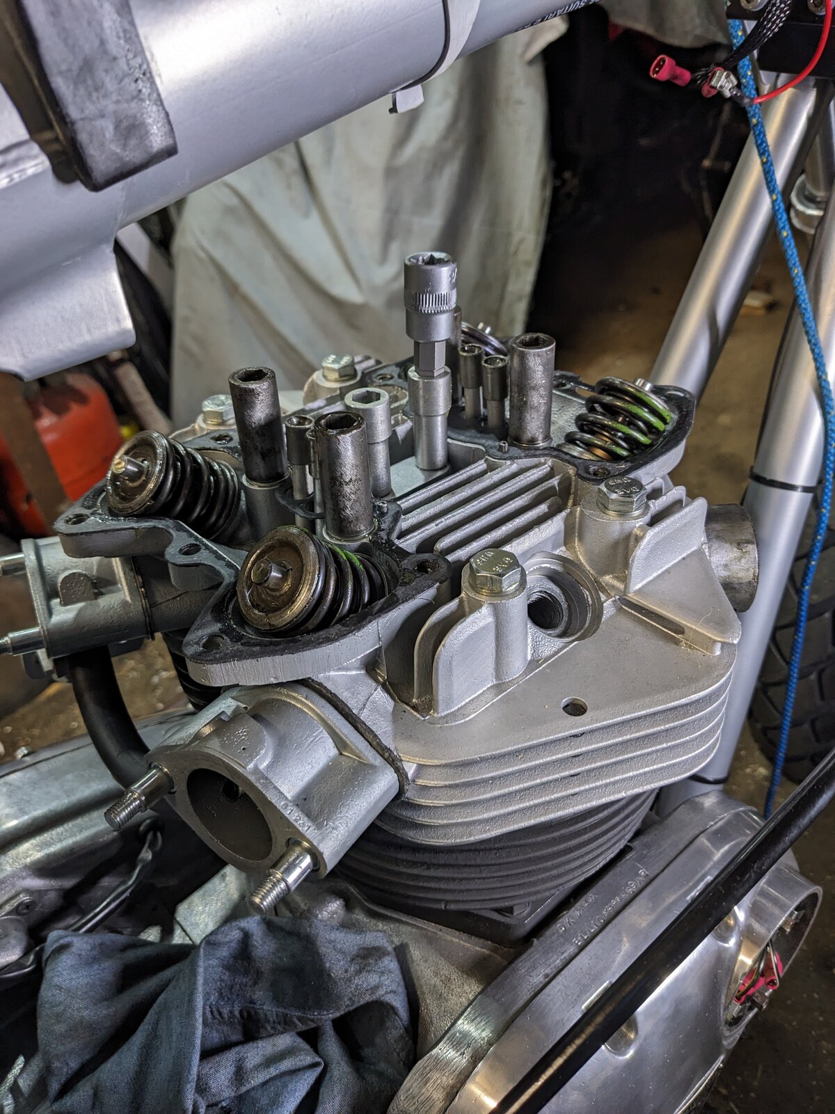

  15. I should have checked this sooner (resorted to a cheap Chinese Amazon compression gauge)... Low compression on one cylinder :( The new carbs are now delivering fuel where the old ones weren't, so they weren't a waste of money...
    Oh well, it gives me something to do and, being all 'new', isn't the messy chore it could have been...:upyeah:

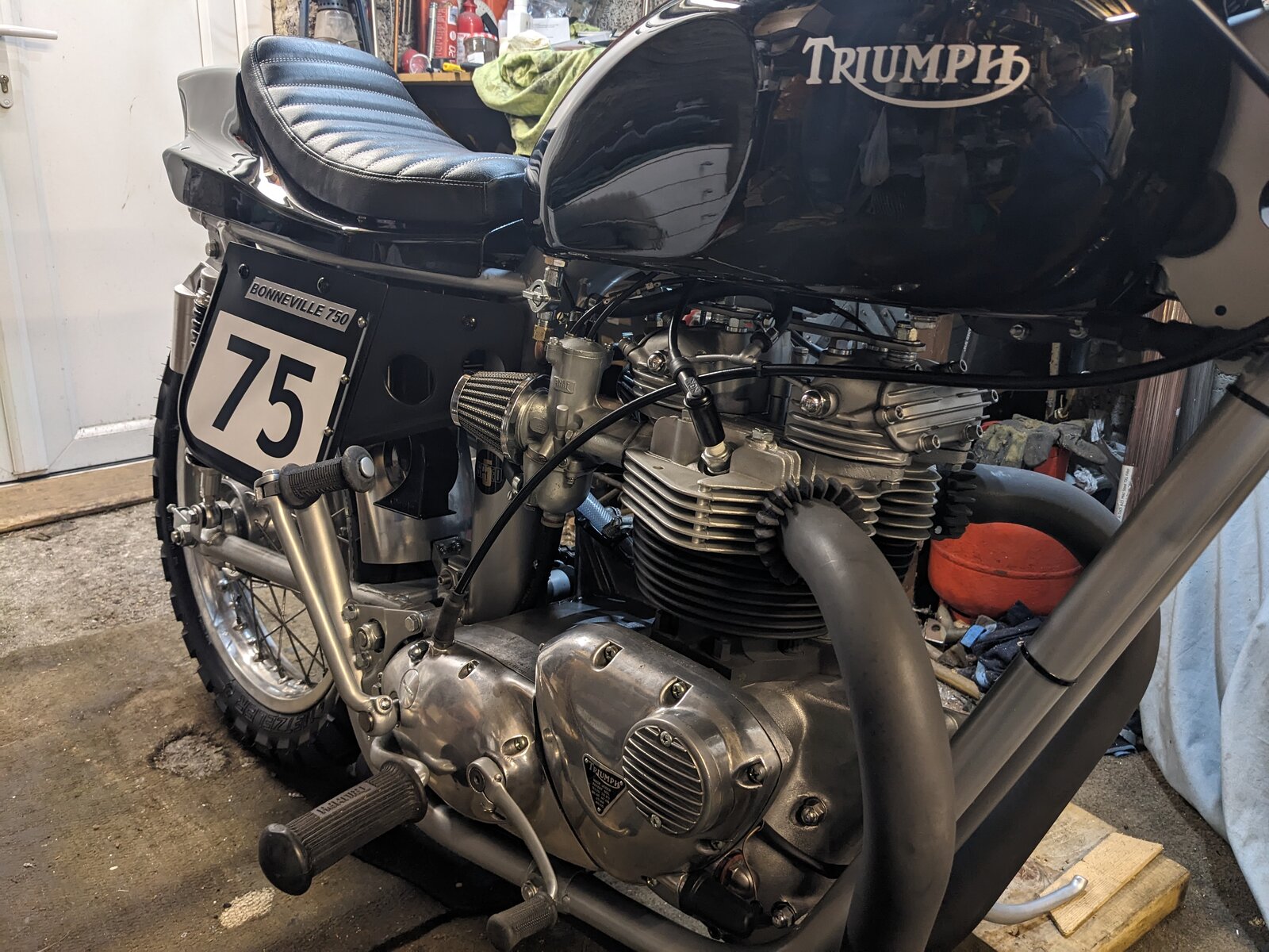

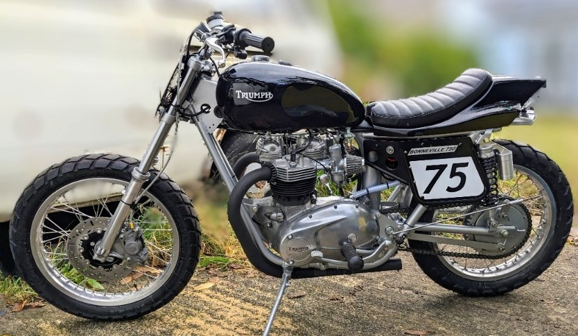

  16. Running beautifully now, sounding perfect :) I'd messed up the exhaust valve timing (brainfart but no piston collisions!). The new pair of carbs certainly help the idle and crisp uptake. New registration with an age-appropriate plate are now, hopefully, only a few weeks away...

  18. I’m even more well jell now it’s finished and running. Looks ace as they say back in the 70’s.
    Like that you’ve put flat track tyres on too.
    I’m sure that you could race that in the upcoming flat track Summer season.
    If you’re a little rusty you could have a day at Pete Boasts flat track school near Lincoln.
  19. I didn't want to spend 2 x price (US postage cost) for the real-deal Dunlop K180 tyres, so I looked around and chose the Metzler Tourance as they do a (rare) 18" rear to match the 19" front. This bike is all for looks as I dreamed about in the mid 70s :)

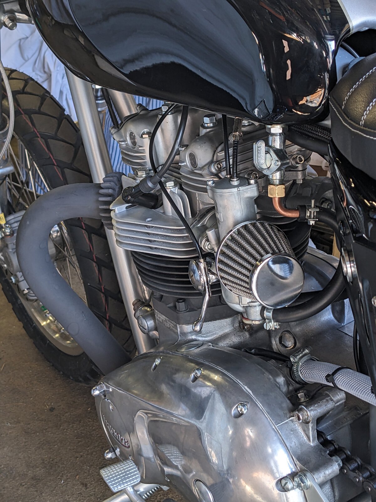

  20. I'm glad now that I went for the new (Amal Premier) carbs as the idle and response is so crisp. I keep telling myself that, if it ran at all, it'd be running badly as they were so blocked and worn. Only a teeny bit of man maths there;)
