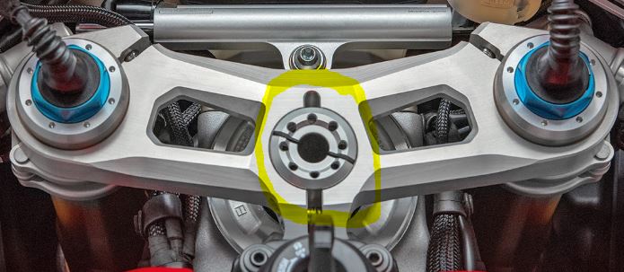

I need a little help.. Can anyone tell me if the steering stem nut on the top yoke on a 1299S is the same as the V4S? Need to buy a tool and not many list the V4 and some say the early Panigale will and others say NO.. Many Thanks AJL227

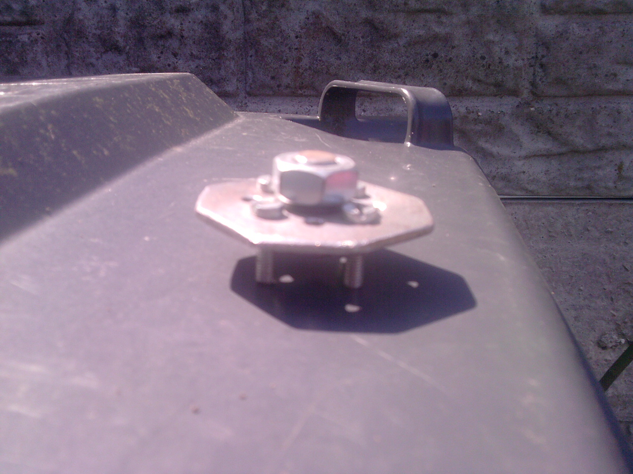

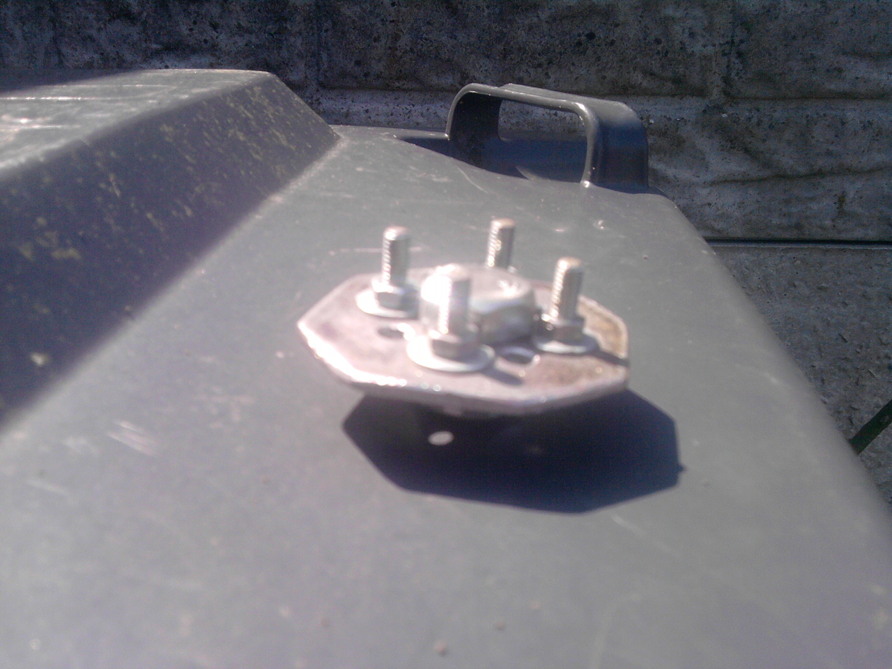

How about this ? Knocked it up in my shed .... been using it for 20 years . Or in the spirit of Blue Peter .... " Here's one I made earlier " [ To comply with forum policy , I took the photo on a bin ] Might be a good topic for a new thread .... " Home made Ducati tools " I must have made a dozen or so different tools , and saved well over a grand .
AFAIK the pitch and arrangement between the holes is slightly different on the 1199/1299 compared to the V4. The nut on the V4 is also marginally taller. If you want to buy a good quality tool that wont mark the aluminium (particularly when tightening anodised aftermarket steering stem nuts) then I cannot recommend these highly enough: https://www.desmoworld.com/desmowor...die-lenkkopfmutter-der-panigale-v4-1807?c=873
