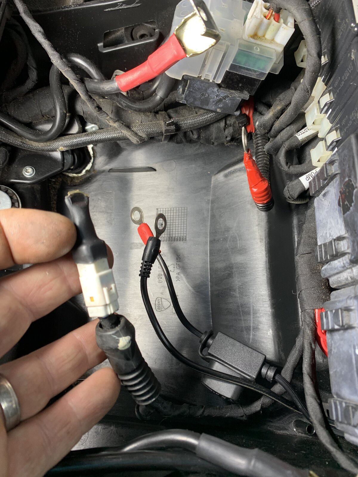

  1. Hi folks.
    Trying to understand what this connector is for under the seat of my new to me 2016 MTS 1200S DVT. Its nestled on the LH side of the battery and I only spotted it once I'd taken the battery out for a clean up.
    Can anyone help to identify what it'd be for and whether it's for an accessory please ?
    Fanku in advance.
    Rich.

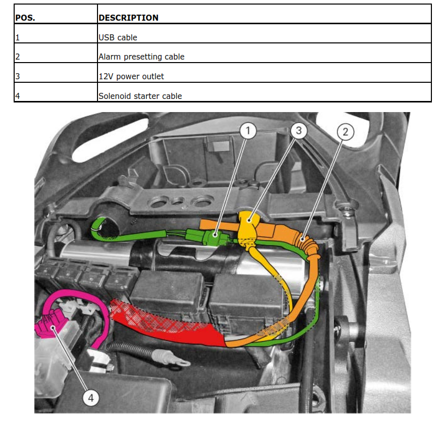

  2. Think its the connector for the Ducati alarm
  3. I'd say your correct:
  4. Thanks guys. Looks defo like No 2 alarm cable. That'd make sense. Thank you.
  5. I can confirm that it is the alarm connector, Have mine plugged into one and it make a noise if I try and move it when armed :D
  6. Thank you. Much appreciated.
