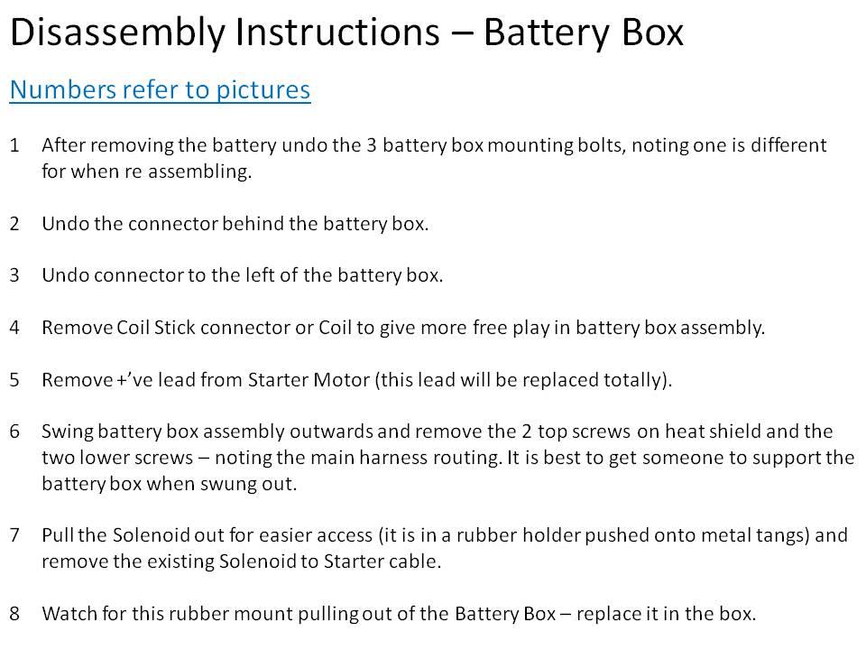

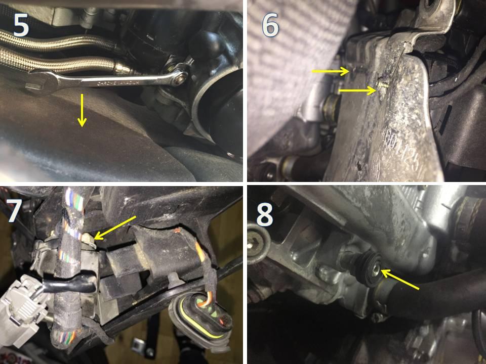

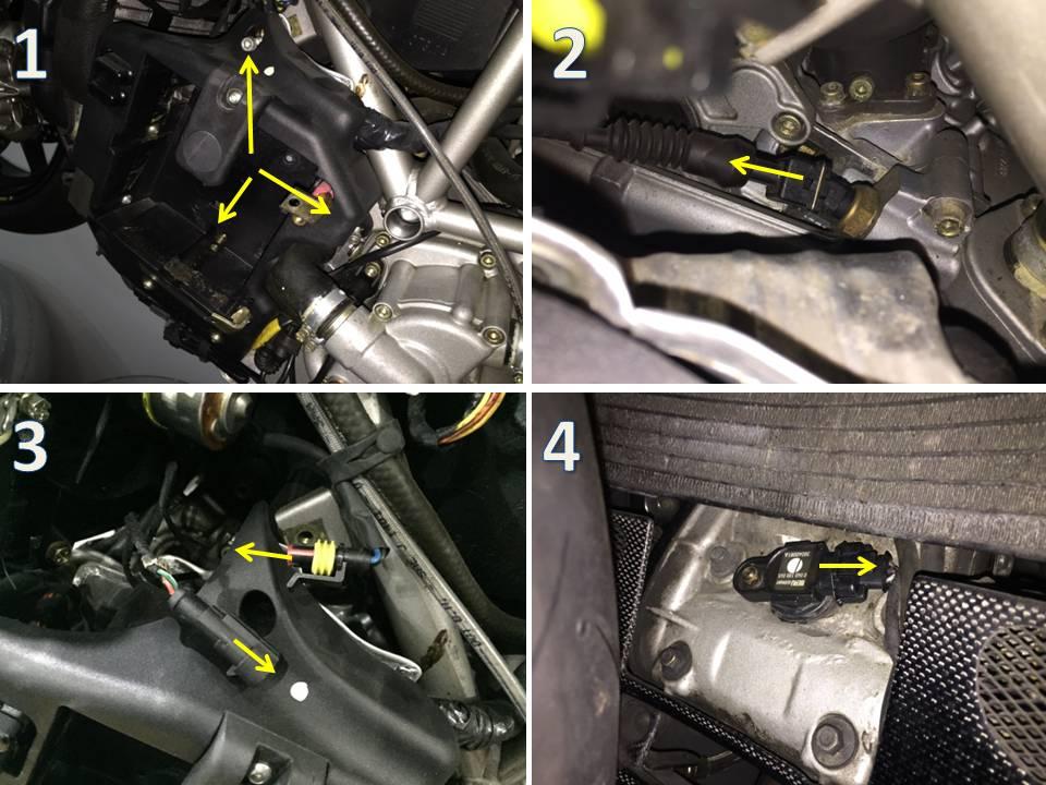

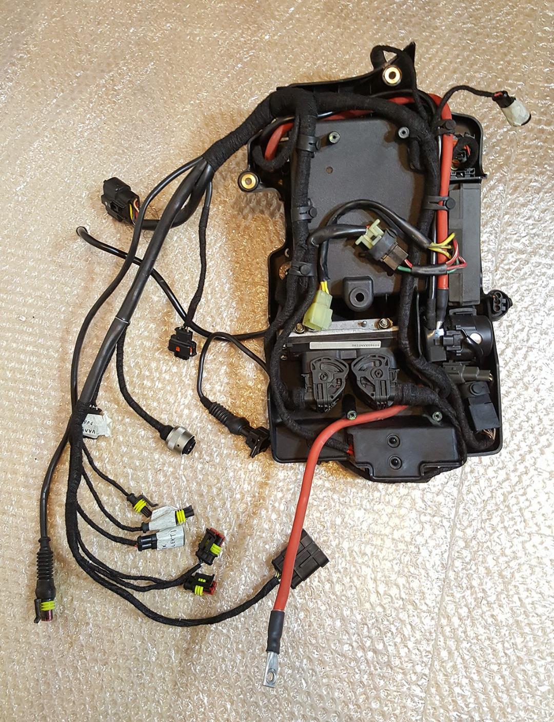

    SO now I am trying to work out how ti put it all back together, it looks like the heat shield screws onto the back of the battery box?

  4. Welcome, yes the heat shield has 4 tint self tappers that screw to the back of the battery box - the heads go through the shield if you are not careful, which is why I supply 4 washers with my cable kits :innocent: one of the washers is bent due to the location and profile of the shield.
  5. Although these instructions are for my lovely cable kits www.exact-start.com (forum subscriber discount available) they will help you get the battery box re connected even if you decide not to fit one :) The last picture shows the box assembly from behind...
