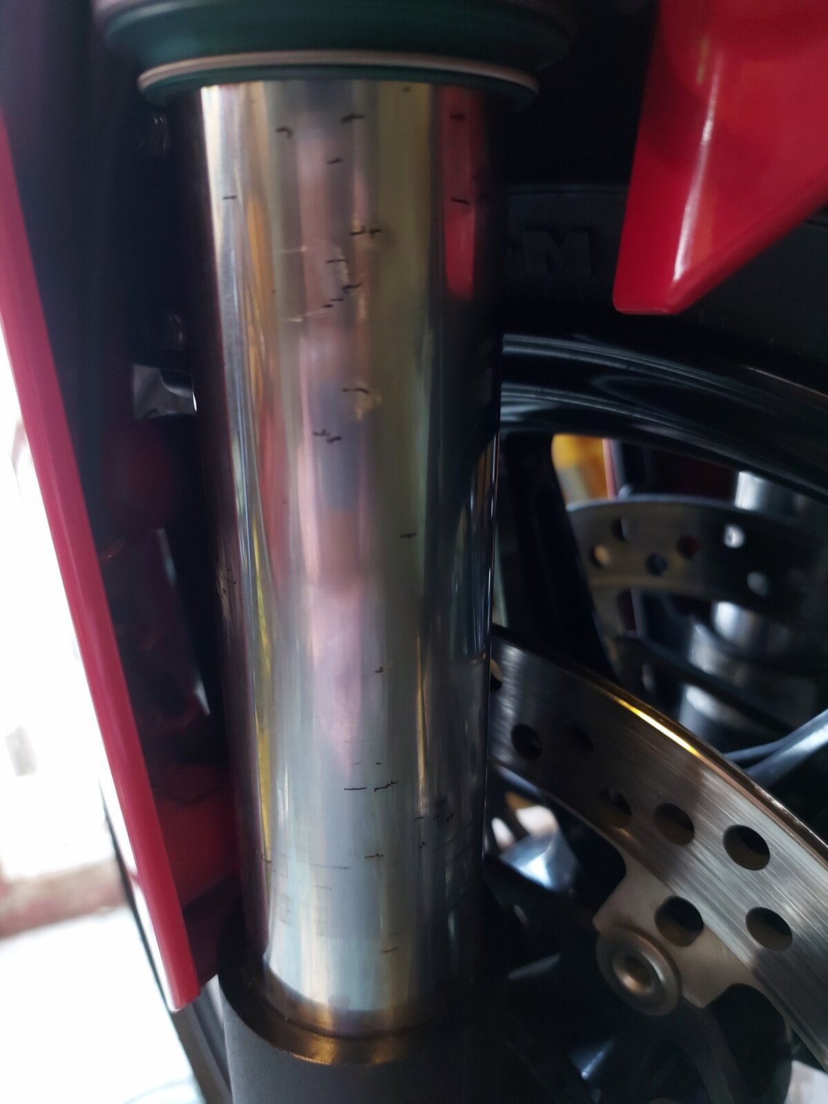

  4. Chrome on stanchions was flaking away on the electronic side. Had a new one fitted. Doesn't feel right. Right hand stanchion chrome chipped. 01.jpg
  5. Might they have been straightened? Does the bike have an insurance damage category on record?

    The stanchion was straight. The chrome was peeling off which cut the fork seals. Never seen this before. Bike has no recorded damage. A definate manufacture fault.

  8. Possibility of having it ground and replated?
