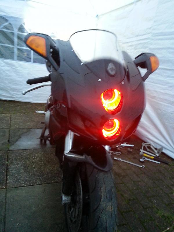

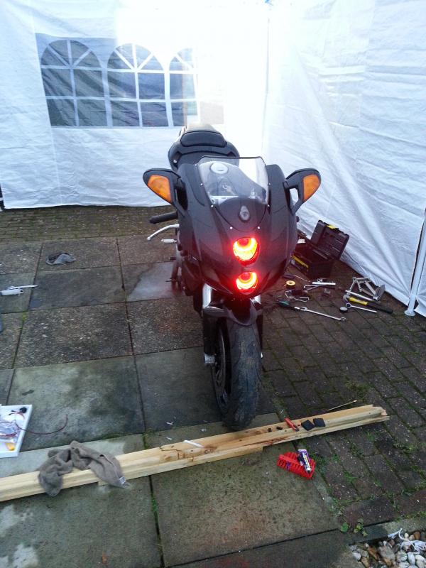

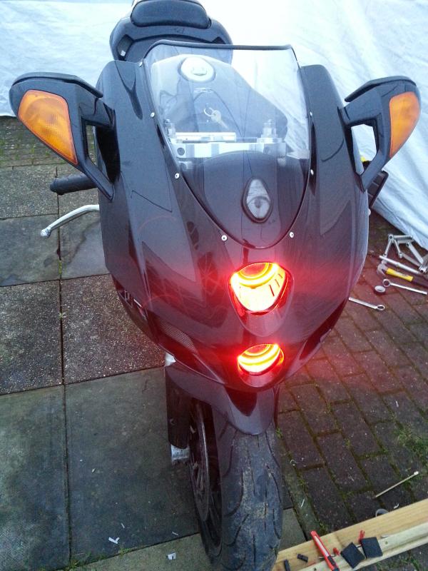

    Anyways, I have installed 2 red halos around both lights, I have connected them to the front, quite useless, windshield light. They look really cool in my opinion! and as they're connected to the same wiring as the little windshield light, when i put parking lights on only those are on in the front and look really good!
    I have went to play with the headlights, which turned out a chore and a half, as they're so built in and very little room to play with.
    Originally I wanted to replace both top and bottom lights with HID ones, and rewire to have both on all the time.
    Couple of issues:
    * the HID kit i got, was one of the smallest ones they had as far as ballasts and all, but it was not made for my bike in particular. I didn't think this would be a problem... but couple of things came up:
    1. obviously the mounting for the bulbs didn't fit, but that's nothing some plastic and screws cannot fix :)
    I mounted the bottom one fine, the top one however turns out the HID bulbs have quite a large fitting behind them... which meant that when i installed the top one the clock (tacometer) didn't want to go back in... soooo after thinking about it for quite some time, i decided lets just do the bottom one, as that's the one that's on all the time and not rewire them.
    Done that. 2nd issue came up. Turns out that the HID bulbs seem to be made to light sideways, meaning that when you install them into the headlight you're meant to have them mounted pointing to the side not pointing forward. I have looked up online and it does not state that's the case, however that seems to be the case.. I thought the reflective insides of the headlight should be sufficient to whatever way the bulb is facing, reflect the light forward. Apparently that's not the case, meaning that i'm actually at the moment having, what seems like, less light than i did with the standard halogen light bulb... it still looks nice as the light is pure white and the red halo around it looks really good, but i'm going to have to think about what I can do to get more light out of the bulb.
    Interestingly the bulbs are bi-xenon, meaning that they have low and high beams installed in each bulb.
    The way it works, which is interesting, is that there is a seperate mechanism in each bulb which sucks the bulb in with a magnet, causing less light to come out of it. I'm thinking that I can maybe permanently put it to high beam in the low beam light, causing more light to come out, but as it's not reflected properly it'll look more like low beam... something to think about.
    I have all the side red LEDs which i'm going to install to have a glow from under the side fairings and over top of the wheels, but i've been so consumed with the headlights that i have not installed those yet.
    Any suggestions? I'm not an expert by any means on lighting, maybe there is something i'm missing here...
    Anyways here are some pictures of what the 2 halo's look like, let me know what you think :)
    the halo's look a bit orange here, but in reality they are pure red

  6. ha... i need to get a new windshield for the bike without the little light on it :)
  7. Why have you put red lights on the FRONT of your bike ?
  8. These are not lights per say they are just accent lighting. A halo around the lights. In actuality you cannot see them light up anything just see them when looking at the front of the Bike. When the lights are on the light in front of you is just white you can't se. The red again unless you look at the front of the Bike.
    A's I said to each their own but I think this looks great!
  9. Good idea any extra lights, but wouldn't having red lights on the front be miss leading to oncoming traffic as they would thing they are tail lights? Wondered why you didn't go with white Halo's?
  10. Since the 999 has the low beam always on when the light is on you cannot see the red light as distinctively but just see a red circle around the light . Plus white is boring. The red will match the accent red logging I'm going to put on the sides
