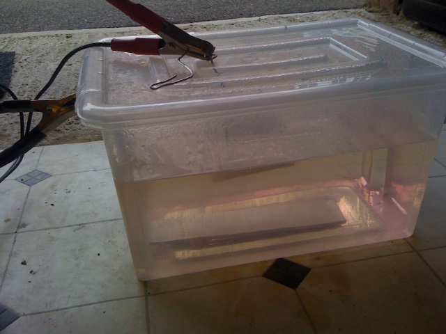

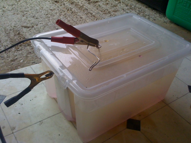

  2. Yes. It's very easy to do and quite cheap BUT getting decent, consistent results is the problem.
    You can put a kit together for about £25-£30 using common off-the-shelf materials.
    For cleaning parts you need caustic soda which is available in the pound shop.
    For the anodising you can use drain cleaner as your source of acid.
    One Shot is 91% sulphuric acid, so you can adjust your bath numbers for this.
    You can use battery top-up water to complete your acid mix, and keep bicarb of soda handy (raid the wife's cooking cupboard) to neutralise any acid spills.
    You can use a lead cathode if you have some available (or can climb the local church roof) but I've used an aluminium cathode in the past with good results.
    Stick everything in a large plastic tub with a lid and hook it up to a constant 12v source.
    I've used an old PC power supply for this as I had one laying about and they're far more reliable than using an old battery or similar. They can also provide plenty of amps and are much cheaper than a dedicated bench power supply!
    The rest is a bit of simple calculation and experimentation.
    There's loads of excellent guides on the internet which will walk you through. Just google for "anodising home diy" or something and have a read.
    This one is pretty good, for example: Aluminum Anodizing at home - DIY aluminium Anodising

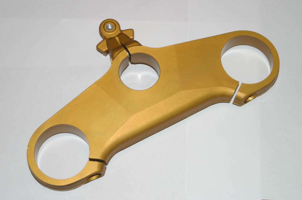

  7. Is that a DIY job?
  8. No a company local to me did it, I had a few things done in gold & black they all turned out good (can't really tell in that photo) but even they were a bit worried it could have turned out a shitty brown colour so it was at my risk. They're pretty high volume so just added them to the batches they were running.
  9. I'll echo antonye's comments, the site he recommended put me on the way.
    The old computer PSU route is good but I've actually had better results using a standard car battery charger.
    Use battery acid diluted to the correct strength as the electrolyte. Took a couple of goes to get the technique right but the great thing is if you stuff it up just put the part back in the caustic soda and have another go.
