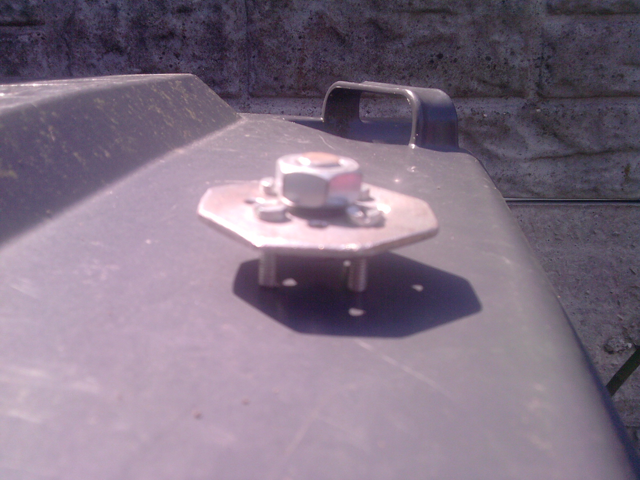

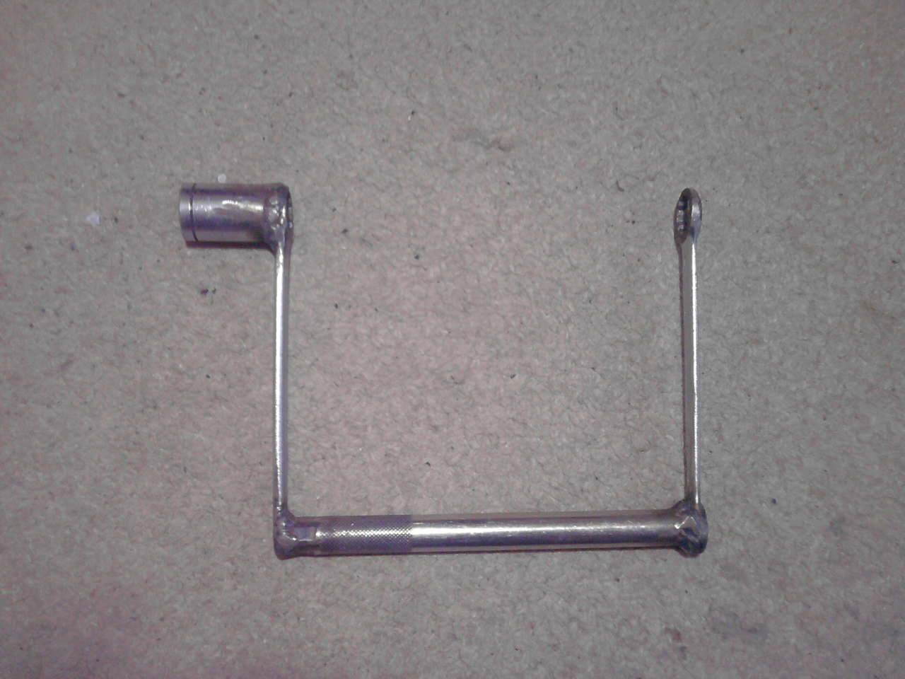

    I'll start with an ugly ..... and it's on top of a bin .

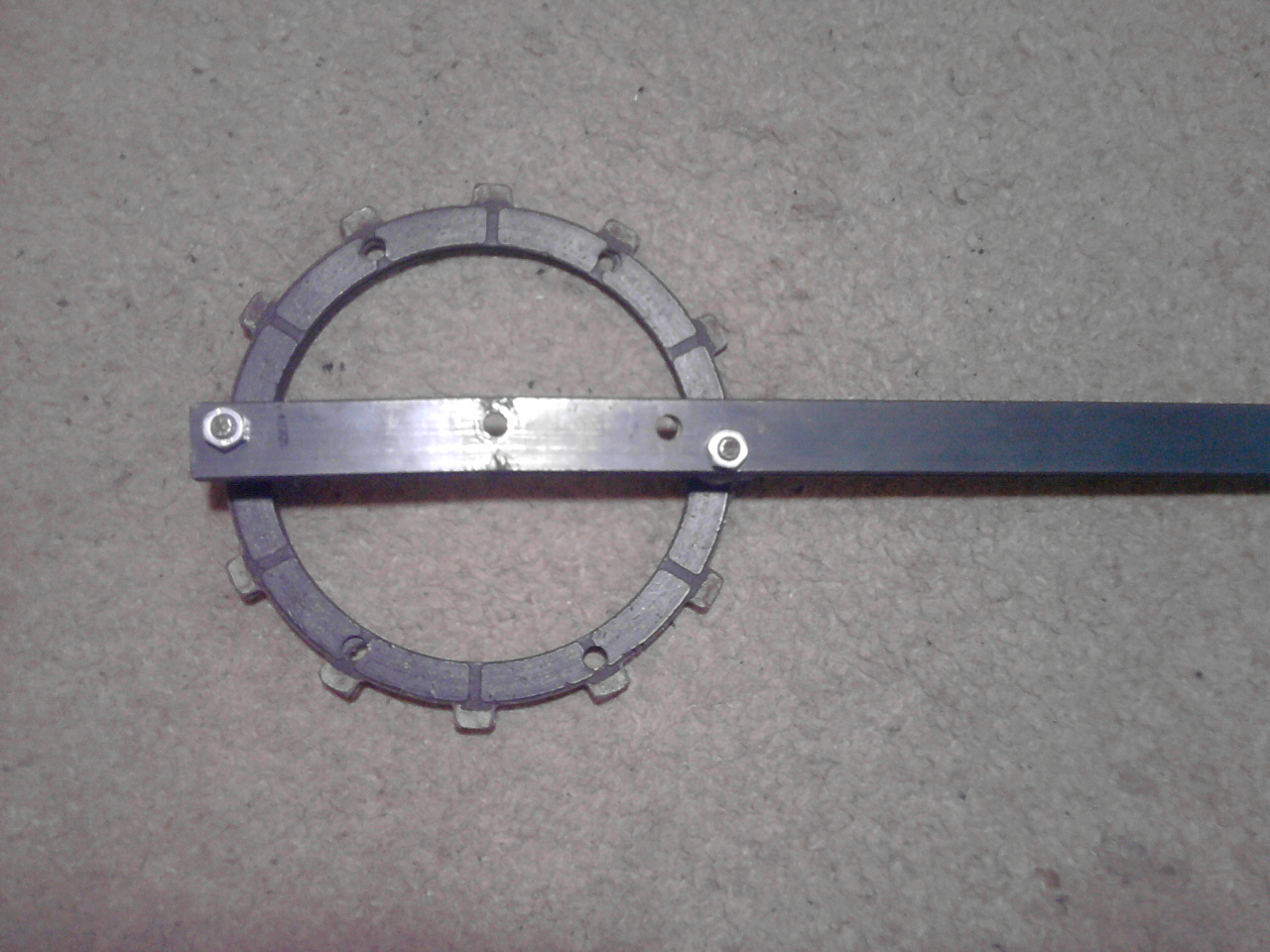

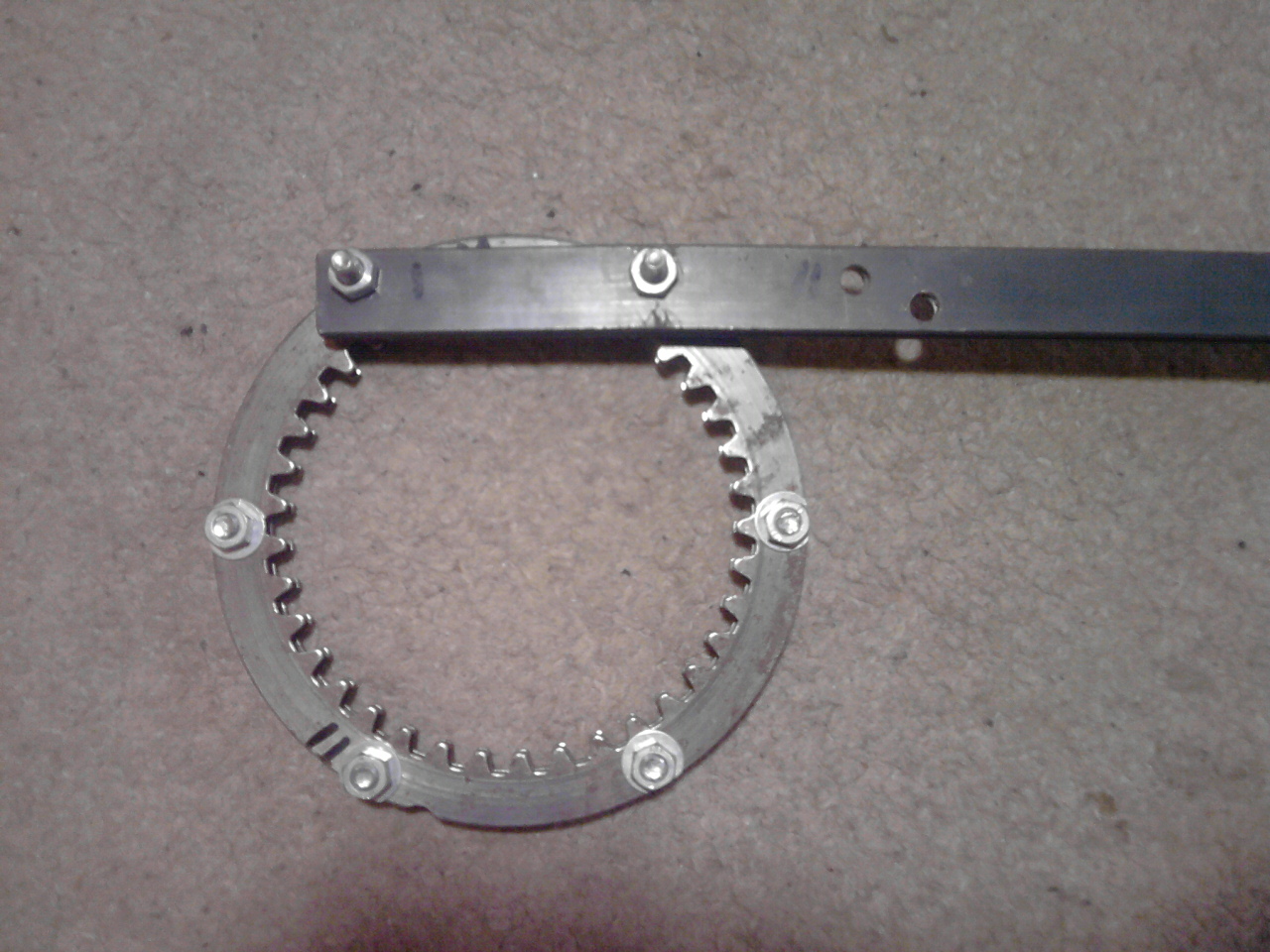

    Clutch holders

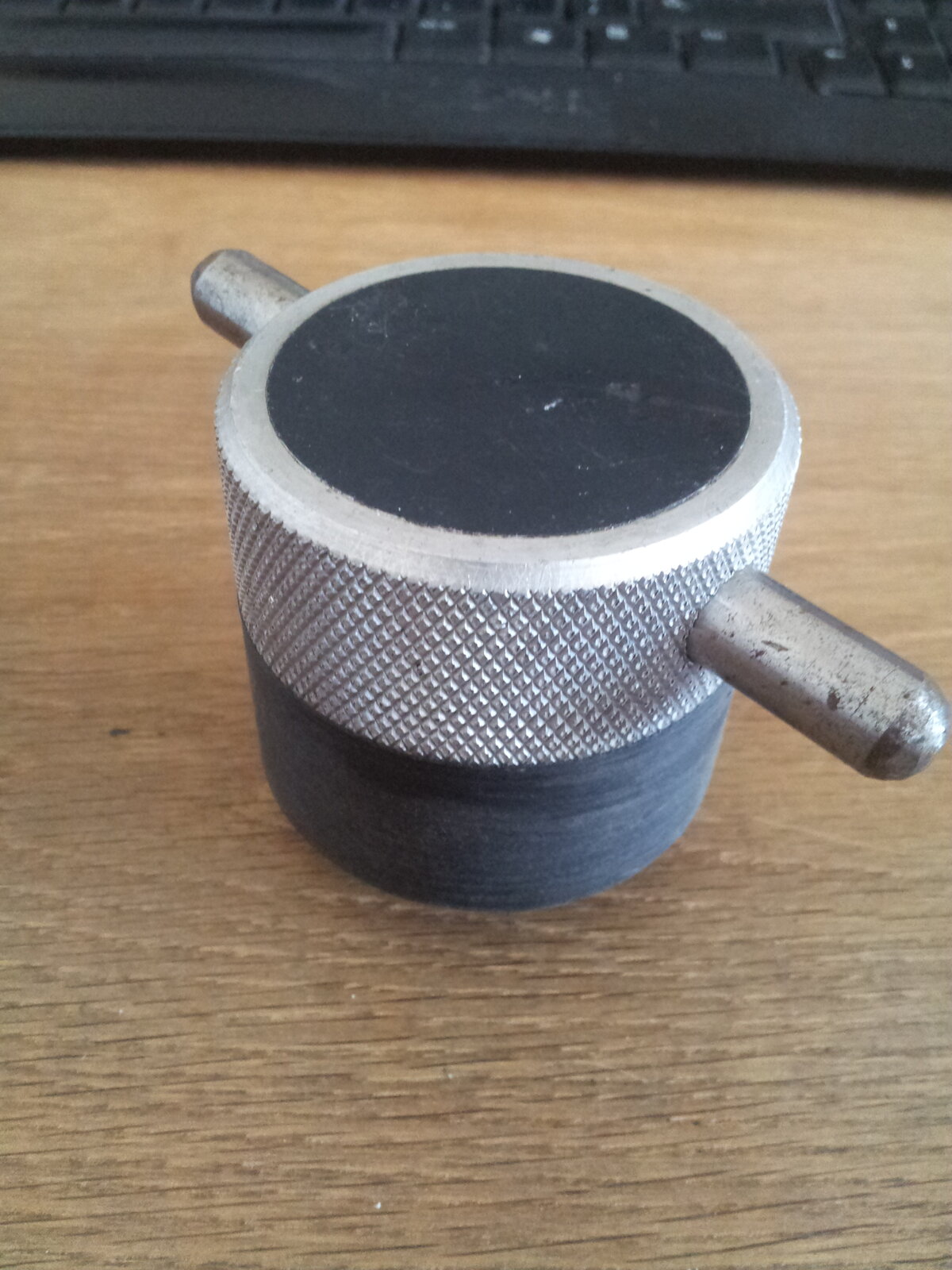

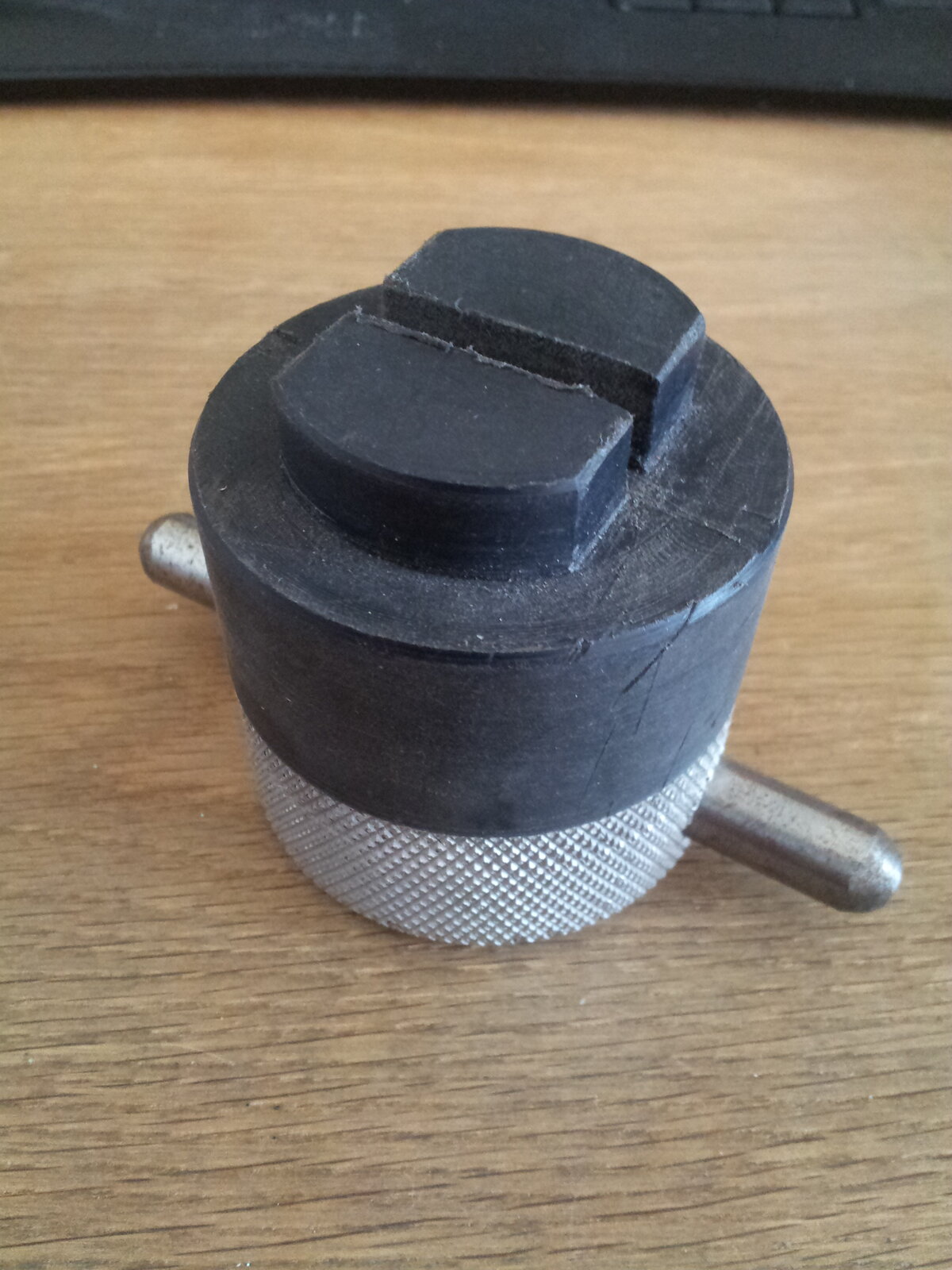

  2. RS fuel filler cap spanner.

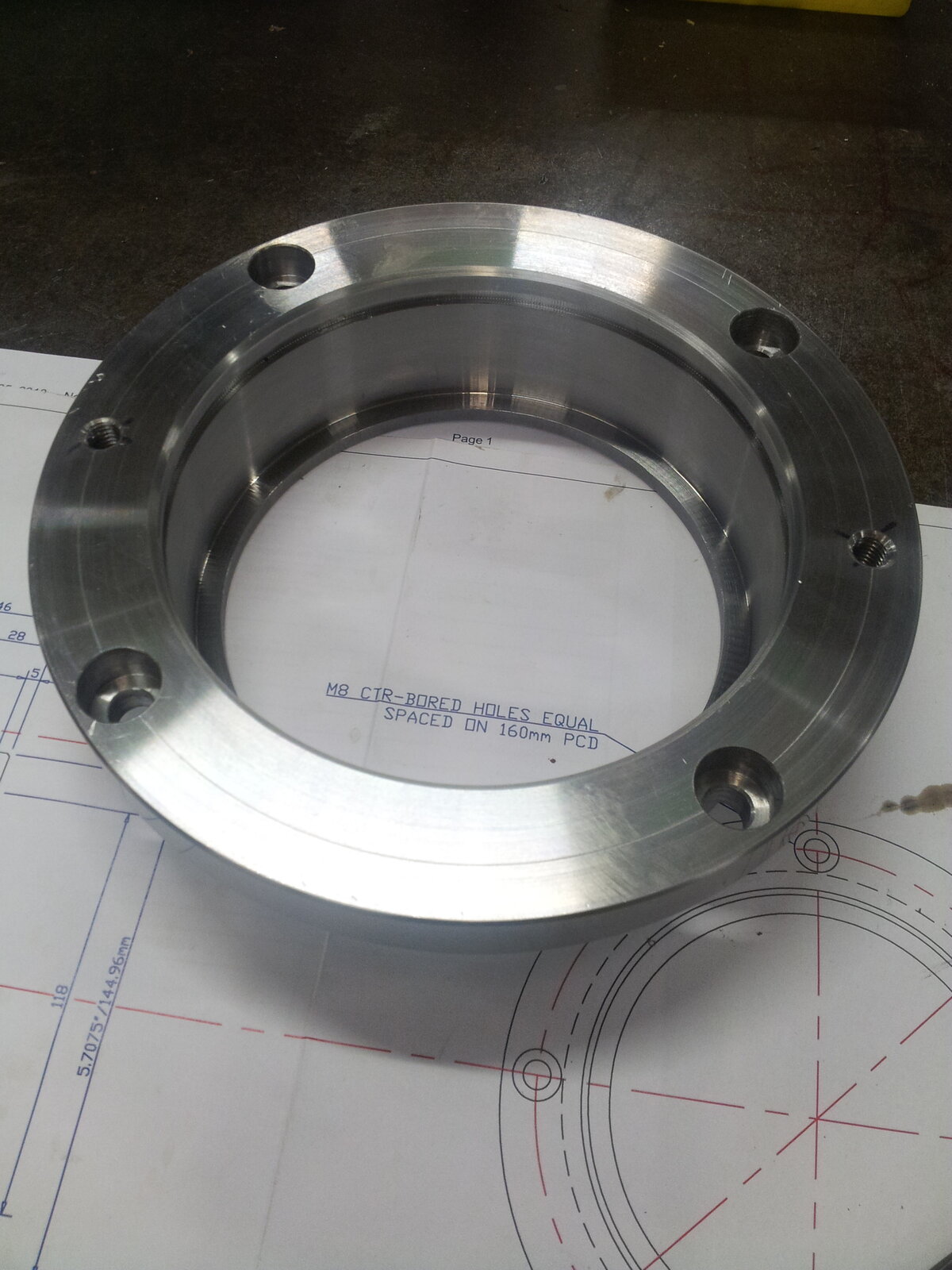

    As an aside, a bearing flange on a 50 year old lathe.

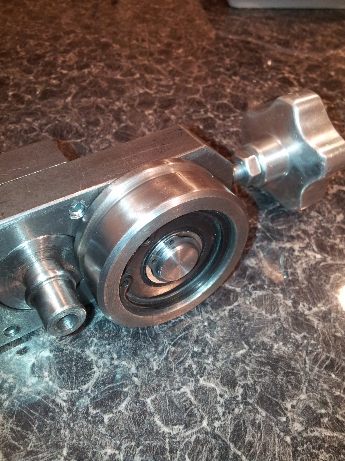

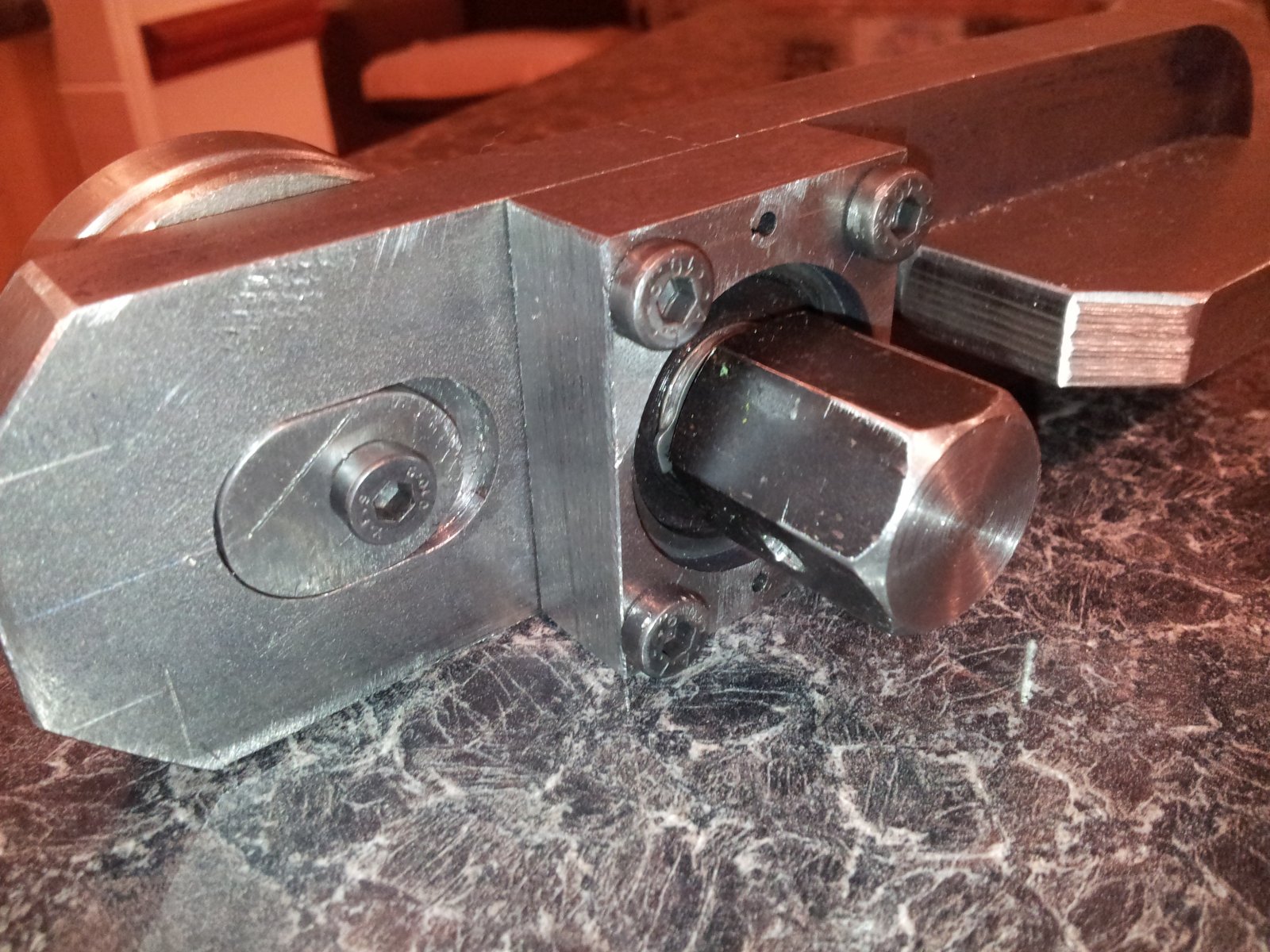

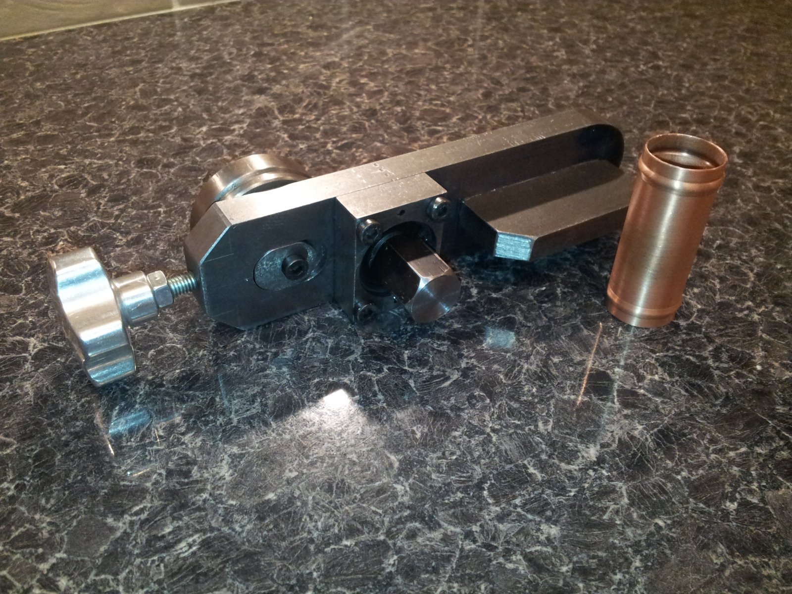

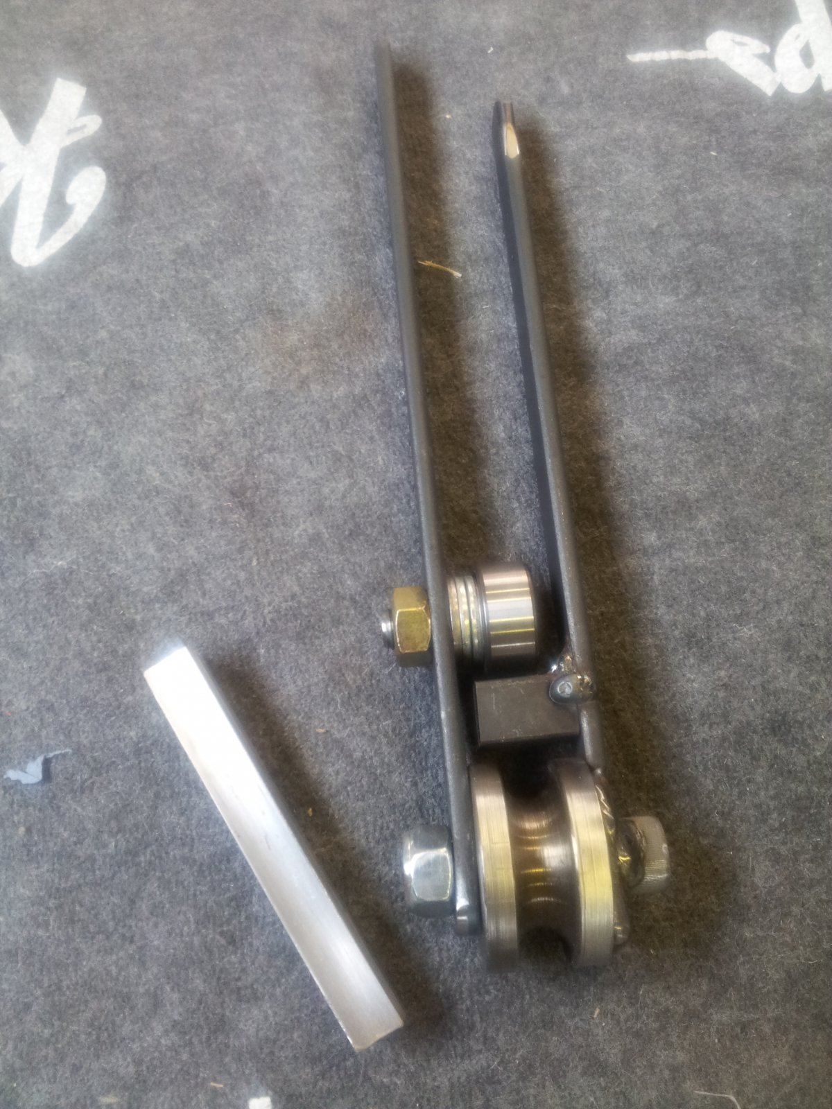

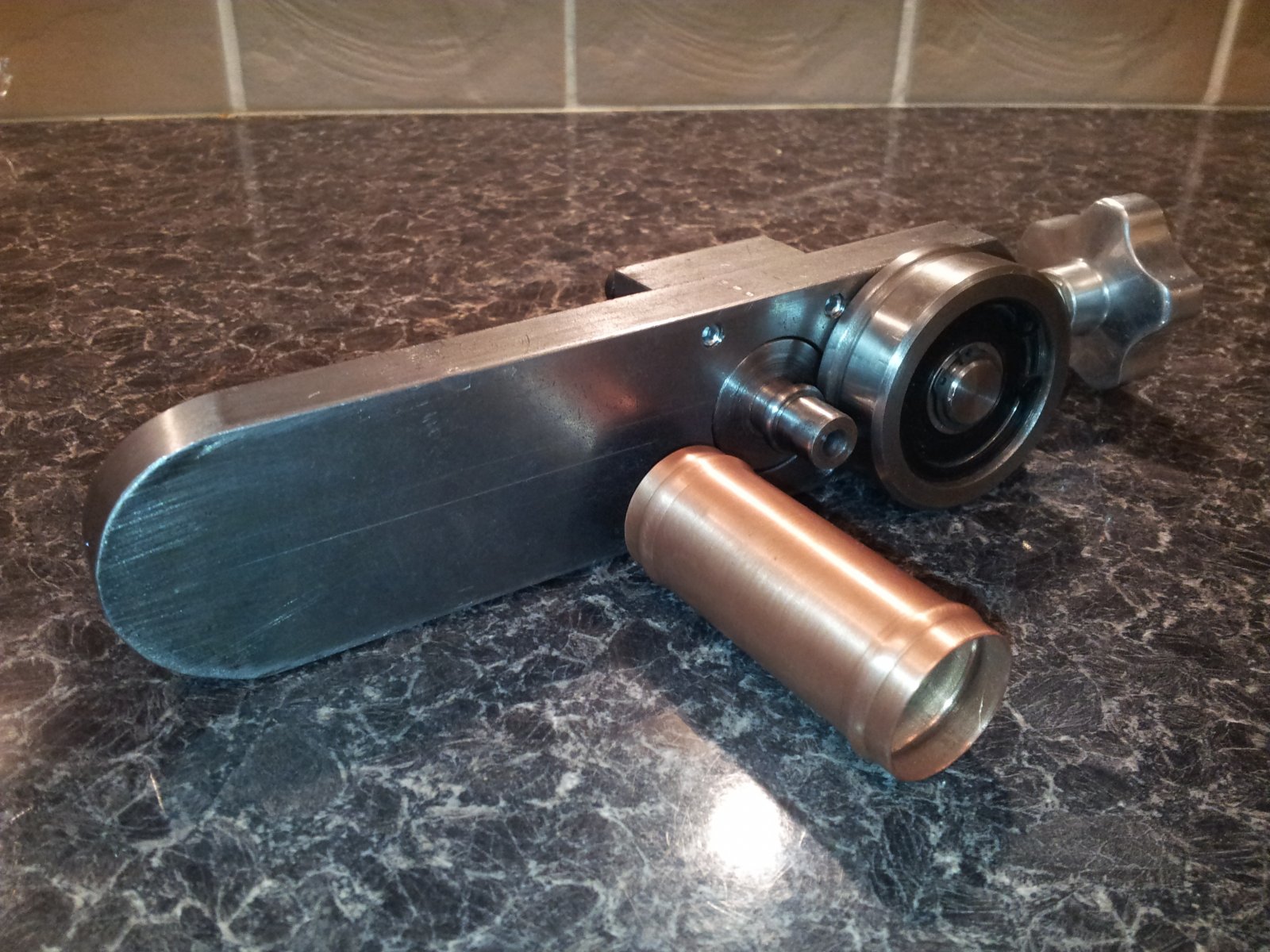

  3. Pipe bender for ally overflow pipe.
    Pipe swager tool, to stop hoses popping off coolant pipes.

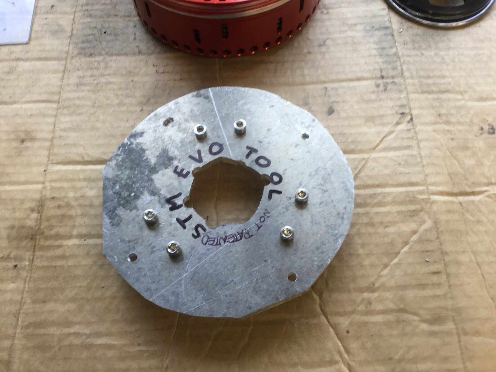

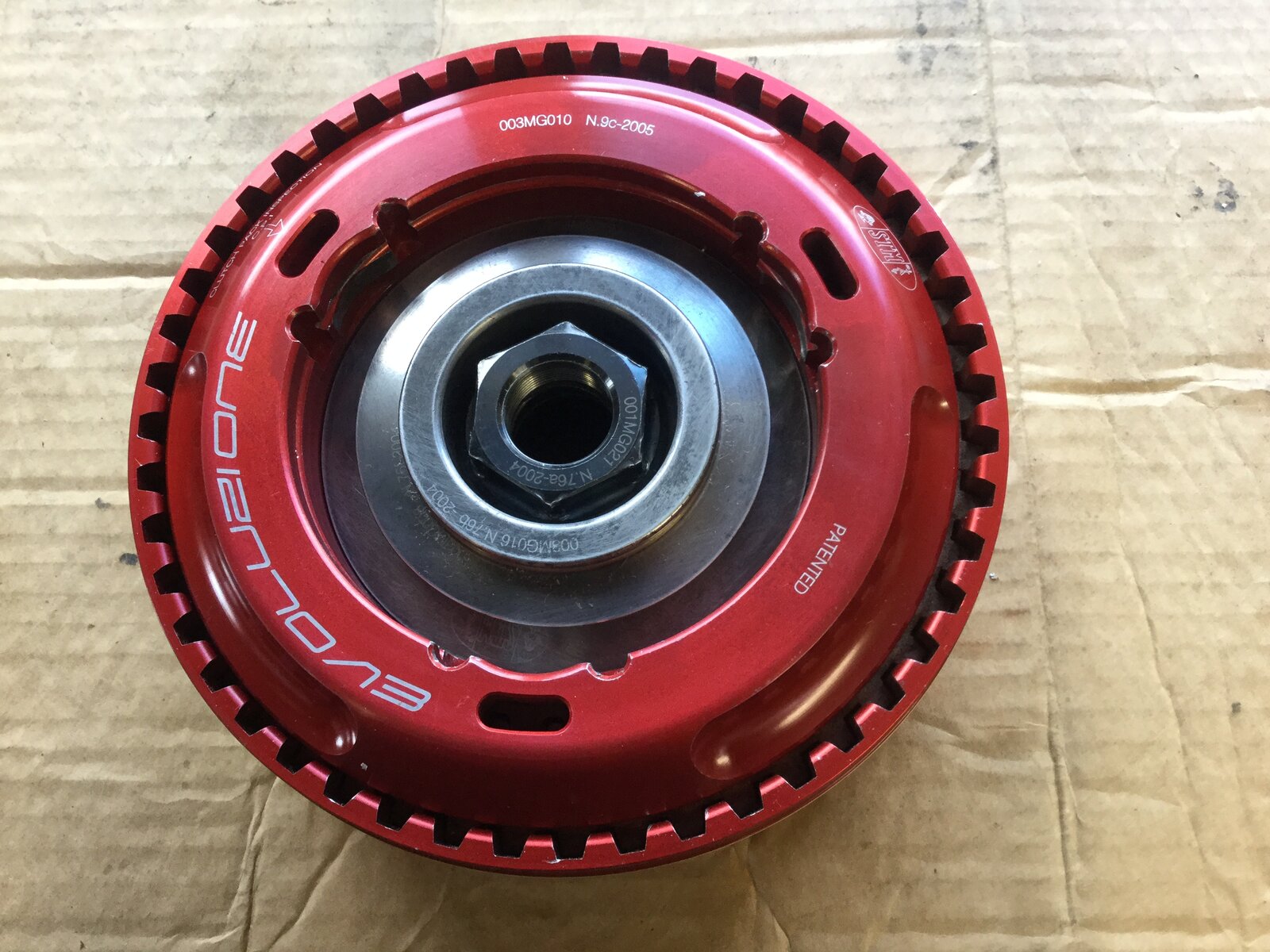

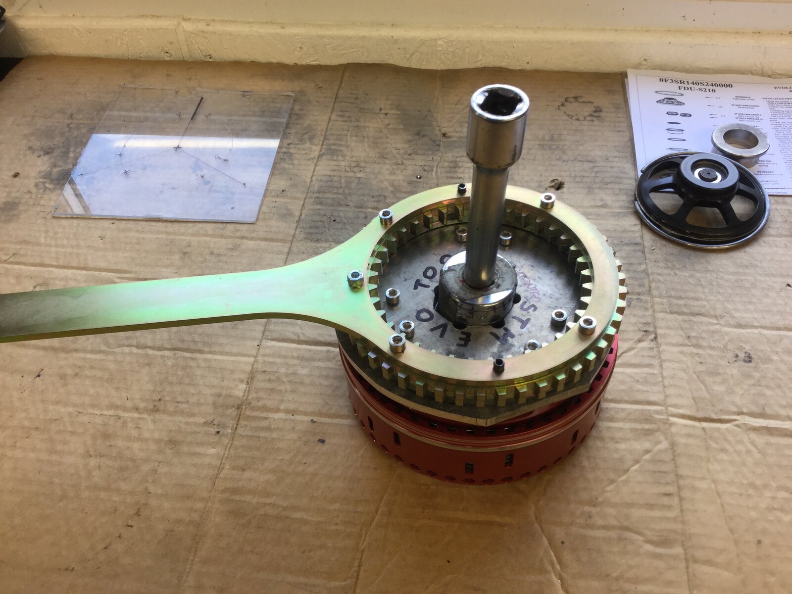

  4. STM Evo Clutch holding tool
    First pic: the problem - how to prevent the pressure plate rotating - STM tool engages with the 6 semi circular recesses in the plate.

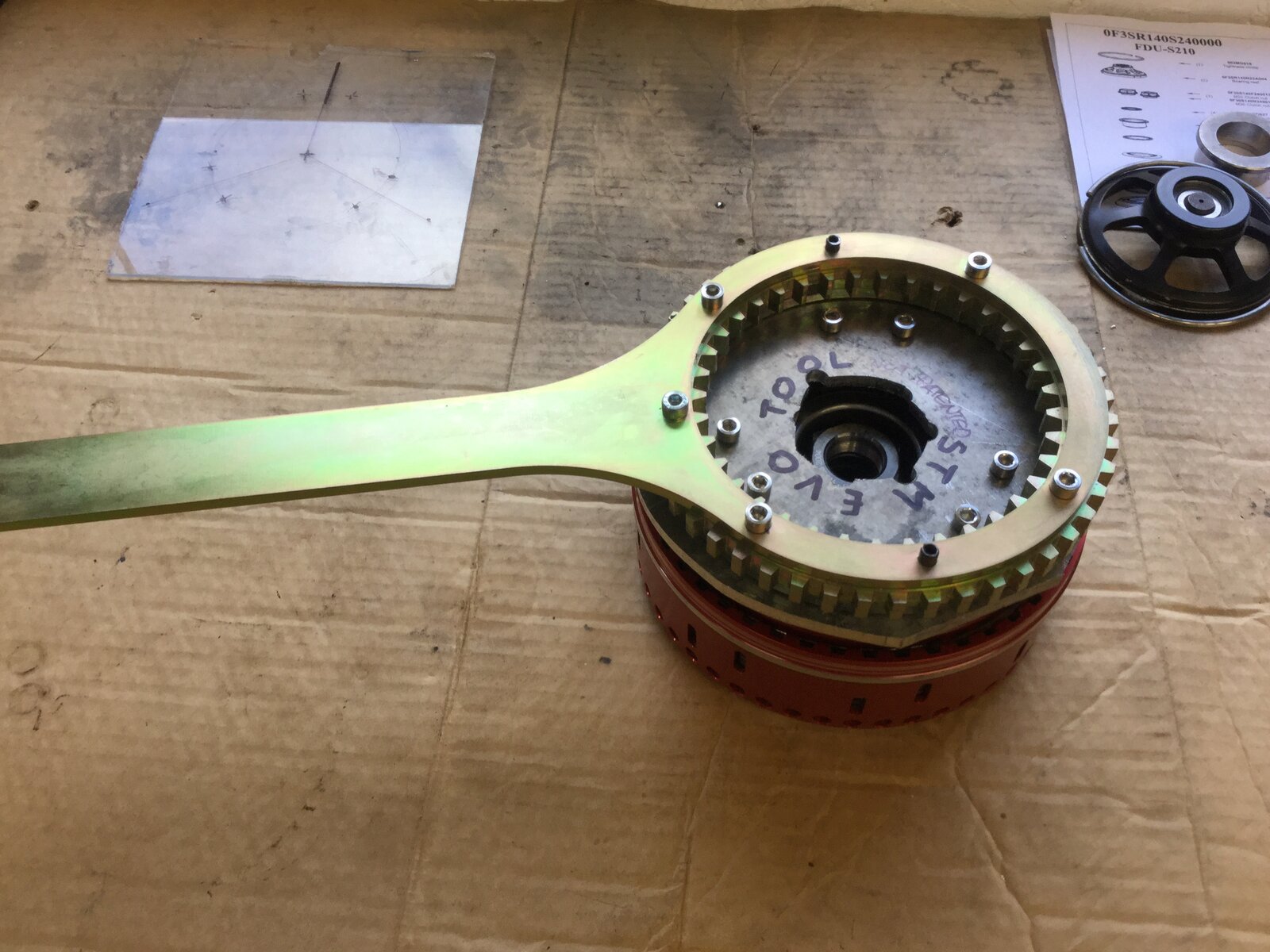

    Second pic: solution. Make a plate with bolts in it that align with the recesses. Gash chain drilled centre hole to allow 30mm socket to fit onto nut. In the background, you can see the Perspex template I made to transfer drill the holes to align with the clutch plate.
    Third pic: bolt plate to my 48t clutch holding tool
    Forth pic: viola!

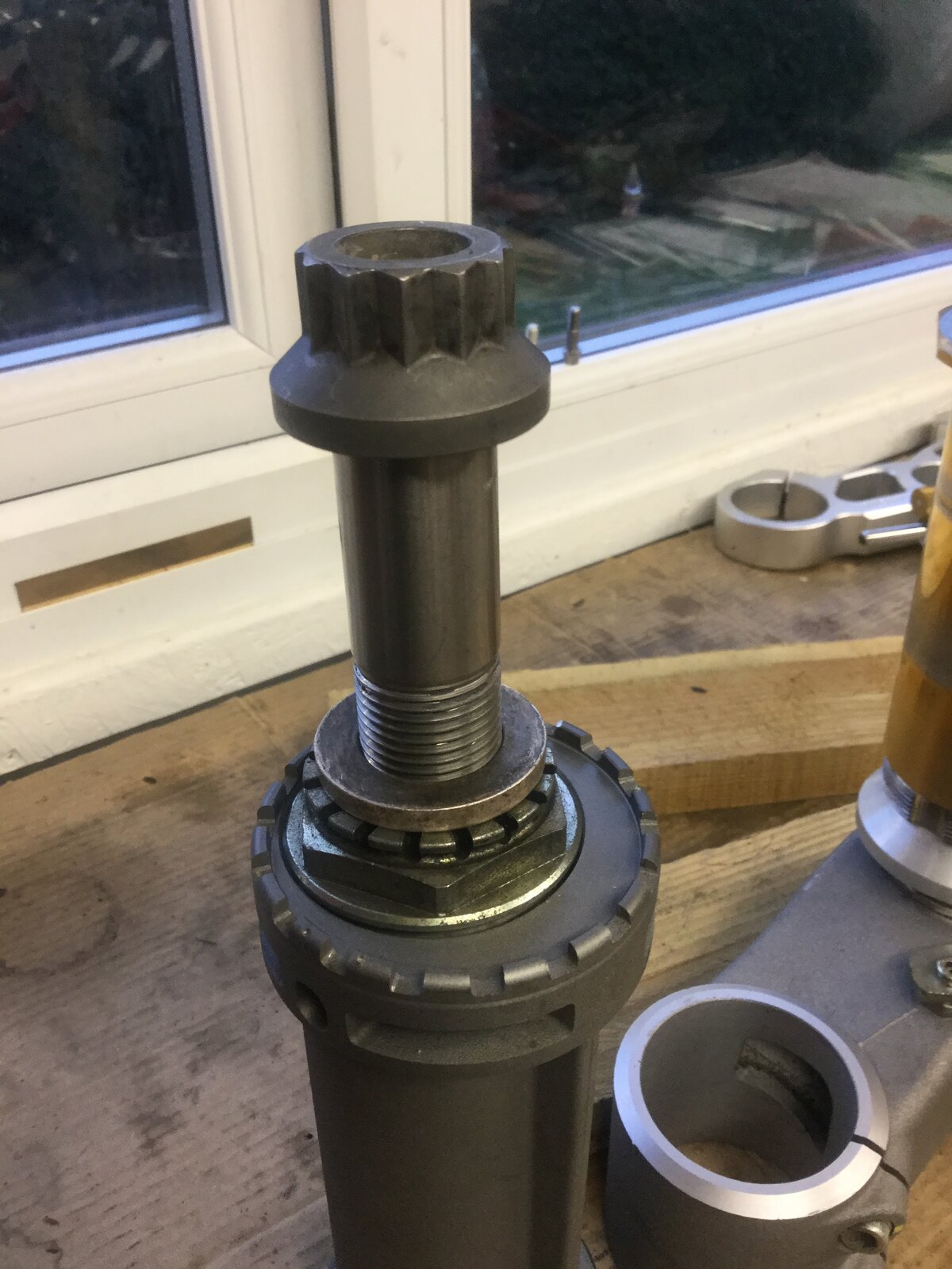

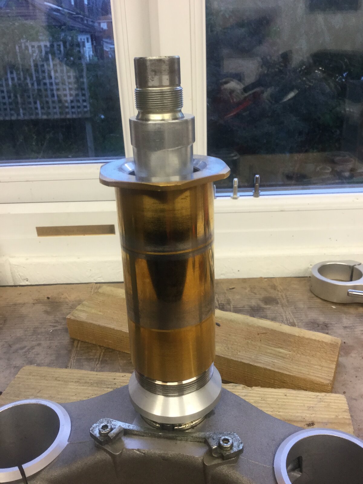

  6. Steering head bearing cup insert tool made from Airbus engine attachment bolt and 916 rear wheel nut.
    Steering stem lower race insertion tool made from 916 rear wheel conical washer and $25000 Airbus engine pylon attachment pin..

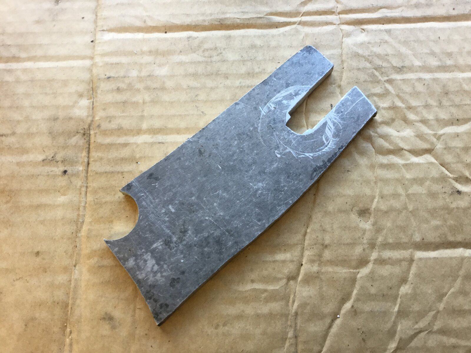

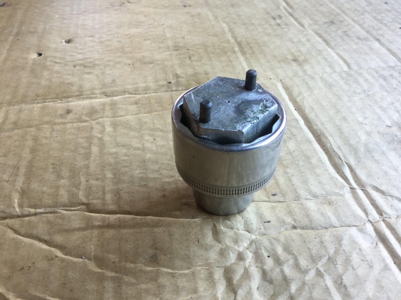

  12. Showa fork damping rod nut retainer

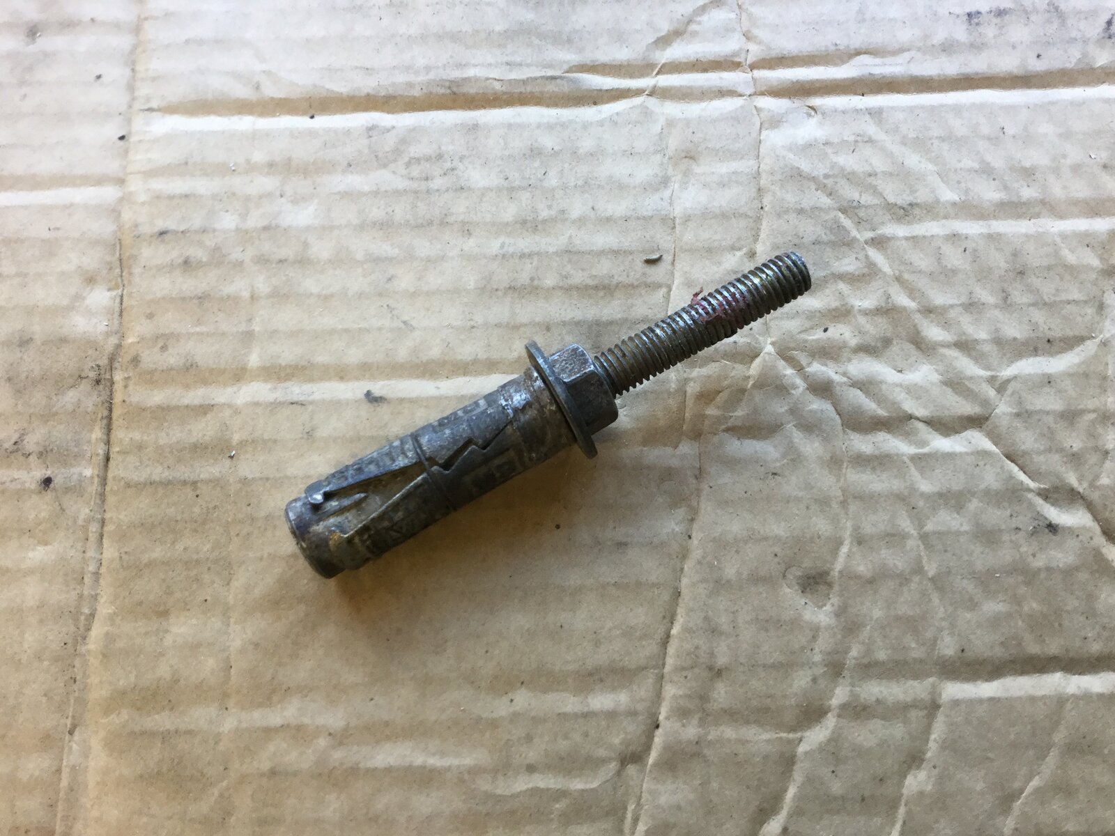

  13. Raw bolt for removing wheel bearings (1984 vintage):

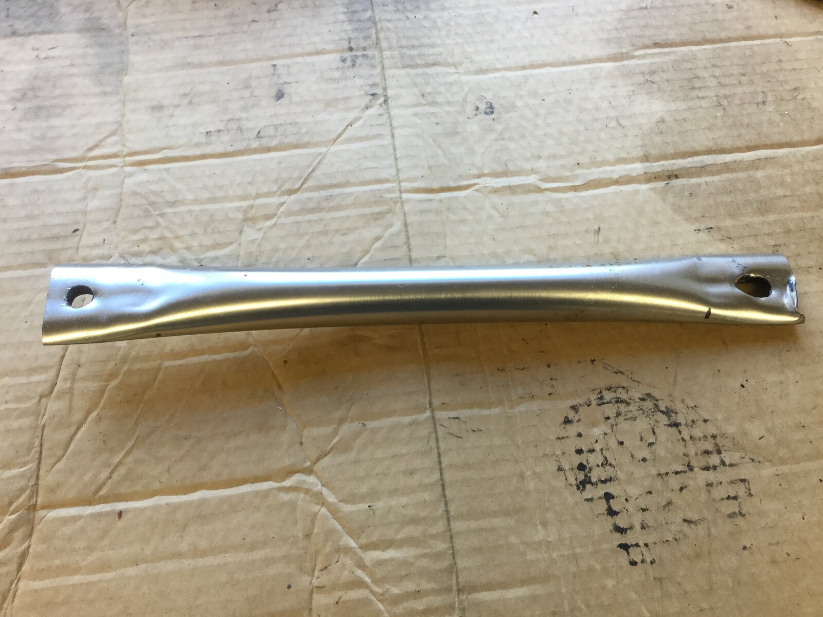

  14. Had to take my 749 to garage but my shock was away for service so I made this to bolt in its place so I could trailer the bike.

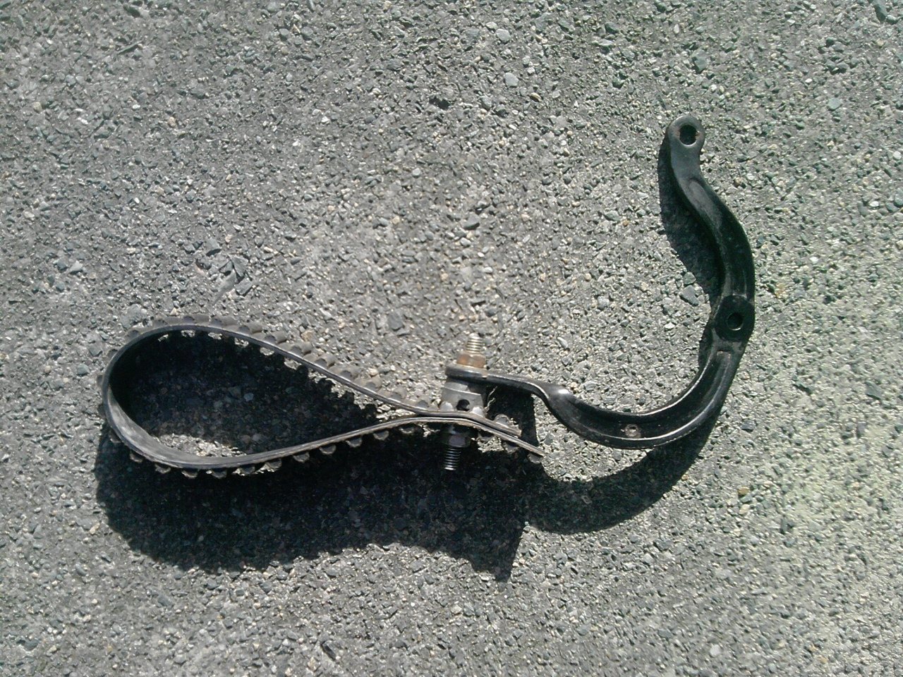

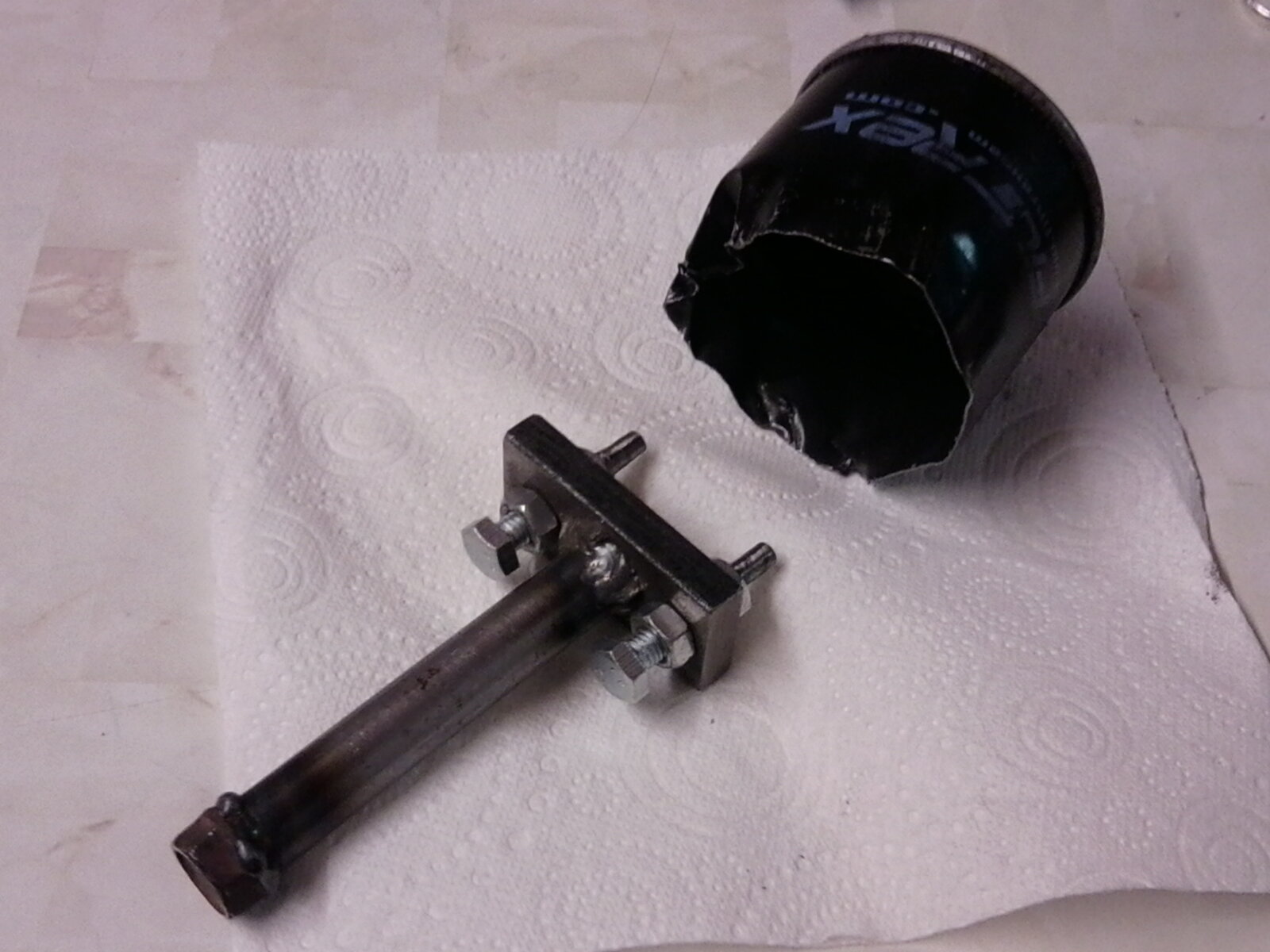

  15. This was my best effort at dealing with those stubborn filters ...
    Note the exotic parts used -
    some pushbike bits
    a piece of timing belt ( dunno what vehicle that might have come from ! )
    NB - no aircraft were harmed in the making of this tool ..... :D
  16. Did it work? Asking for a friend. ;)
  17. It works on anything ..... so long as it's not too slippery to get a firm grip on
    :p:p
  18. Edited for you
  19. Wow , that filter cartridge has suffered some vicious punishment ...
    .... thrashed like a cheap dog I'd say !
    Is that pic before or after using The Tool on it ?
    .... just kidding .... you clearly got the bugger out ..... :)
