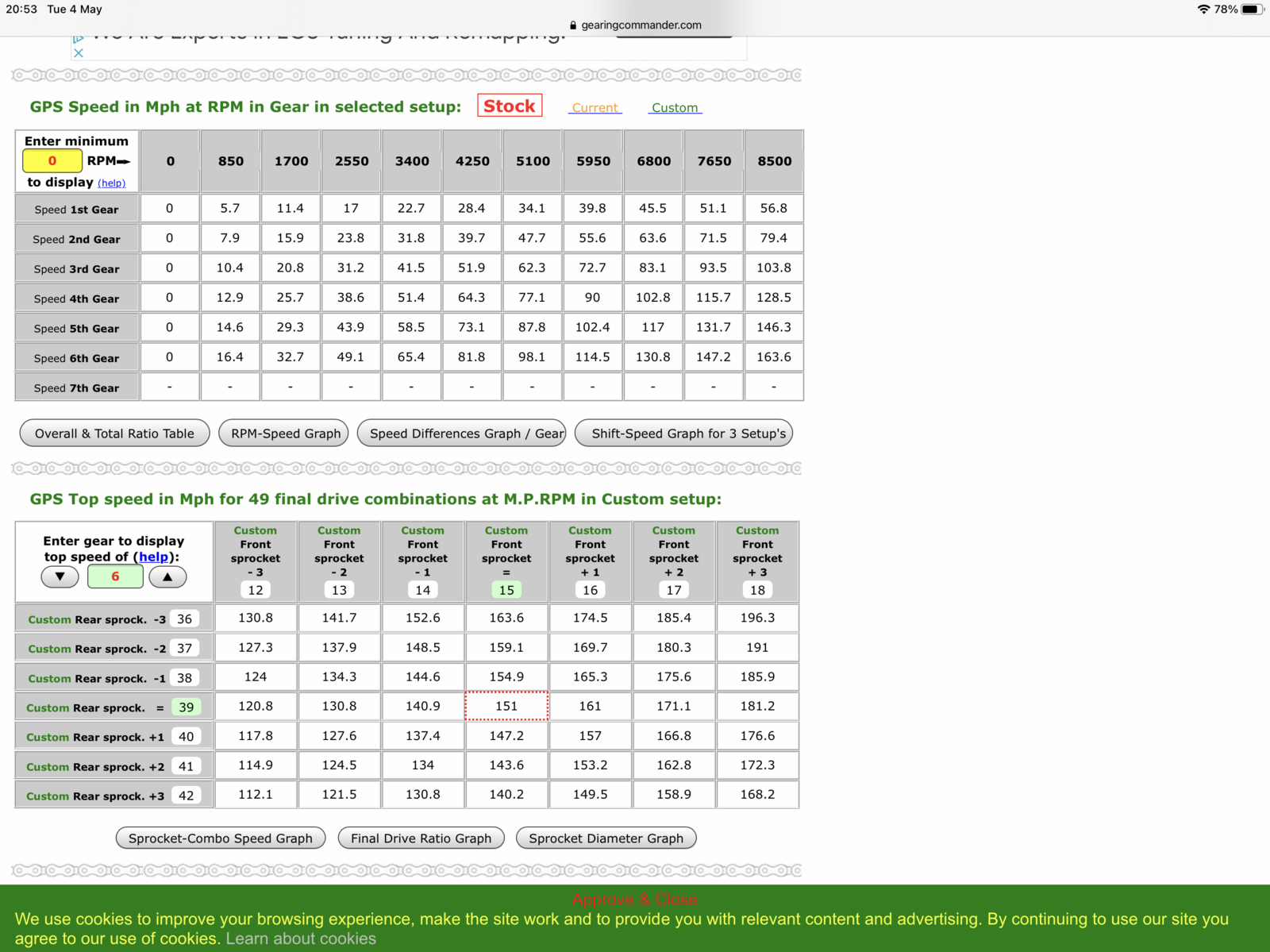

  17. A question. Was it showing 150 when it was on the redline or was it not able to get to the redline?
    How many teeth are you running on the sprockets?
    My 996 that had sps cams in would indicate 165mph on our local stretch of autobahn.
  18. Pretty sure that 'stock gearing' would see 180 - 190mph if the bike could actually hit the redline in 6th gear but they don't have enough power for that, which is why many of us change the gearing for better acceleration (and low speed use) whilst not sacrificing any top end.
  19. Thank you !
