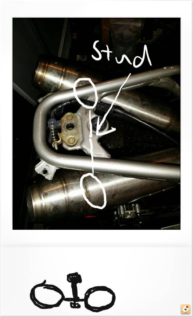

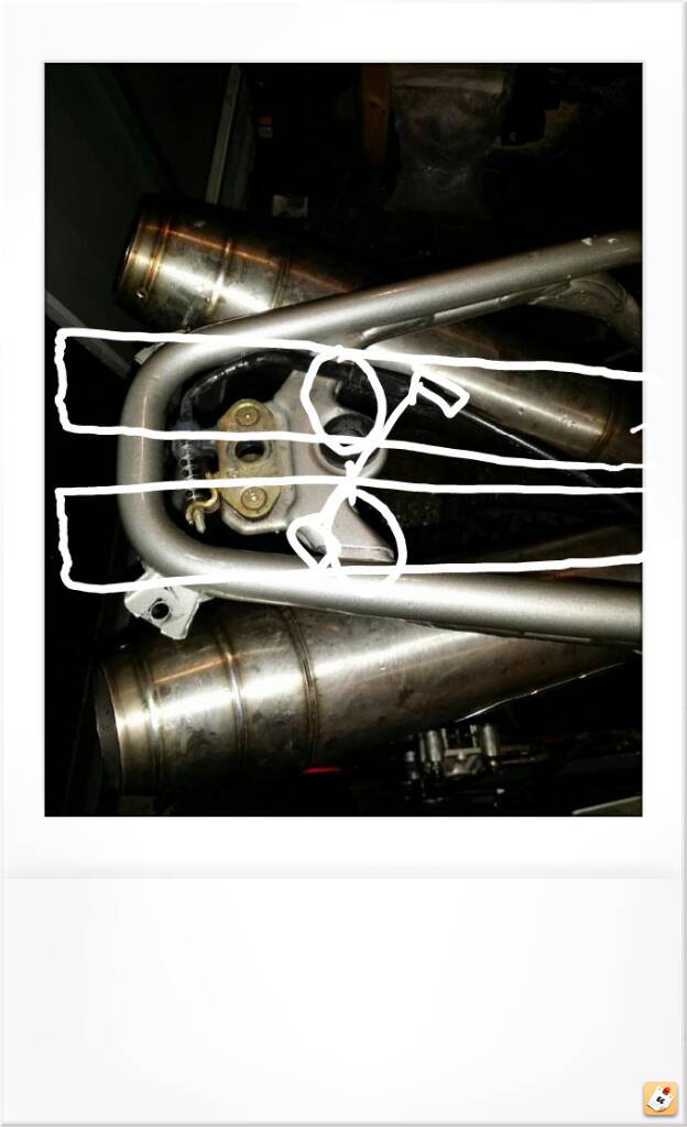

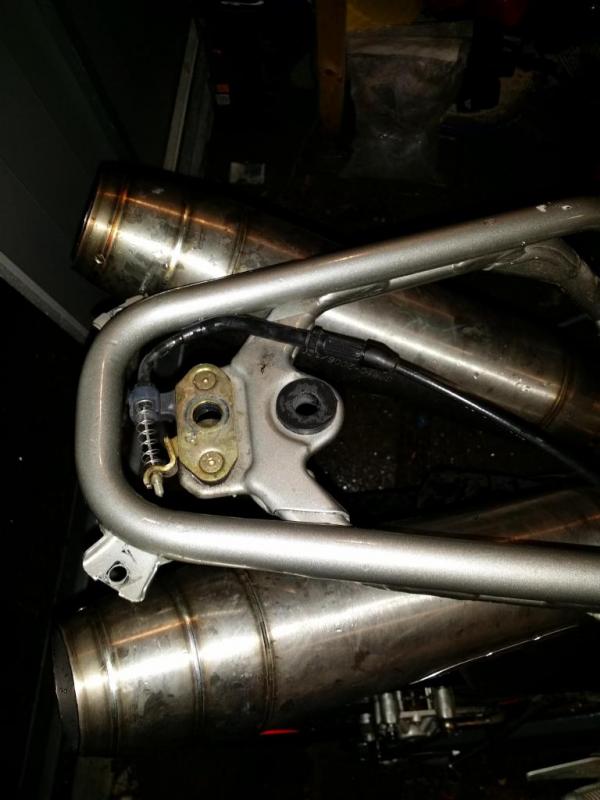

  7. there is no way of getting these exhausts on... are these designed for a monoposto? because look at the pics.... its not gonna fit in properly. its really really pissing me off.
    someone please help, im about to go crazy :frown:
  8. you need to slide the brackets and rubber sleeves over the exhausts in the orientation in which you received them.
    where that black rubber bung is on the subframe the stud should go through there and then put the black spacers in to pack the space so they sit right.
    then aling the clamps and push the stud through the centre and tighten.

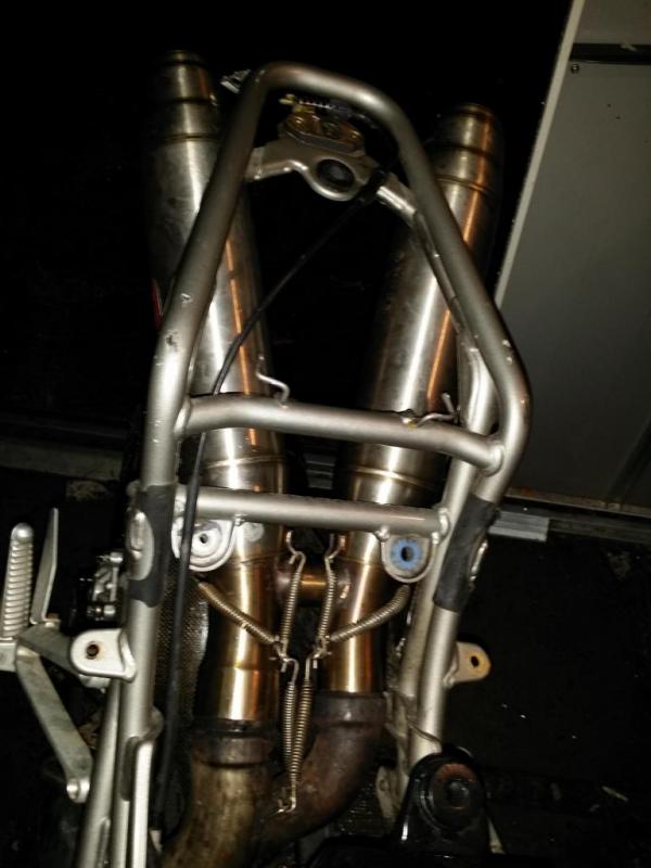

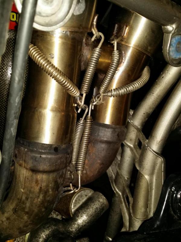

  9. okay, but if i do that. the link pipe at the downpipe side looks like its about to come off like in picture 2? is that normal?
    also do i still need to put on the heat shield?
    cheers.
  10. the clamps will pull the cans in alignment once fitted with the stud securing them.

    it looks like it could do with a good push on but it will not come off.
    one fact to remember is that the mono and biposto use the same stock exhaust systems with the same mounting points so there is no difference there...
    although the subframes themselves are slightly different where that black bung is identical where the stud goes
