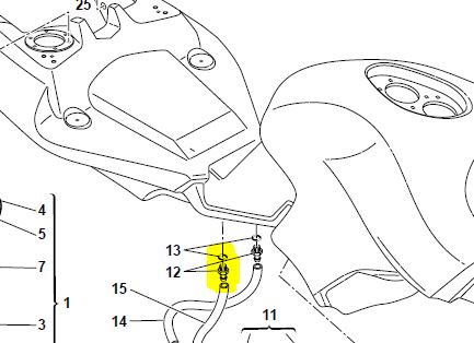

  8. Hi and thank you for your input,
    Yes, I have also been refueling the slowest possible, but it never helped to solve it. Anyway, as I have taken the tank down, I found out one of the vents/breathers under the seat is blocked (as shown on the picture). I tried to unscrew it but it snapped (badly corroded), leaving the thread inside. So I am getting new one and in the meantime take the remains out. I understand these breathers/vents are connected to tubes inside of the tank, is that correct? Anyway, as the tank wasn’t able to breath properly, I take it that was the cause of the problem with full refill…I hope.
