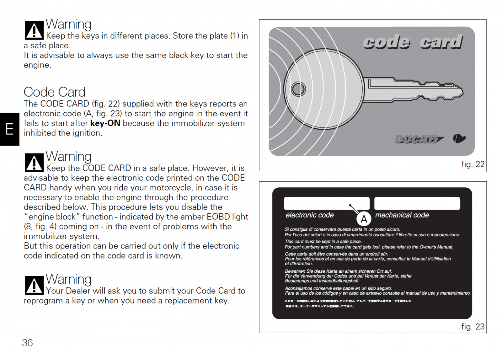

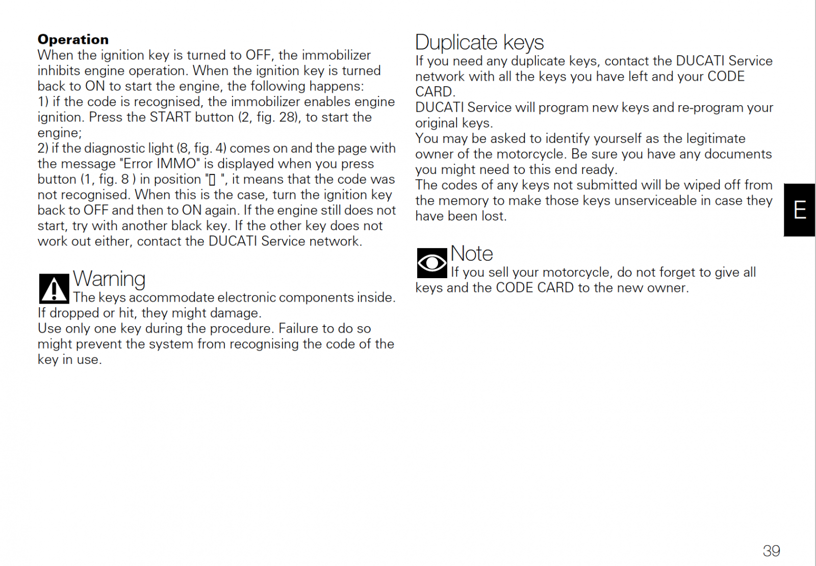

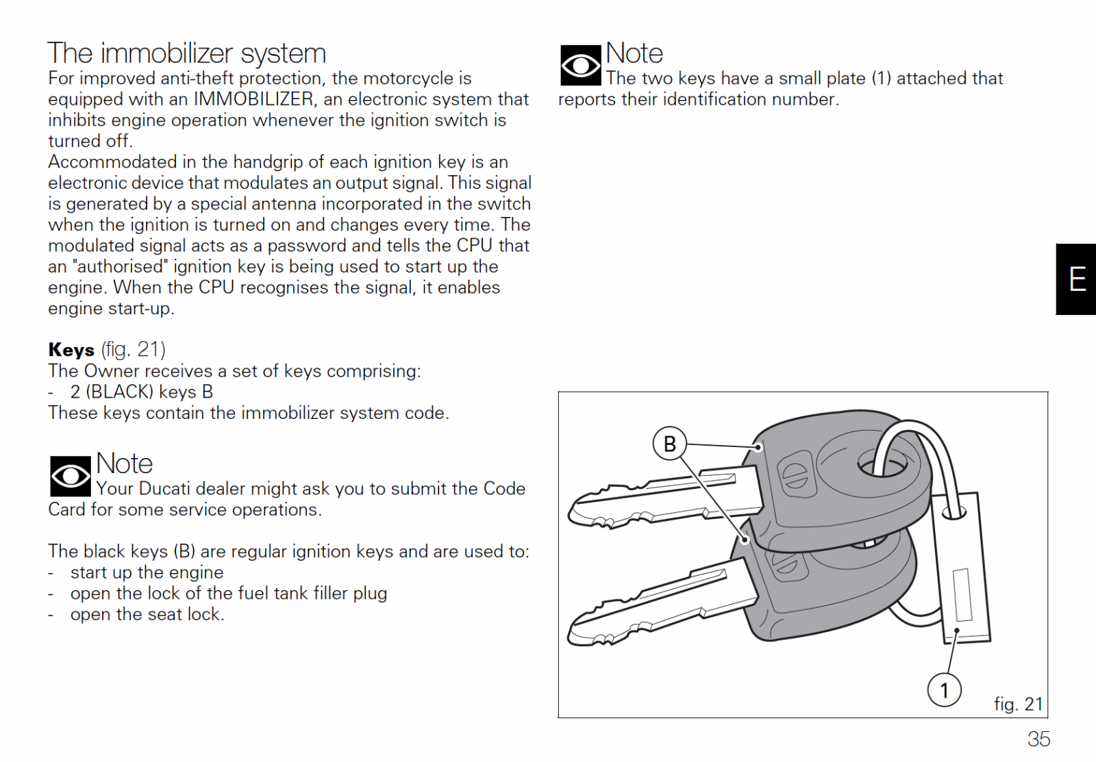

  13. Screen Shot 2016-05-07 at 20.09.40.png Screen Shot 2016-05-07 at 20.09.31.png Screen Shot 2016-05-07 at 20.10.07.png

  14. Hmm - yep - that's my set up (2 blacks and a code card) but I seem to remember a couple of years ago with my old evo (61 plate) I seem to remember having an immobilizer problem and reprogramming a key in the garage - from memory I was putting one key in doing something and then putting the other in....
