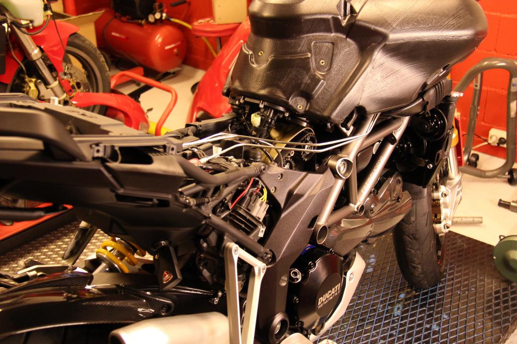

  5. During winter, I also changed the last carbon camcover. Installed the other ones long time ago. Managed to do it with out removing the tank, but removed all fairing covers and loosened the brake lines. Still, it was quite PITA to get it on, trying not to scratch the nice carbon finish!
    Here is a picture when I did it:
