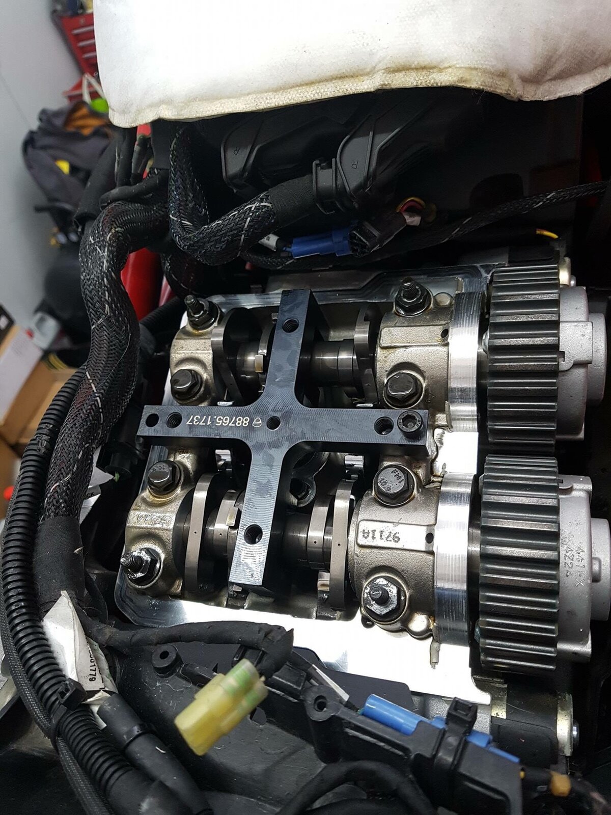

  2. I have seen this tool. I thought it was to hold the camshafts in position when the belts are being removed.
    You are saying this will secure the camshaft so the pulleys can be removed?
  3. The honest answer is that I don't know but it looks like the only factory tool that comes close to properly locking the camshafts out. How well it does that job is debatable looking at the way it's retained.

  5. Yes, I have read through the manual several times and cannot find a simple explanation. I have managed to get it off by and old cam belt and ratchet method.
