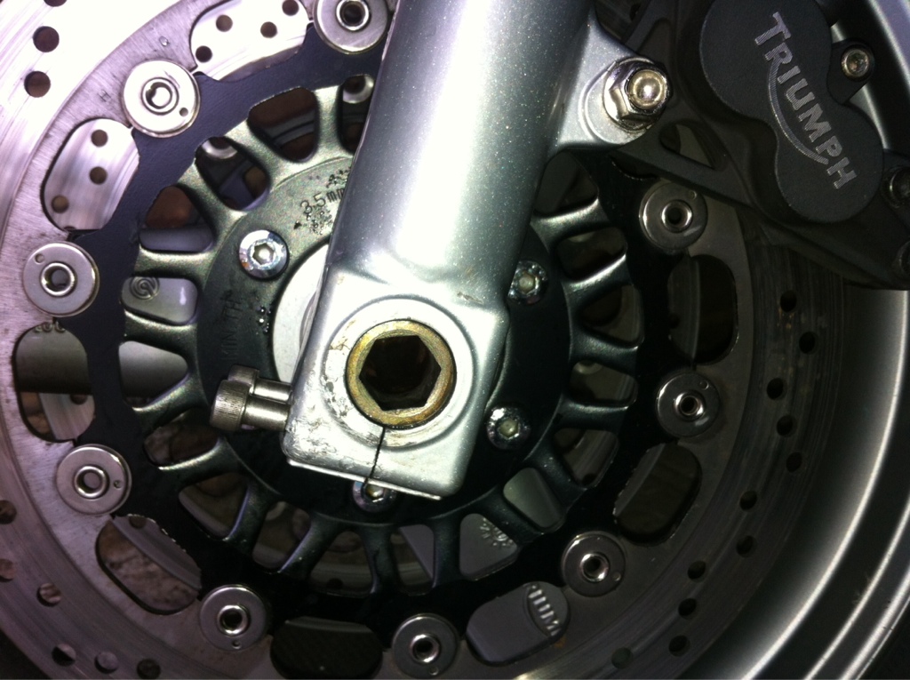

  1. As title. I need to remove the front wheel as I have a puncture.
    Tried using the 'made of cheese' box spanner supplied in the underseat tool kit , that was a joke as I twisted the end into a spiral, so just bought a 1/2" drive -19mm inhex socket thinking that will do the job.
    I tried with an 18" wrench bar but it ain't having it. I presume it's a conventional right hand thread?
    I have removed the 2x 6mm socket capped pinch bolts from the lower fork, there are none on the other side! What's stopping it from undoing, am I missing the bleeding obvious here.
    Any feedback appreciated.
  2. Picture might help john
  3. You are right Peter, pictures to follow tomorrow unless I hear some wisdom from someone who knows what I'm doing wrong.
    But whilst you are waiting with baited breath, visualise the wheel spindle in my Trumpet, it has a 19mm internal hex in the center of the spindle. The O.D of the spindle sits in the bore of the lower fork. The lower fork is split at the bottom half and 2 x 6mm bolts pinch the split lower to clamp the spindle.
    On the other fork leg there are no clamping bolts , the bottom of the fork is threaded to receive the spindle, there is no nut on the threaded end of the spindle.

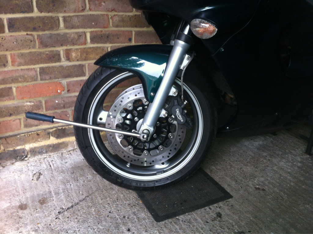

    It certainly feels like it is stuck, and I am acutely aware that the amount of force I was using with my 18" wrench bar ( anti clockwise) should have been sufficient to undo it normally. I have squirted some gt45 stuff in there a few days ago, although how much is in there is unknown. I did think of heat but the fork legs are painted so I'm reluctant to use anything. I suppose I could try some boiling water?
    I suppose that the alloy/steel interface has 'welded' it together- ffs!
  7. One relevant point. when I am attempting to undo the spindle some of the torque I am generating is being absorbed by the soft tyre!
  8. Had another go today , this time with a small block of wood between the bottom of the fork leg and the ground to eliminate the spongy ness of the tyre.
    Standing on the end of the 18" wrench bar and pulsing up and down with my full body weight- no success !
    I also warmed the area by wrapping a cloth around the fork bottom and drenching with scalding hot water.
    I think the next step is a rattle gun.

  12. Fig I have been jumping up and down on the breaker bar, I'm no novice undoing tight fixings. I'm proceeding with caution as I don't want to crack the fork leg.
