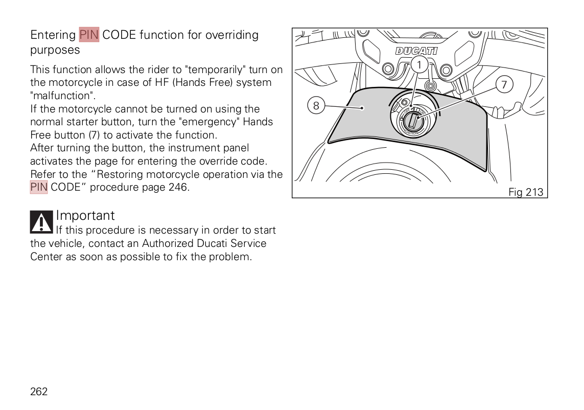

  3. Thank you, I had a look at the manual and the bit I am missing is how to switch the dash on without the key so that I can input the PIN.
  4. You switch the dash on the same way as with the FOB. Center switch.
  5. Thank you. I mean - do I need to remove the centre panel and push the button to input the pin?
  6. Yes and turn the switch counter-clockwise. Pin number request will show-up.
    Screenshot from 2019-06-26 09:55:54.png Screenshot from 2019-06-26 09:56:40.png

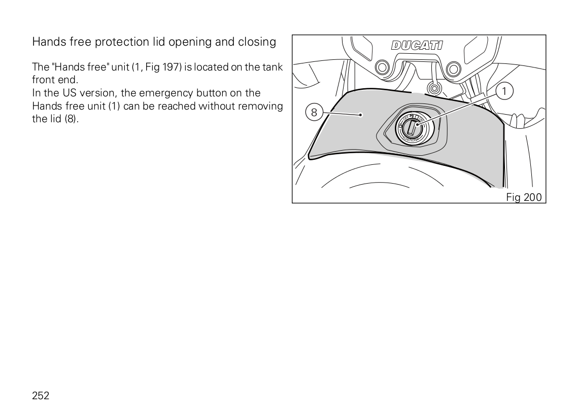

  7. I believe, the switch on the pictures exists on North American models only
  8. Just pop the cover off. it's designed to be removable and held in place with two rubber grommets.
    #8 DarR, Jun 26, 2019
  9. Yes, Euro bike is just a push button under the cover.
  10. The switch on the North-American model is designed to be readily accessible because we often lose our keys here.
