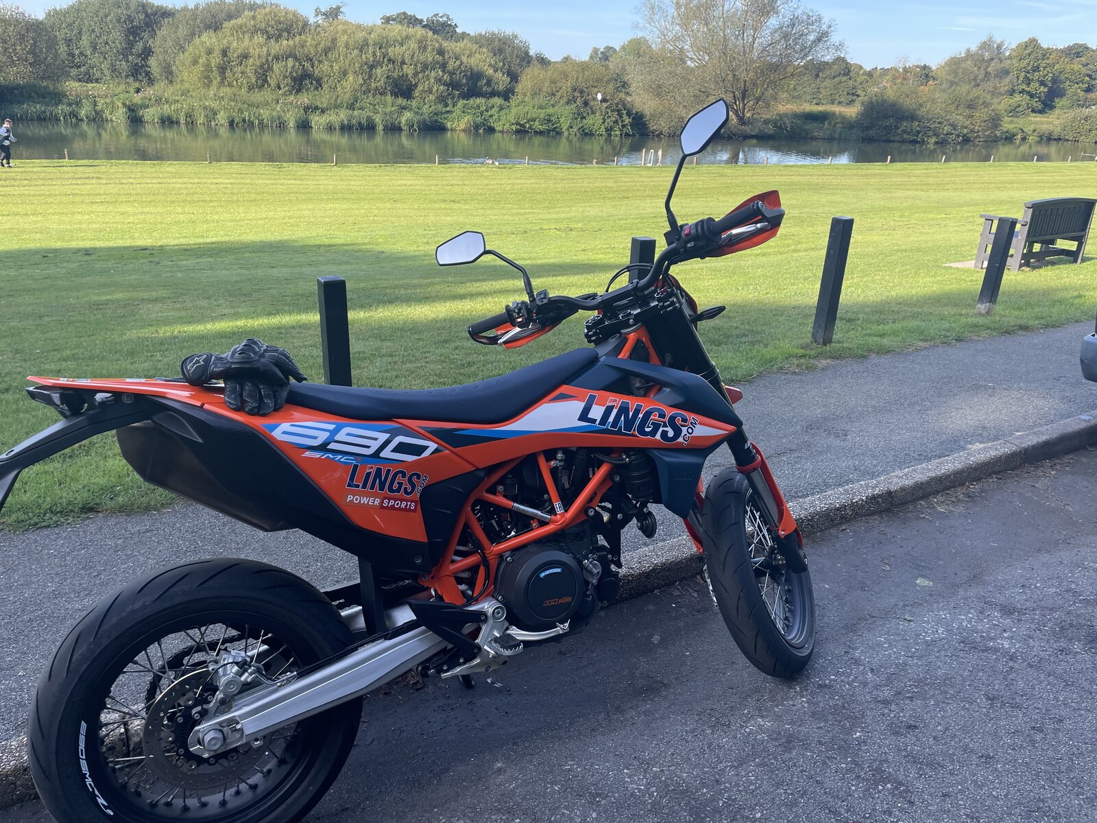

It’s a heavy bike for anything hardcore off road IME, dependent on your off road riding ability. I didn’t ever like being that close to 70mph on knobblies at off road pressures. There are a few FB pages that cover all the LC4 engined models. Mines a Euro 5 but as I don’t frequent towns that often the low end troubles owners have haven’t been an issue for me. I bought my GG SM cash outright from ET James (Rhyader) as an ex demo for 7k all in it had 120 Miles on the clock. I’ve put 2700 miles on it mostly B roads and unclassified roads in Mid Wales. Haven’t had an issue with it at all, other than I haven’t time to ride it enough. Hand guards should come as standard, they were on my SM. If you’re off on adventures further afield you may consider a Rally screen to better protect you on the higher speed road sections. I bought the Vanasche filler cap as the standard one is prone to snapping keys if not regularly lubed and I was paranoid about dropping it and key snapping also. You can buy the cheaper copies from China but IME the finish fades quickly. The swingarm finish is questionable ie it quickly looks crap.

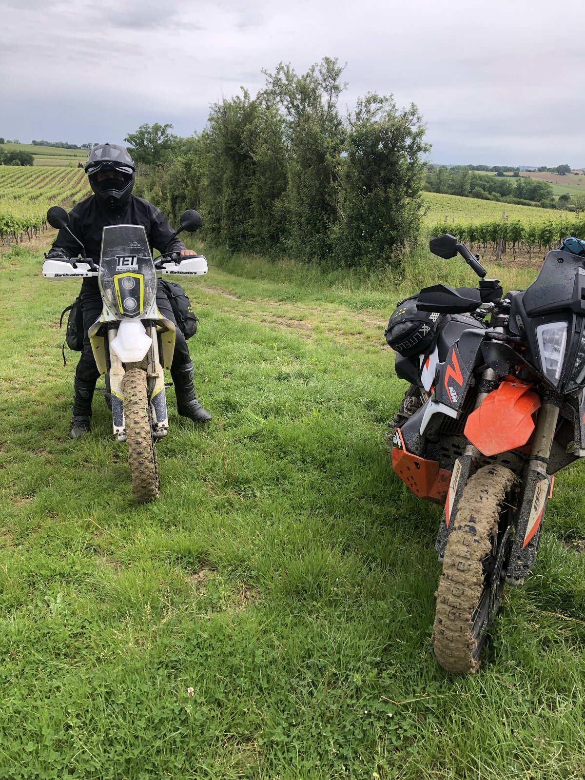

Had mine for 3 yrs and put on 15000 miles. Only problem was the usual leaking front sprocket drive shaft, needs the o ring changing. Put on tower, bash plate etc and used it for the TET around Yorkshire, Wales, France and Spain. Ended up buying an 890 as had that itch and whilst it’s a great bike at times I wish I was still on the 701. Couldn’t keep both as very similiar. Fantastic bike for travelling on especially if doing any solo stuff as just gives more confidence. 890 as capable but can’t get away from the extra weight which is always on the back of your mind. Ended up getting a 390 Beta to cover all bases.
