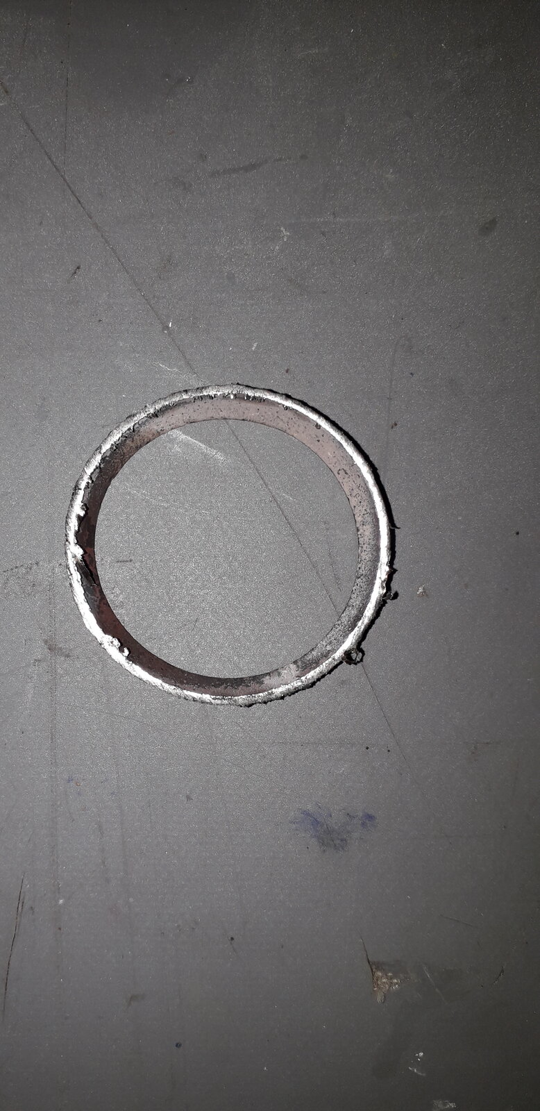

  1. Took the ststem off for a thorough clean & noticed the ends ot the headers that push into the next piece have rolled ends to ease assembly, but these ends reduce/restrict the inside pipe diameter from 37.5 to 32mm. My OCD would not allow me to reassemble like this. Sawn off now.
    Probly make no difference but hey...
  2. Pics! - i need pics!!

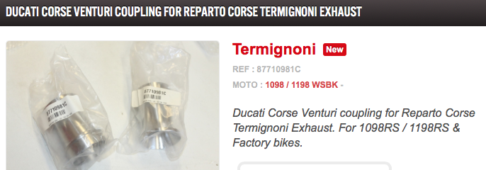

  5. you sure that rolled edge wasn't acting as a venturi in the exhaust?
  6. I hadn't considered that! is that a common feature of exhaust design?
  7. if its good enough for an RS...

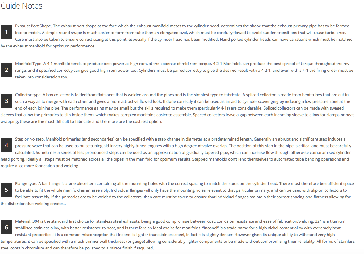

  8. A rolled lip like that will have no positive effect on gas flow unless the ID of the pipe it flows into is very similar.... I’d have still cut it off.
  10. Yeah... I’d cut it off.
