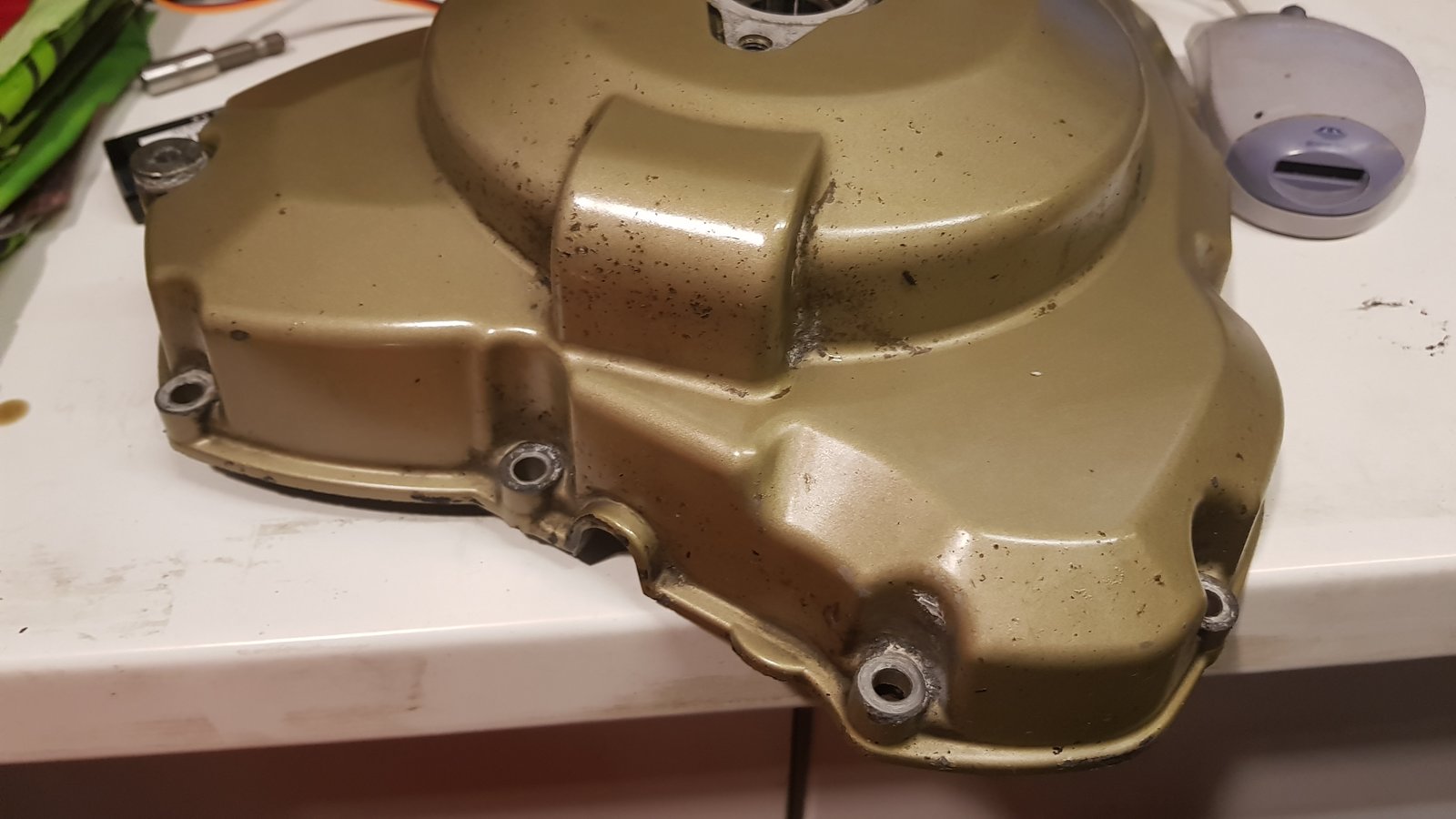

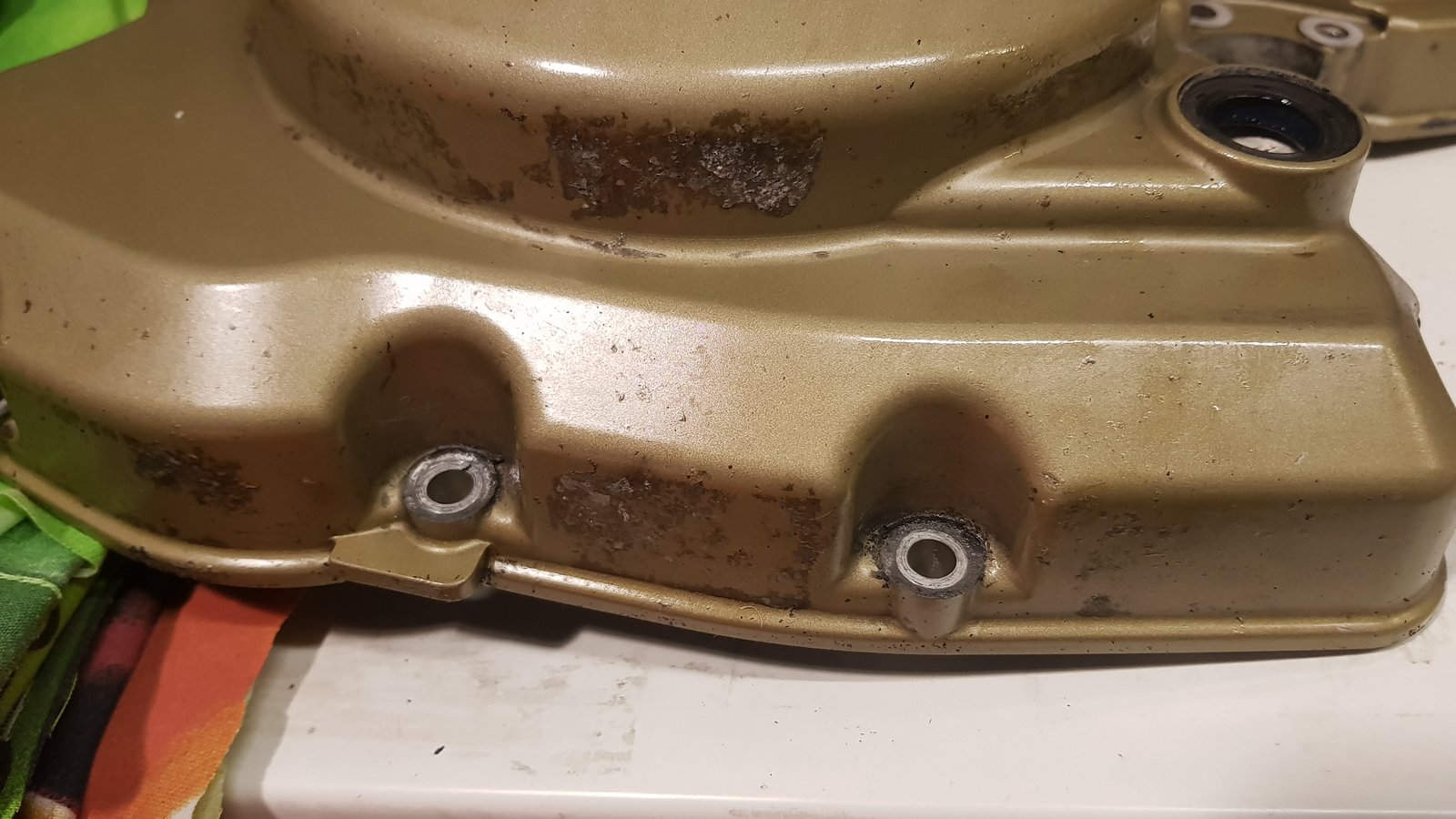

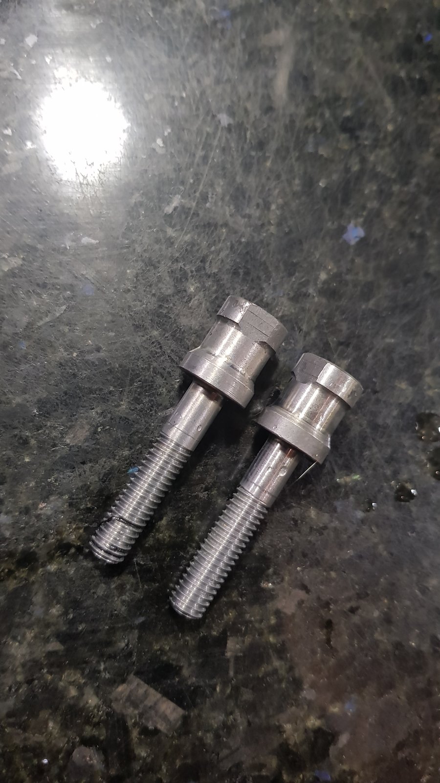

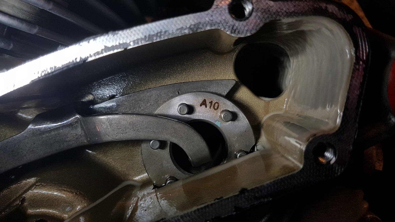

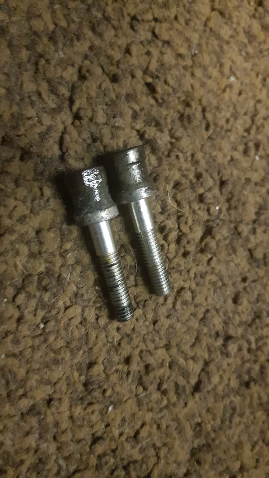

  17. Continuing the research this evening I've taken the alternator L/h engine cover off. As I'm in my phone posting I can't remember if I said but I spoke to rich at louigi and he said that he always puts 15w 50 in. I've got 10w 40 in mine and I'd say that I always feel that it's better when it's cold...so I've drained the oil and while it's got no oil I'm gonna get both sides recoated....cover not in brilliant condition...
    However I've had the chance to use some really strong acid I've had for years to clean a couple of rusty bolts on there....
    This is the marker inside...I'm presuming this is correct?

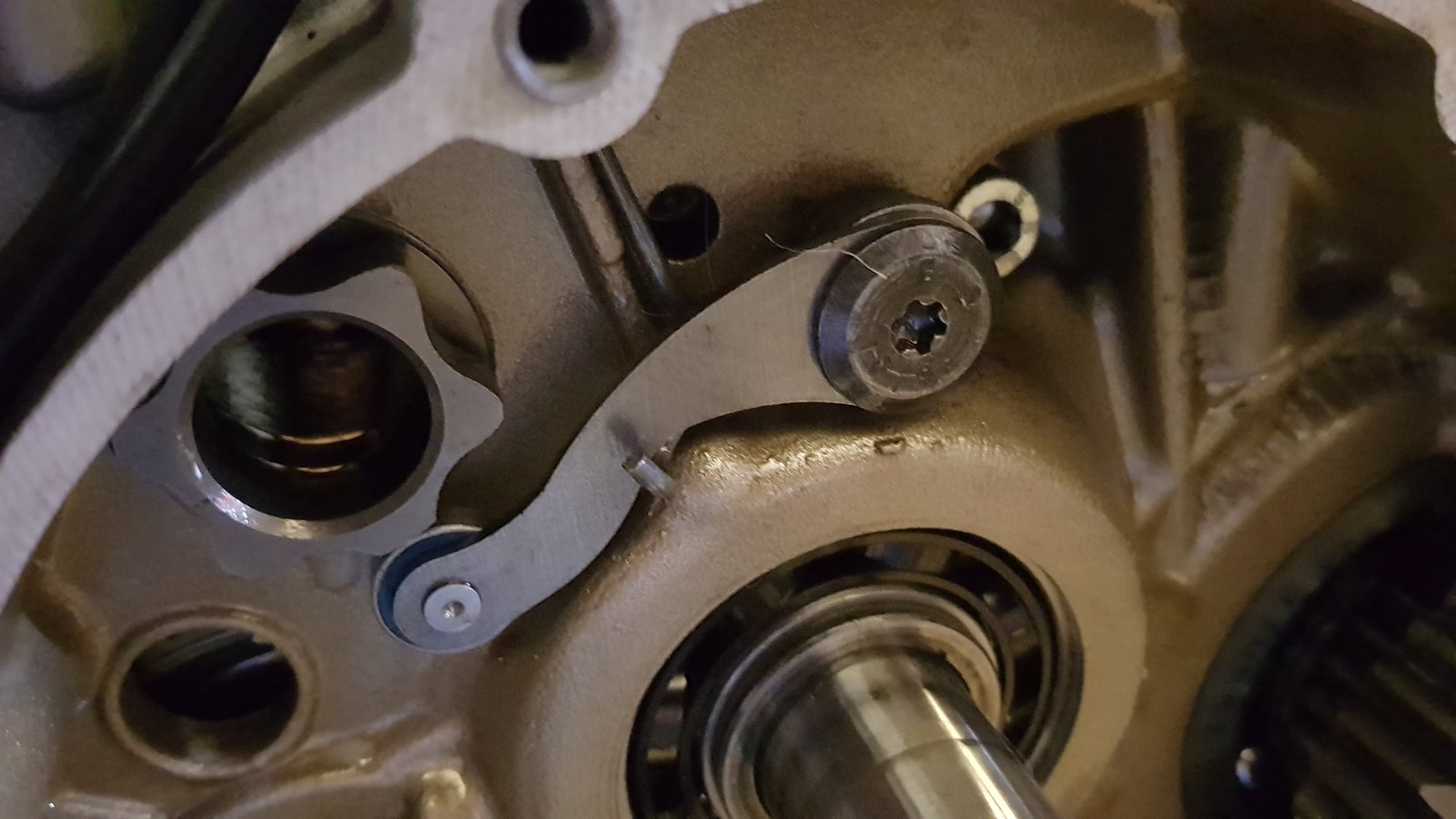

  18. Dropped the engine casing off to the Mr cerakote today...if it's all good I'll put his name up...from the brief chat seems like he knows his stuff...any...back on topic. Problem solved. The gear arm wasn't returning. I'd removed it to check and there's a washer what sits between the bolt and the spring...it found it's way inbetween the spring...so, removed, reinvested and double checked...all good...this culprit...
    You can just see the edge of the washer...
