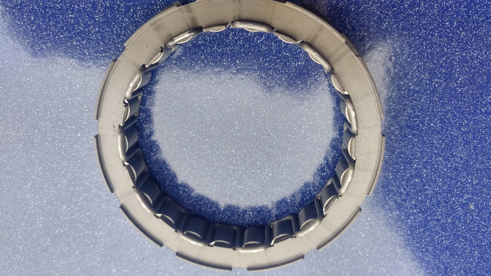

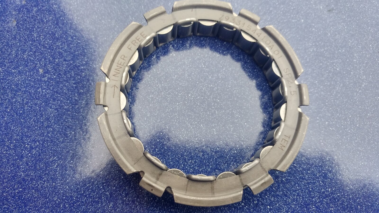

  9. I've got a few one way clutches taken from new Panigale engines, the same part that is used in almost all Ducati's and it's the latest version for less than half the price of new
  10. So that's oem or aftermarket?
  11. It’s OEM, if you order one from Ducati and pay £146 you will get one just like that.
  12. Yeah... That's about the price riders gave me... Anyone got a spare oem one for sale? And any other oem parts for that matter...?
  13. That one is for sale, and I should also have the outer ring to match, I don’t have a driven gear (the only other part you need).
  14. How much do you want for that one?
  15. The one way clutch on it’s own is £75 delivered.
    I don’t have the outer flange or the driven gear.
  16. And that's a brand new oem on (just making sure!)
  17. See post #11
