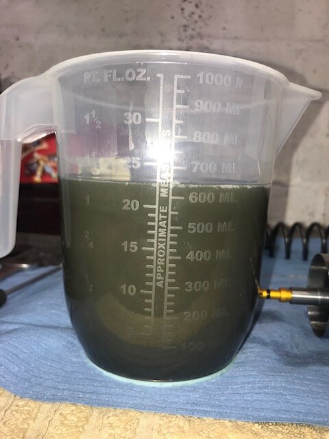

  7. going by some of the other issues like too much engine oil... i think the forks may have been topped up with oil or the wrong oil ..so next on the list is to clean out and renew correct 7.5 fork oil to the correct air gap..see if that sorts it. As i strip it i can obviously see whats in it..

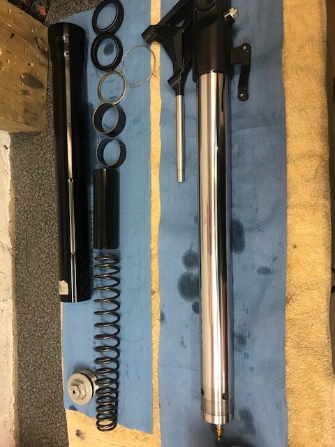

  11. did you bottom this out? turns or flats as ive just stripped mine and i dont even think there are 10 turns of pre load...
  12. Err - not sure - not had the chance to look yet (other halfs birthday today, picked up a kitten for the daughter) and have to (try) to get out later to pick up some cerakoted bits for my z1ooo....
  13. forks stripped down will do new seals..
  14. and how much oil in there.....

  17. Loads of contradicting info out there one from the handbook, one from a electronic handbook.. one says forks 710cc the other 690cc albeit with a much better measurable 110 air gap although im thinking that is too small based on what other marzocchi fork owners have suggested..
