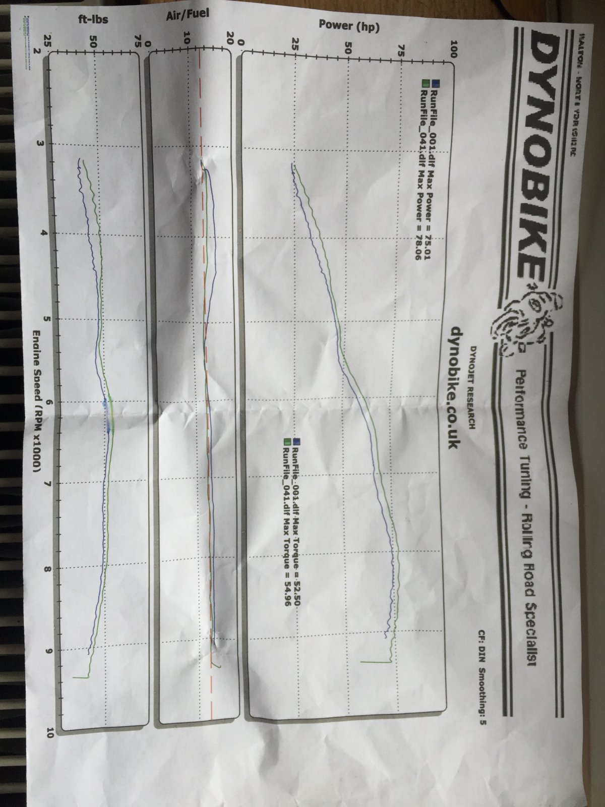

    Anyway I received the results on my Dyno print out.
    After a month of riding the bike is much smoother not as many pops and bangs acceleration feels better and torque feels much better also.

  2. That's the law....if you get it dyno'd the results have to go up....
  3. Haha true comfysofa, I have the results at home I will post up a copy tonight at some point :)
  4. Sorry for the delay guys been a busy couple of weeks here is my Dyno print out.
    Cheers
  5. No jpg? Did he refresh the ecu or did you use a power commander?
  6. JPG? You have lost me?
    It was an ECU remap no power commander.
  7. Heh - usually jpg as in "you took a pic of a sheet of paper...." which I confess I did take a pic of the screen one my first on but then got a jpg email to me on the second...

  8. Aww I get you lol
    All I got was that sheet printed out along with my invoice.
    Don't seem to remember him offering me an email either. A JPEG copy would be helpful as this one is a little creased and crinkled already! :eek:
  9. If he's like Chris he'll keep the jpg along with the ecu serial numbers. I guess its form QA so he knows what he's flashed to what...
  10. I may contact him and ask for a copy then buddy thanks :)

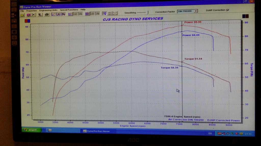

  14. Just to clarify heres a quick example....this is my 1100 from stock to a custom mapping at CJS - all ive got on there is an end can, drilled airbox and K&N....notice the second gear torque increase...
    And that's just the start of the fun...
